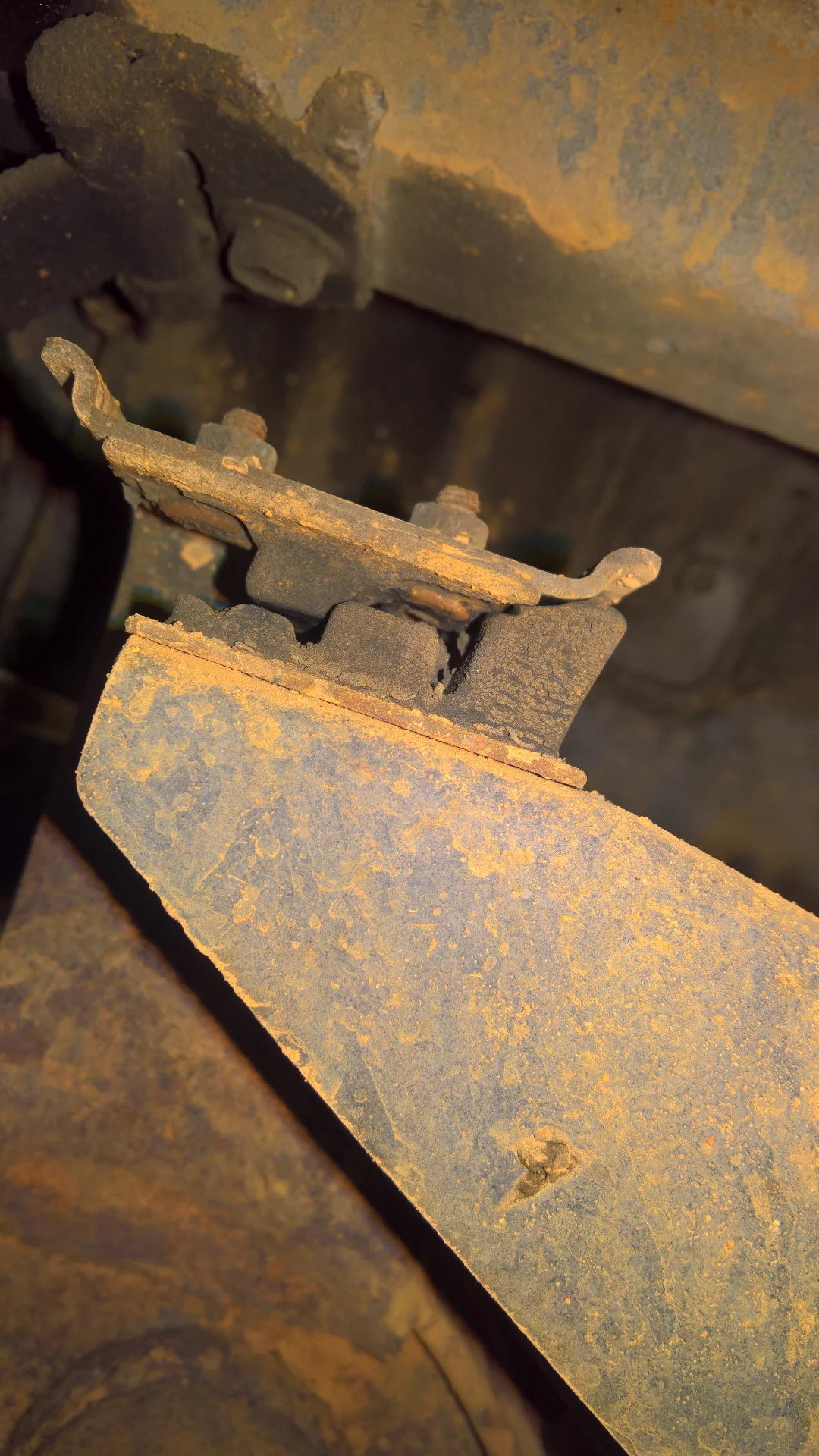

Have you checked the exhaust system looking for failed hangers allowing it to hit the frame?
^^^Definitely ^^^. On a cold engine/exhaust system get down on your back and push UP on the pipes, the hangers on every 80, if still the originals,
are long gone (broken) by now. There's a rubber block that splits in the middle, replacement is relatively simple.
