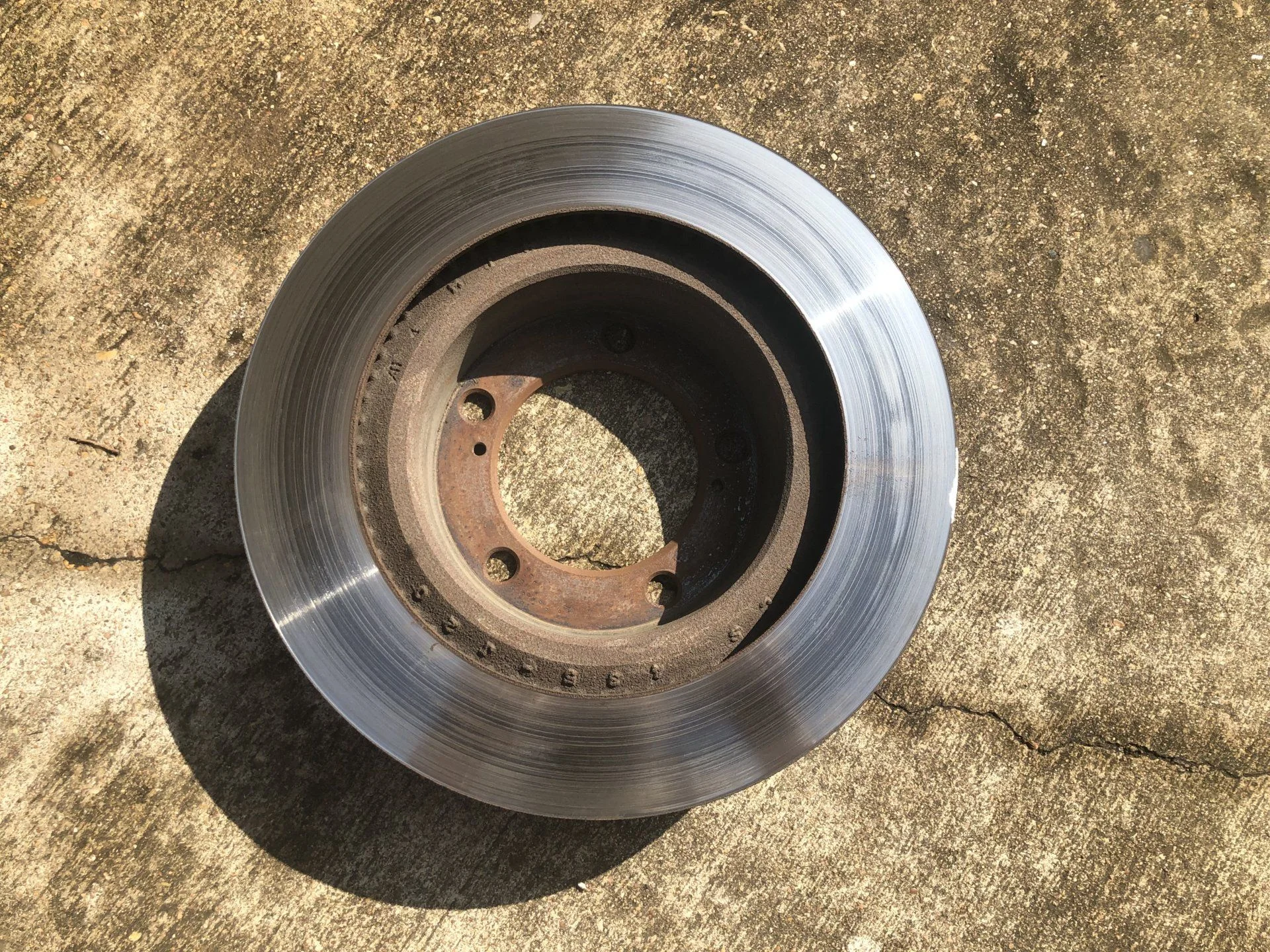

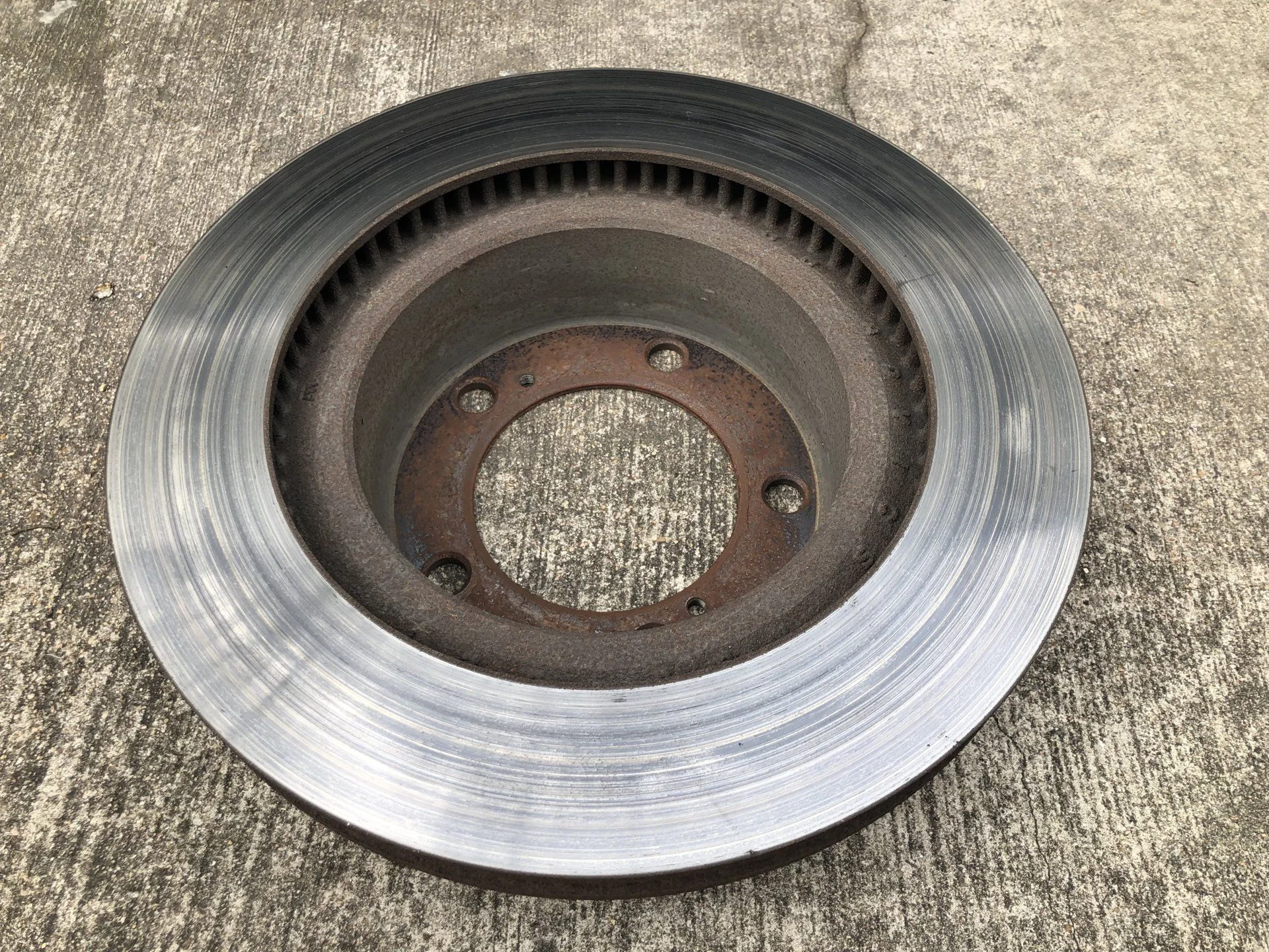

The rotors are typically ductile iron or grey iron. To me it looks like the material is not fully homogenized (not exactly the same all over with regard to alloying elements). In other words the area of a different color may have just a bit more or a bit less of Carbon or Graphite, etc. This can occur in castings and the difference can be very subtle. The heat of braking has etched the material which brings out this subtle difference in the elements. At least that what it looks like to me.
Mine look the same. Original pads and rotors at 66k.

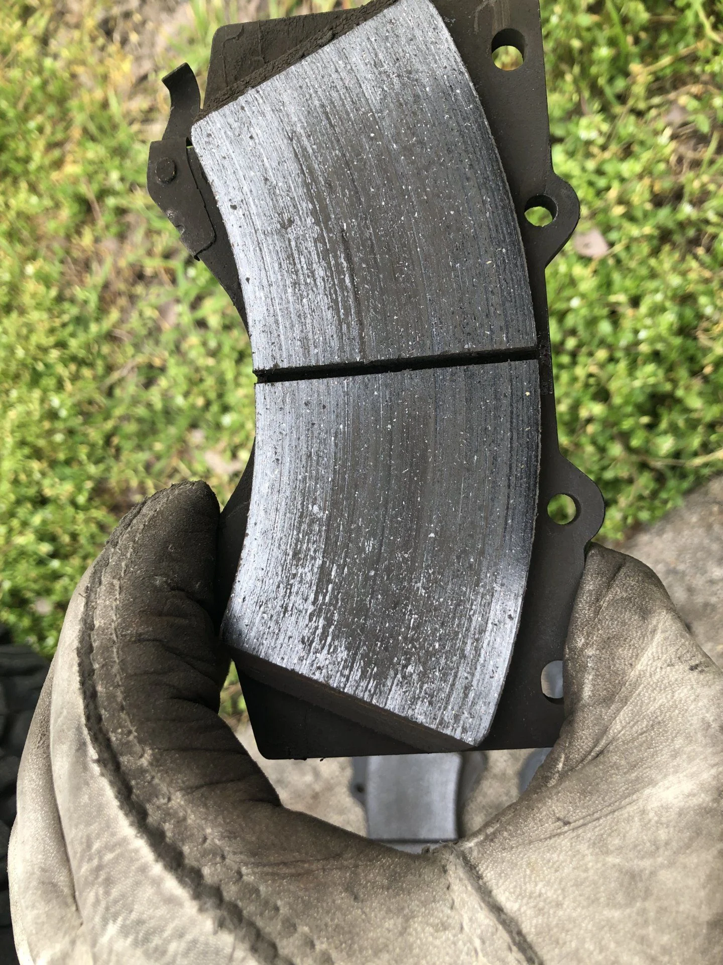

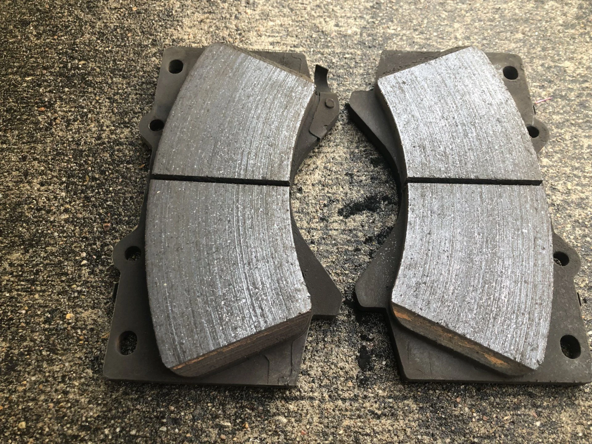

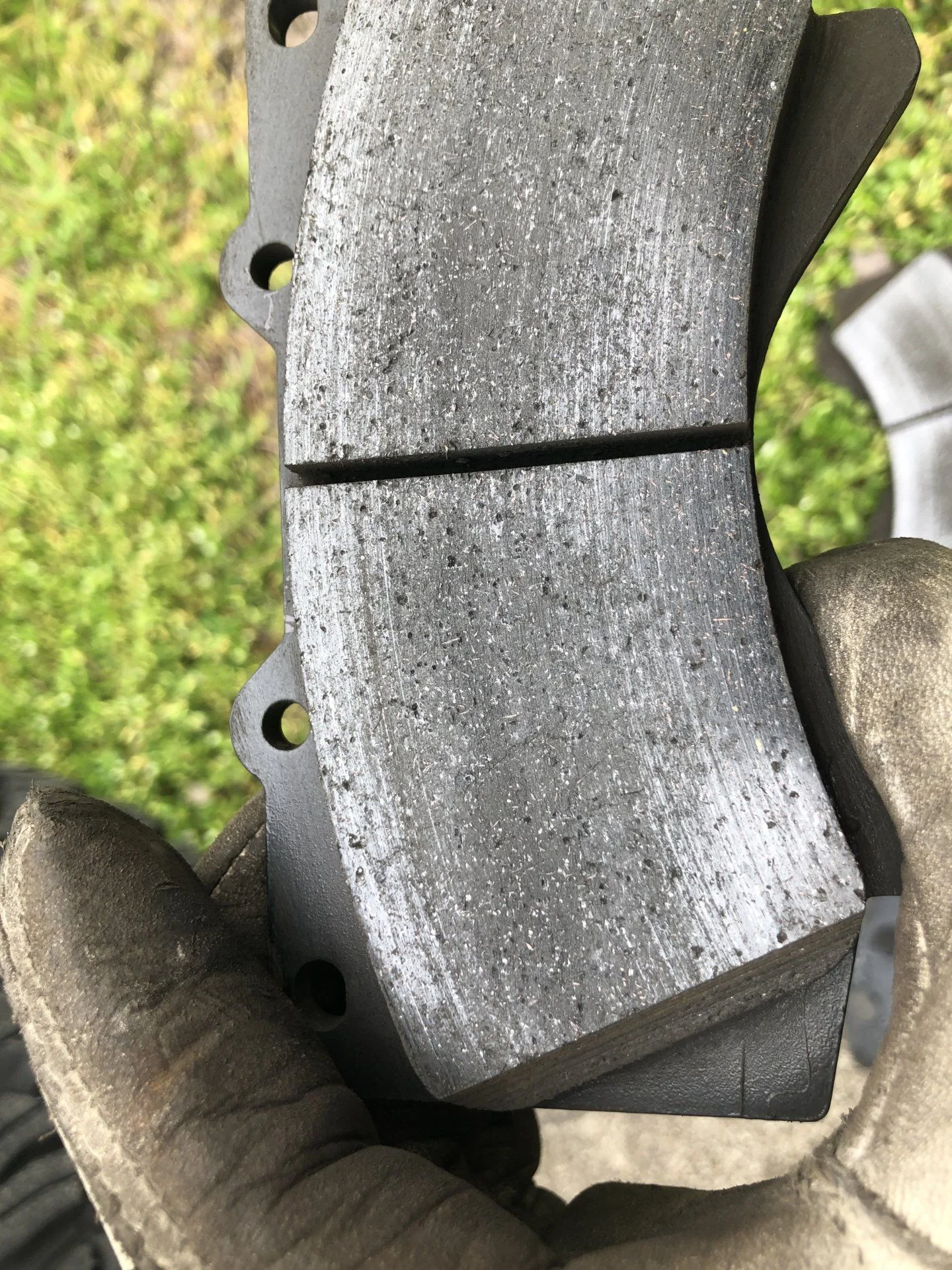

Got the rotors and TRD pads installed. The back face of both front rotors had very slight marks like the outside, but nowhere near as bad. I filed the lip off one and they measured about 29mm. The new OEM parts were 32.
Also the OEM pads on the pass side looked odd.. the outside edges looked like I’d expect a pad to, but the inside/middle of each block had a much softer and more loose surface. I scrubbed it with a wire brush and some material came off the loose spots.

Good pads from drivers side
1923224
Pass side pad before scrubbing
1923227
After scrubbing. The darker areas were very very slightly concave due to the removal of loose material.
1923228
I’m thinking I got the pads too hot at some point.. and the rotors having 10% of their thickness removed either from wear or being machined doesn’t help.

It would be interesting to know if the dealer installed Toyota rotors or aftermarket rotors, on the second set.
I agree with @JeffH, that this just looks like variation in the casting that has been exposed through the polishing of the material. I've seen it before on other vehicles. It's probably not a major problem to be concerned about, but it would be an interesting comparison of quality control if these are aftermarket rotors. Some of the more expensive post-processed rotors that are held at a high temperature after casting, and the cryo-treated ones probably wouldn't show this variation, at least not as much.
And, if I read the maintenance specs right, 29mm is the discard measurement anyhow, so they were ready to be replaced. The minimum should be stamped somewhere on the rotor.
The loose material is definitely a sign that they've been overheated. Exceeding its operating temperature such that the pad material starts breaking down.
Those irregular patterns on the rotor are now looking to me like localized overheat spots. I'm use to the whole rotor turning colors after a track day, rather than just spots.
New rotors will make a huge difference in moderating peak rotor temps so good choice on that. TRD pads should help too as their composition should be capable of higher temps. Might as well flush the brake fluid while your at it if it hasn't been serviced.
Was there a particular drive that your remember that you were hard of the brakes? Usually an extended downhill leg, with lots of gear in vehicle? May have been awhile ago.

I forgot to check closely but I do think they were OEM toyota rotors. There was enough rust that some of the casting numbers weren't visible without some scrubbing work, but the vanes and machining seemed exactly like the new OEM parts.
If it is metal that isn't homologous it'd surprise me from an OEM toyota rotor.
I don't remember any drives like that. Have been driving to the mountains for 30 years and learned about engine braking early on.. while I do drive the truck pretty hard I also try to take care of it in terms of not ragging on it. as mentioned with never stopping with foot on brake, etc.
The fluid (even the stuff in the calipers) appears brand new and tests at <1-2% moisture per my cheap amazon tester so it's staying in for now.
