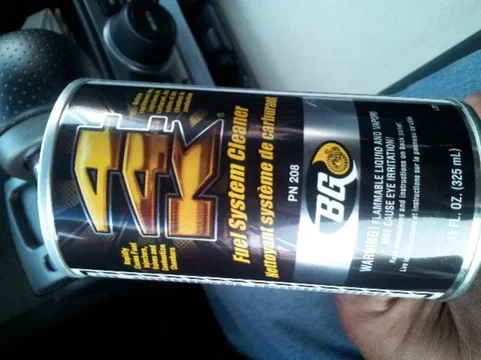

I just acquired a 1996 Lexus LX450 w/ 182k & 1 week into my possession, I got the dreaded code P0420. This is the sequence I took to clear it (its been 1 week & no CEL):
1. Changed PCV & hose (due to carbon build up) with OEM parts
2. Checked exhaust system for leaks (no leaks found)
3. Filled tank with Shell super unleaded
4. Added 1 can of BG 44k fuel cleaner
5. Changed cap & rotor with OEM parts
6. Unplugged negative cable on battery
7. Unplugged EFI fuse in near battery
8. Plugged EFI fuse & negative cable back on
9. Ran truck & code came back on (I am thinking the ecm hadn't picked up the cleaner fuel & BG 44k hadn't started cleaning!
10. Repeated steps 7, 8 and 9
That's what I did & it hasn't came back on! The engine is running really smooth on idle & acceleration!
I know there's a ton of threads on this but this might be cheapest step at clearing this code. Plus it will give your engine a good cleaning! I've always believed in using good fuel!
Thanks & good luck!
OJ95
Sorry, step 10 should read:
10. Repeat step 6, 7 & 8
Where did you get the 44k?
I paid $24.99 for the single can of 44k, I did not use the 3 can system. But I would imagine that the 3 can system is the way to go!
-OJ
It looks like the only thing of significance in that BG 44K stuff is Naphtha, at least according to the MSDS. Marvel Oil and Seafoam use it as the primary ingredient as well, and they're a bit cheaper.
I've read that Polyether Amine is better at cleaning varnish. It's in things like Gumout Regane and Techron fuel additive.
