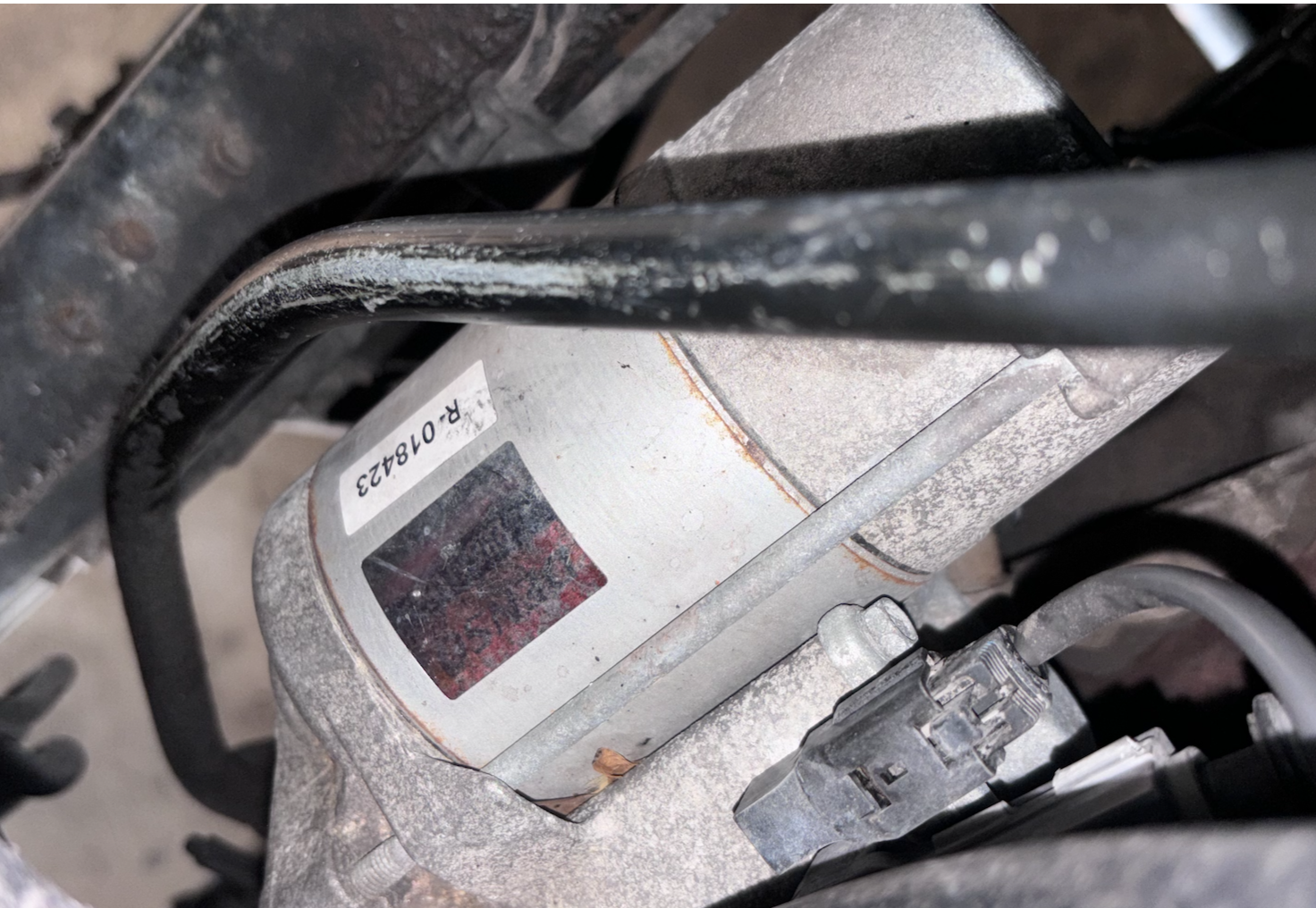

Bearings arrive tomorrow night. Anyway to ID the starter from this? It is a rebuilt from 2015.
