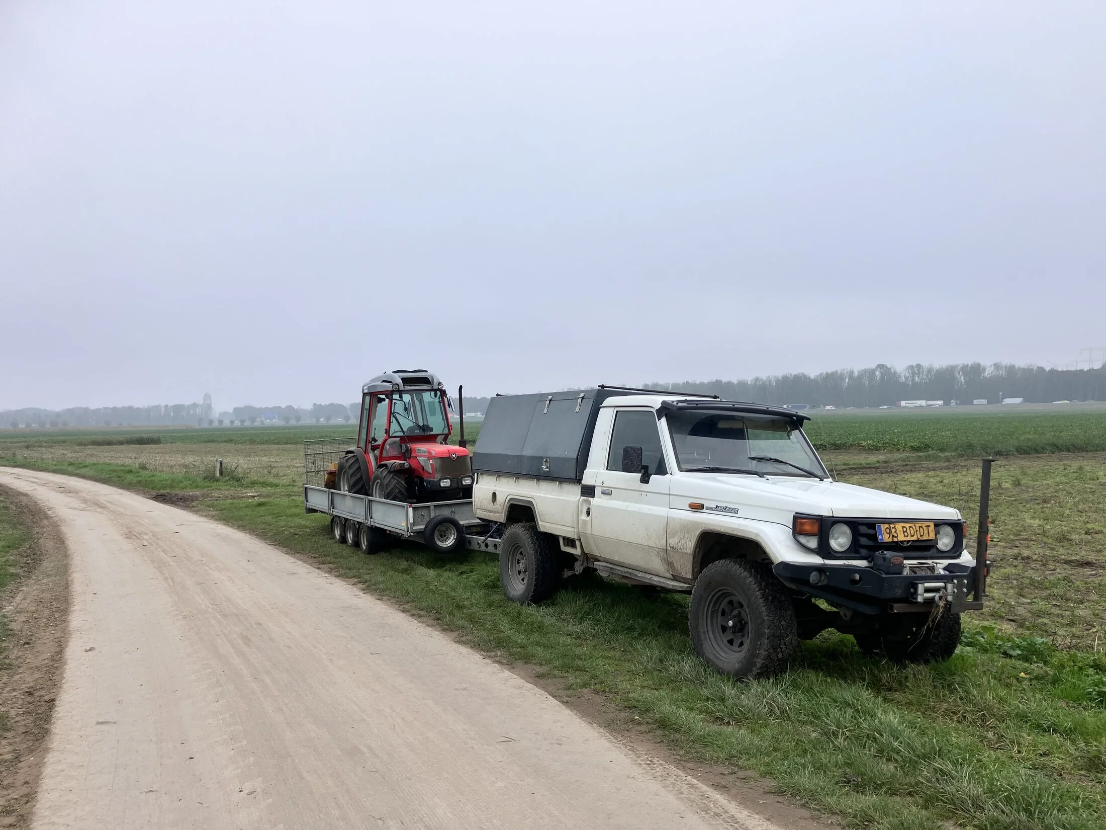

Hi there, I still have my 2002 hzj79. It has 560000 km's on it but runs fine. It still has the original gearbox but it starts making noise a bit. I regularly tow trailers, and with the 1HZ that needs some patience as you probably know ... I don't need a high top speed since driving trailers has a restriction to 80 km/h in the Netherlands. So lower gears are better.
There is a H55 for sale nearby from a HZJ75. Is that a good choice, and is it a direct bolt on to a 79? I know the problems of 5th gears but I can barely use 5th gear with trailers anyway. And I know allot of contractors around here that did >500 000 km's with 75's and old troopy's around here in combination with trailers.
