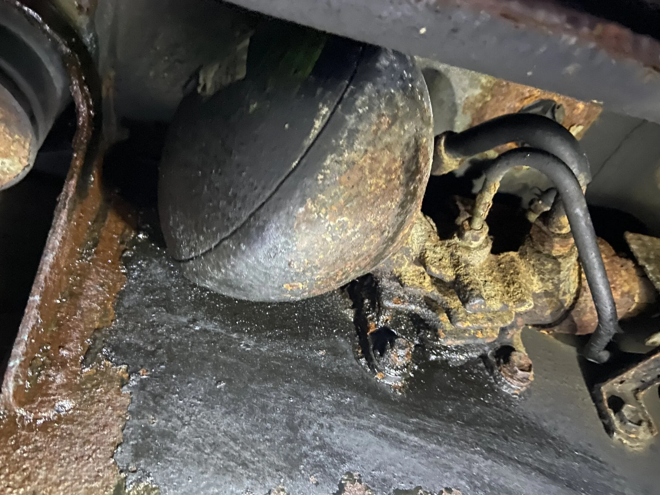

I am 99% positive the leak is coming from your rear AHC globe assembly. Could be the hard line, fitting, bleeder or globe or all four.
You still have the chance to save your AHC system by not running the vehicle and running the AHC system dry from that leak. I would strongly suggest to address the leak asap. Clean the area dry using brake cleaner/degreaser, turn the engine on and see/take a photo of where the leak is coming from.

It's most definitely leaking from somewhere in the system, but you don't need us to tell you that. You'll need to clean it off and see if you can identify where it's leaking. Hopefully just one of the bleed nipples wasn't torques properly.

need to know if it is a globe, or shock, or a line
being you are in CT, my WAG is your AHC lines are rusty, most others will get rid of the AHC and go with a either stock Landcruiser bars and spring or a small lift from and aftermarket supplier
you need to know exactly where the leak is coming from whether line or globe

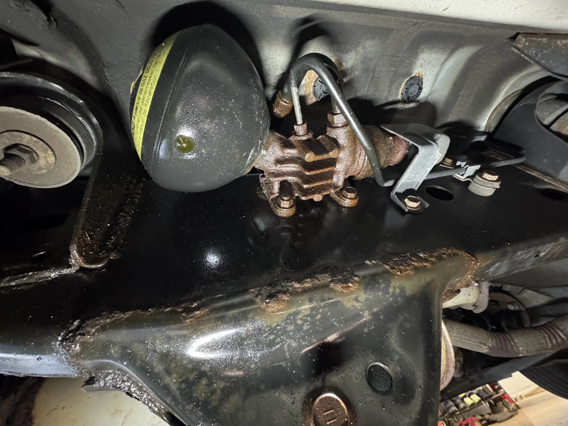

Thanks for your reply! The globe seemed to be dry, although it’s components are rusty(see pic).
After cleaning the area, the hoses fitting above and on other side of the globe assembly seemed saturated. I’m assuming this is the area but I’ll confirm this weekend once I start it up

Thanks for the reply. I’ll source it this weekend, I’m hopeful it’s a line. The strut on that side seems dry at the top and globe didn’t have any noticeable leaks.
