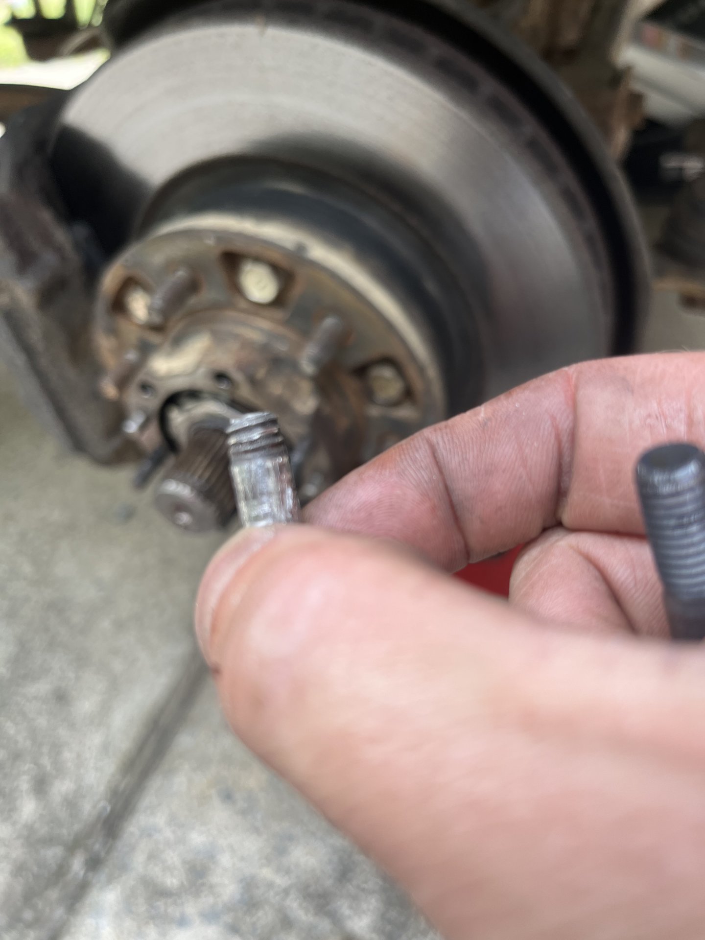

What’s the torque on a hub stud? I gave it a nice easy uga duga.
Please define "Hub Stud".
Front / rear
Drive Flange stud
Rear axle flange stud
Lug stud, front
Lug stud, rear
Bolt to hold the front rotor to the hub
Lower knuckle stud
There are a number of studs on the axle and what some people call a hub can vary. Pics are worth 1000 words if you actually point out what you're pointing to.
Yes, ALL the studs have torque values, despite what some may claim.
Oops. Ok I think drive flange stud
"I think drive flange stud"
Just for clarity, is the question what's the torque value when installing a new front hub stud (no spec) or is the question what's the torque value for the drive flange nuts that go on the front hub studs??

Studs not the nuts
run them in hand tight.
The nuts torqued on hold the studs in place.
The way I've done it is to drive the studs up to the unthreaded section very snug using blue thread locker on super cleaned threads (hole threads and stud). I've used a small wrench (4-6") for better feel and go until they feel like they're tightening up but I don't give them a final crank once the stud hits the unthreaded portion.
Key, IMHO, is to use a small wrench and pay attention to how the stud
gets progressively harder to turn. If using a long/large wrench or ratchet
you lose that feel or feedback from the stud (or bolt, nut, etc).
Maybe someone else can jump in with a better description.
FWIW
That tighter and tighter feeling is the stud threads jamming into the taps lead at the bottom of the hole. What you are doing is a great way to gall threads together permanently, luckily steel on steel isn't really gall prone. You ever do that with stainless components and that's the last time you assemble that part.

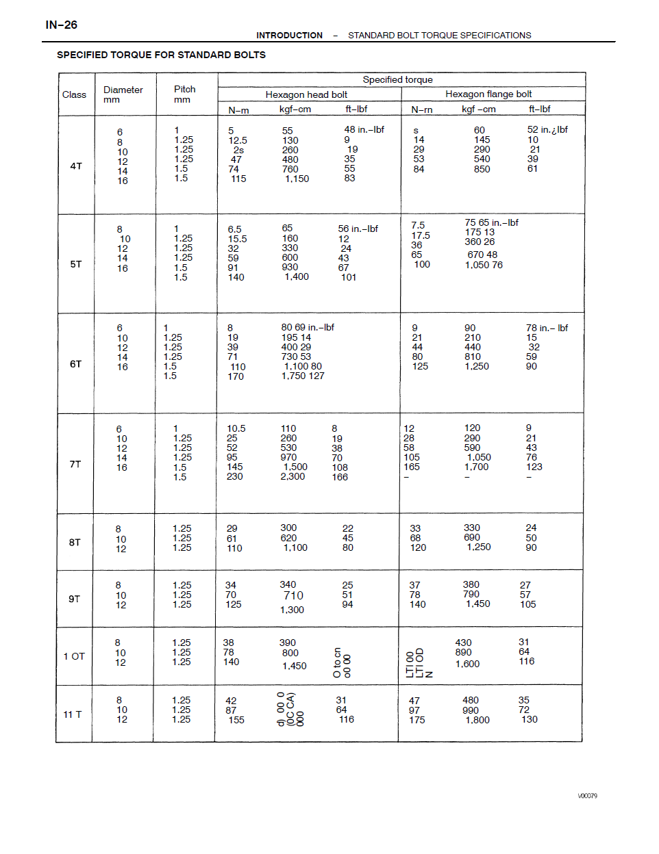

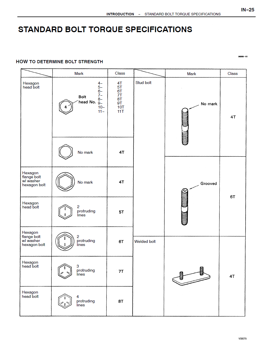

Absent input from an engineer, I would go with 9 foot pounds, which seems to be what's indicated in the Standard Bolt Torque Specifications section of the FSM for an M8x1.25 stud with no groove on the end:
Ha didn’t even think to look in introduction of the Fsm. 🤓🤓. Thanks
