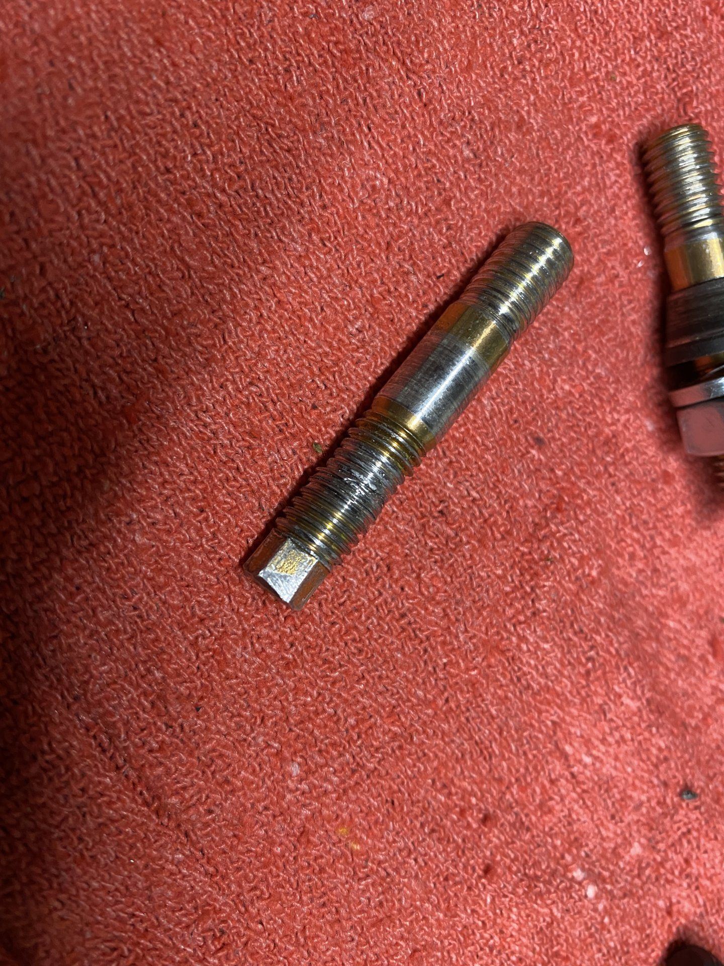

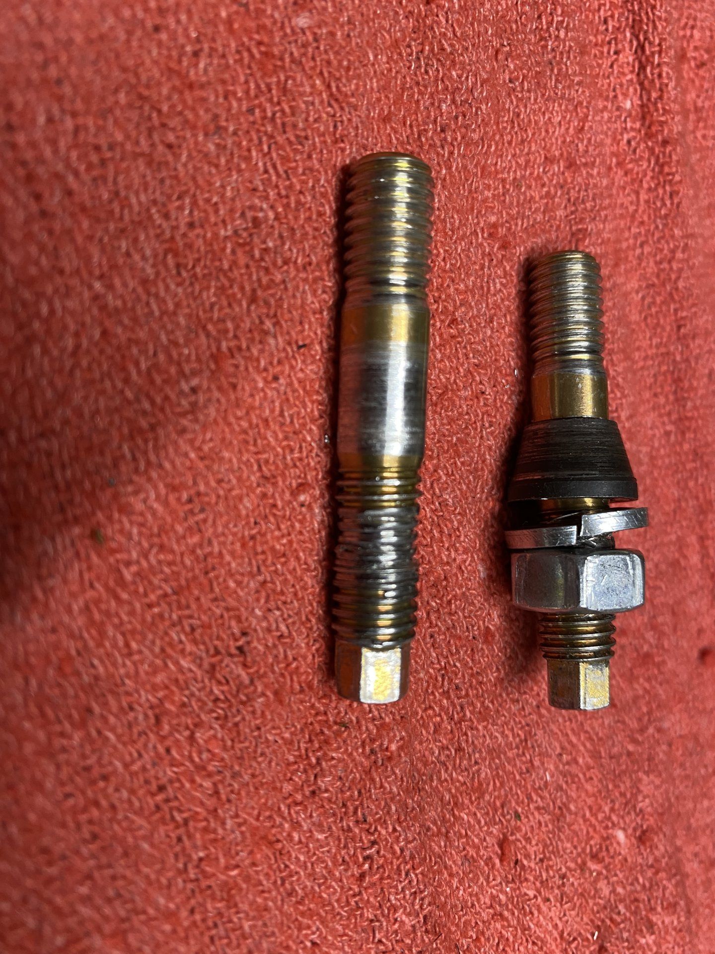

Ok guys... was at the last mile of my knuckle rebuild tonight when two of the fancy new hardened ARP studs gave out and stripped while I was tightening them to the 26 ft lbs spec. Fortunately I was able to extract them all without damage to the hub by using the ends. Obviously very disappointed in these, they were not cheap, and now have to replace them with OEM on all four corners.
2 questions:
1. Has anyone experienced anything like this with the ARP kit? Or is this user error?
2. When installing the OEM studs, does the short end go inside the hub? When I removed the old OEM studs from the hubs, the front studs were installed long ends in the hub, but the rears were the other way around - short end was inside the hub. I found this strange and assumed it was the POs install error, but can’t find any documentation or threads on this to confirm the right way to install.

I have not had my ARP studs strip like that but they do seem softer than stock. I bent 2 hitting them with a brass hammer trying to pop the conical washers, never had that happen with stock studs. But they were from Trailgear.....
Those don't look like the right thread, the hub end looks like you wore the the fancy gold coating off. Were you able to install these with your fingers or did you have to use a wrench? You should be able to finger them in, if the holes are clean. I've never seen ARP's in Wits End Gold :p

those are either not not real ARP's or you did something wrong.
Maybe send photos and/or the damaged studs to ARP for evaluation??

Before installing these, I chased, cleaned with brake cleaner and rags, and blew out the inside of the holes on all of the hubs (yes I am OCD like that). I didn't over tighten these on the install, just made them snug, and torqued the nuts/cone washers to spec. The first time I installed these, there were no problems - torque wrench clicked at 26, and all was good.
The reason I took the knuckles apart again the next day was to install the tone rings on my new axles, which I forgot on the first install. And the studs stripped on the second re-install.

Cruiser Outfitters also insinuated that my torque wrench is out of spec. While I am not disagreeing that it could be (it is a 2 year old Husky wrench from Home Depot), I don't believe that it suddenly went out of spec overnight, and over-torqued the studs so dramatically exactly 1 day after it installed them normally. I also can't imagine that hardened studs wouldn't be able to take a bit of extra torque and strip as bad as these did after 15 miles of gentle use.
