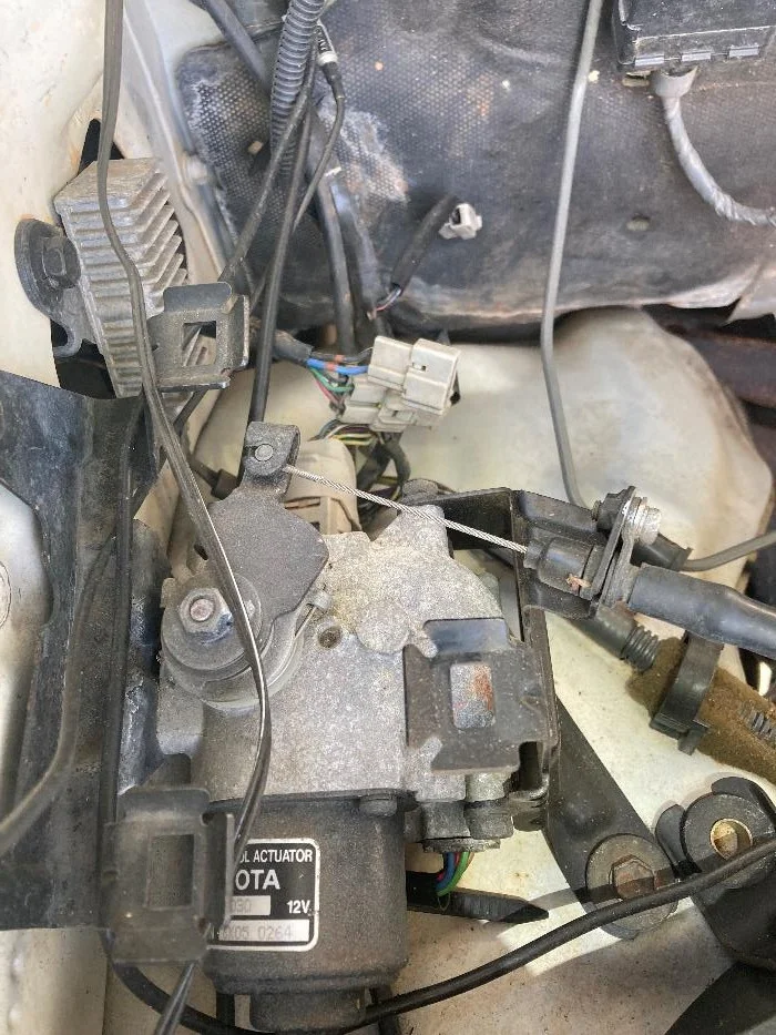

So the actuator is on the passenger side fender well, the cable is the one that goes across the middle of the page left to right. This looks good (sorry I haven't figured out how to add arrows to the pictures I post):

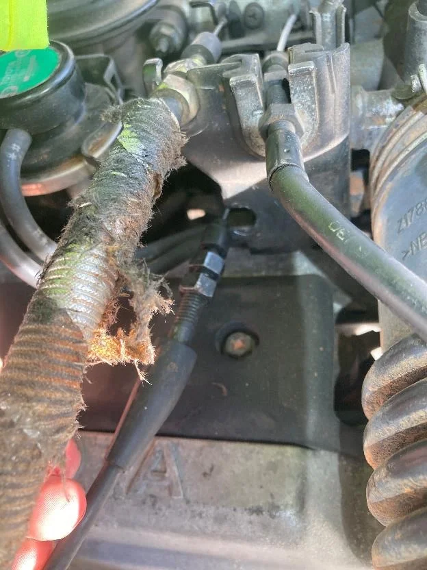

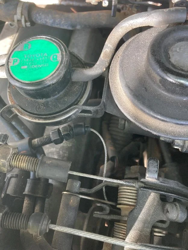

The other end of the cable at the throttle body though, has an issue. The cruise control cable is the one in the middle lower of the picture with the 2 nuts on it. I assume that the cable is supposed to be held in the round cut out of the bracket directly in front of the 2 nuts and rubber cap on the cable? The 2 nuts would sandwich the cable in the bracket cutout correct?

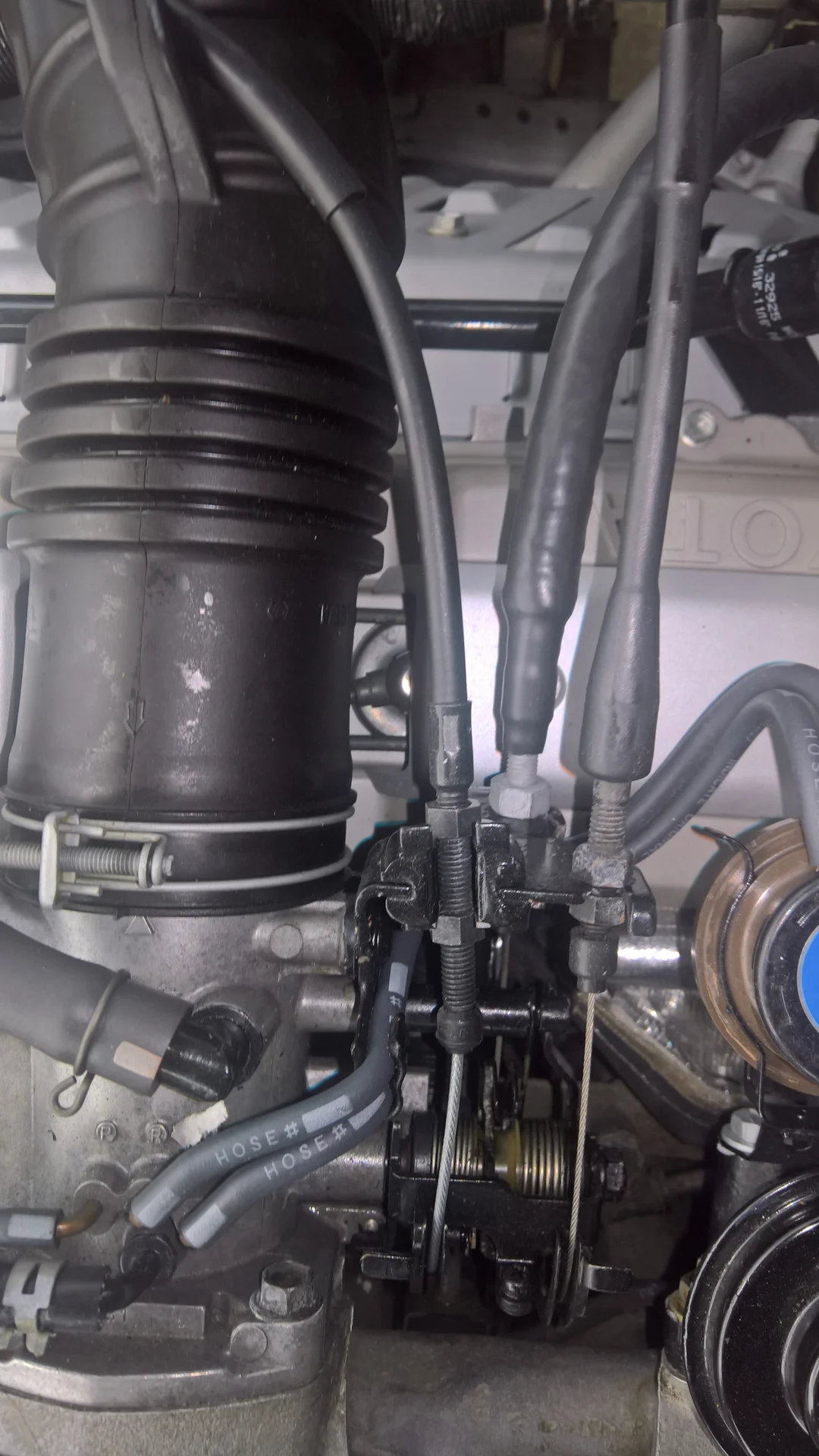

Past the bracket I don't know how the cable is routed. below is a picture of what I see downstream of the bracket.

I assume the cable is supposed to be captured somehow by the circular guide, the end of which you can see in the center bottom of the picture between the 2 horizontal cables (one is the throttle cable the other I can't remember).

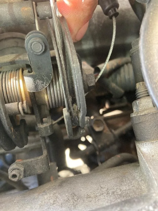

This fourth picture shows the end of the cruise control cable captured in the slot at the end of the cable guide. What I don't understand is how the cruise control cable is routed to take up all the slack? I figure I have at least 2" of slack.
Does anyone have pictures of how the cable goes/routed? The only tightening adjustment I see is the 2 nuts that would be captured in the slot in the bracket in picture 2. It looks to me there is waaaay more slack in the cable then can be adjusted by that. Can anyone shed some light on this for me?
The main problem is that the kickdown (Throttle) cable is in the wrong position. It's the cable with the fraying cloth wrapping. It should be in the middle position attached to the "upside down" pulley.

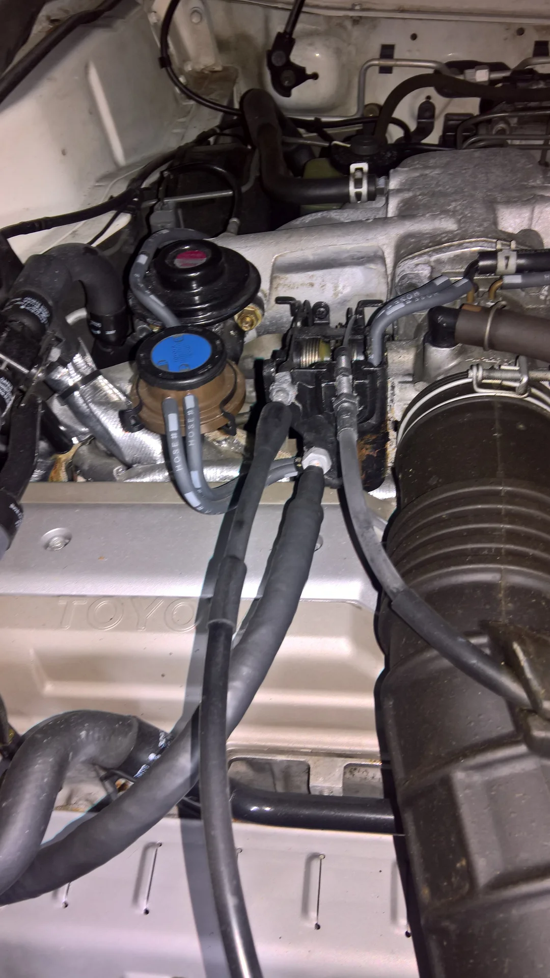

So starting from the front of the engine to rear the cables should be oriented :
Accelerator cable (top loaded pulley)
Throttle (kick-down) cable (bottom loaded pulley)
Cruise Control cable (top loaded pulley)
There should be one clamp that holds the cable to a bracket on the backside of the MAF. Then the cruise control cable should go to the rearmost pulley on the throttle body.
Photo taking from the front of the vehicle looking down: cruise control cable is at the top in the photo. Just out of the frame to the left should be a small plastic clamp/rivet that holds the cable to a bracket on the rear side of the MAF.

Looking down on the engine while standing by the left fender: cruise control cable is furthest to the right
Another view looking toward the engine from the right fender showing the correct positions of the cables connected to the Throttle Body

Main problem is that your Throttle cable and Cruise control cables are in the wrong positions (switched at the Throttle body). Read my post above and look at the photos, they are correct for your model.
@Damcowboy : I added a few more photos above, double click on the photos for a close up view.

Thanks again for the pics Kernal. I hooked up the cables as per your pictures and everything works now!
