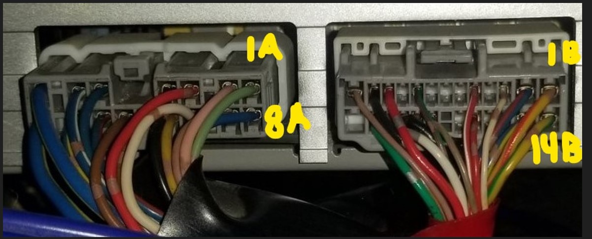

I can't speak to the Nakamichi system. On my ML, I removed the factory amp completely. The only stock wiring I used was the pre-amp outs from the ML head unit, which are just two channels (left and right), and the turn-on wire for the amp. The ML system is apparently crossed over at the amp, so the signal coming from the head unit is a complete pre-amp signal, to the best of my knowledge. I did not use a clean sweep, etc., though I did adjust the input gain of the VXi through the TUN software. My VXi has pre-outs and an output turn-on wire for my self-powered sub.
The ML head unit is plugged into pre-in of the VXi. The SL3 bluetooth works through the ML head unit. Here's a PDF of the wiring diagram, which I got from this forum (maybe even this thread - I don't remember)), and a close up of the amp wiring harness, which shows how to count the locations. FYI, the only way I could really make sense of the wiring diagram was to print all pages in color and tape them together.

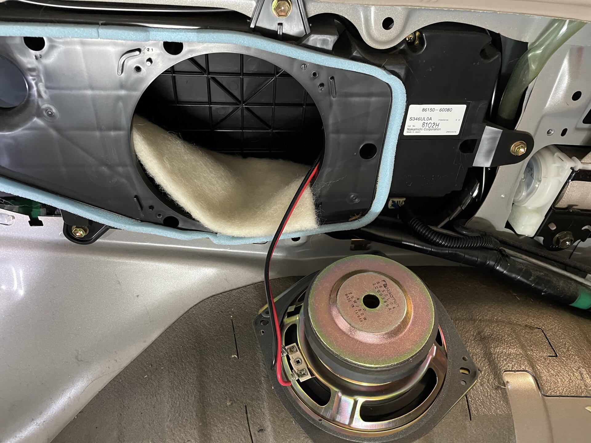

Installed the 6.75” Kicker sub today. Fit perfectly into the housing. Had to run in 8 new screws. Didn’t work the first time I hooked it up. Based on a post in this thread I switched the polarity on one pair of wires and that did the trick. Bonus, the sub has spring loaded connectors for the wires, no crimping or soldering needed.
Looked like the panel would fit fine but after getting everything snapped back in I discovered the back of the grill is just barely touching the sub. Need to shave a little plastic off the grill behind the fabric. Looks like an easy fix but ran out of time. Sounds fine for an old stereo. Definitely worth the $100.

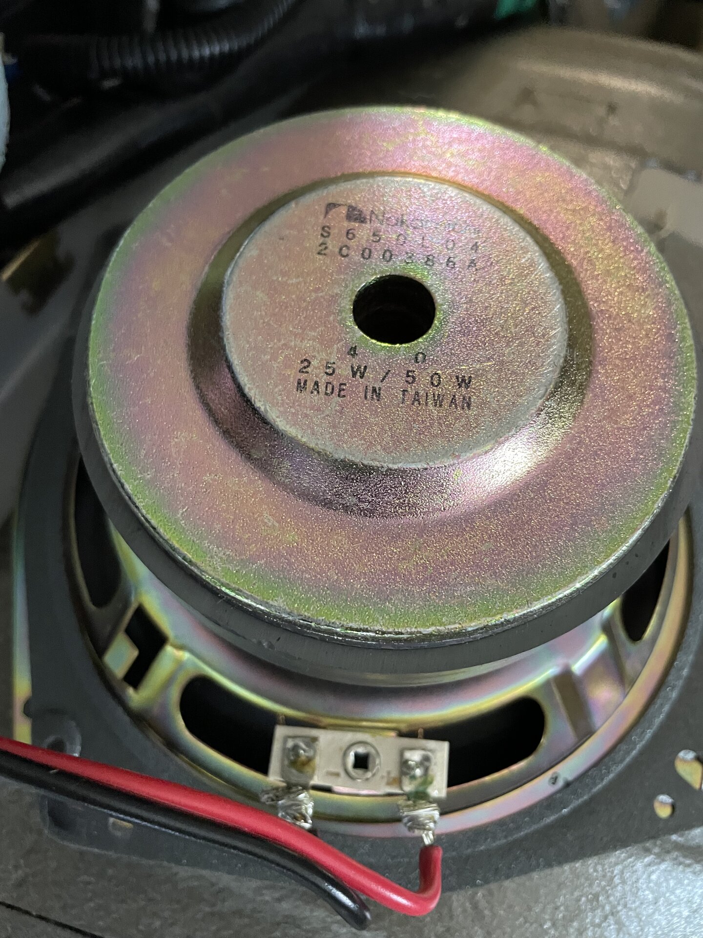

In the process of installing a new sub in my 99 LX470. It's a standard Nakamichi system. I replaced the system with Sony AX5500 unit and Infinity Speakers (front and passenger doors). Didn't replace the stock OE Amp. So, I guess, only thing stock are the speaker wires and amp. In terms of sub, I didn't really know exactly what I had to work with until I took the panel off...also, not savvy in sound system so learning as I go on this one.
Sharing for those with similar set up. The OE sub is 4 ohms with one set (one red and one black) of speaker wires.
I purchased Kicker 6.75" but the wrong one from Crutchfield. It was dual 4-ohm voice coils. So, I called today and they are swapping it with dual 2-ohm voice coils so that I can wire it as 4-ohms. When I get the new one, it will be wired as series per Crutchfield's recommendation (and not parallel) to make it 4 ohms.
In terms of fit, it was simple and easy. Will post the final pic when I get the replacement.
