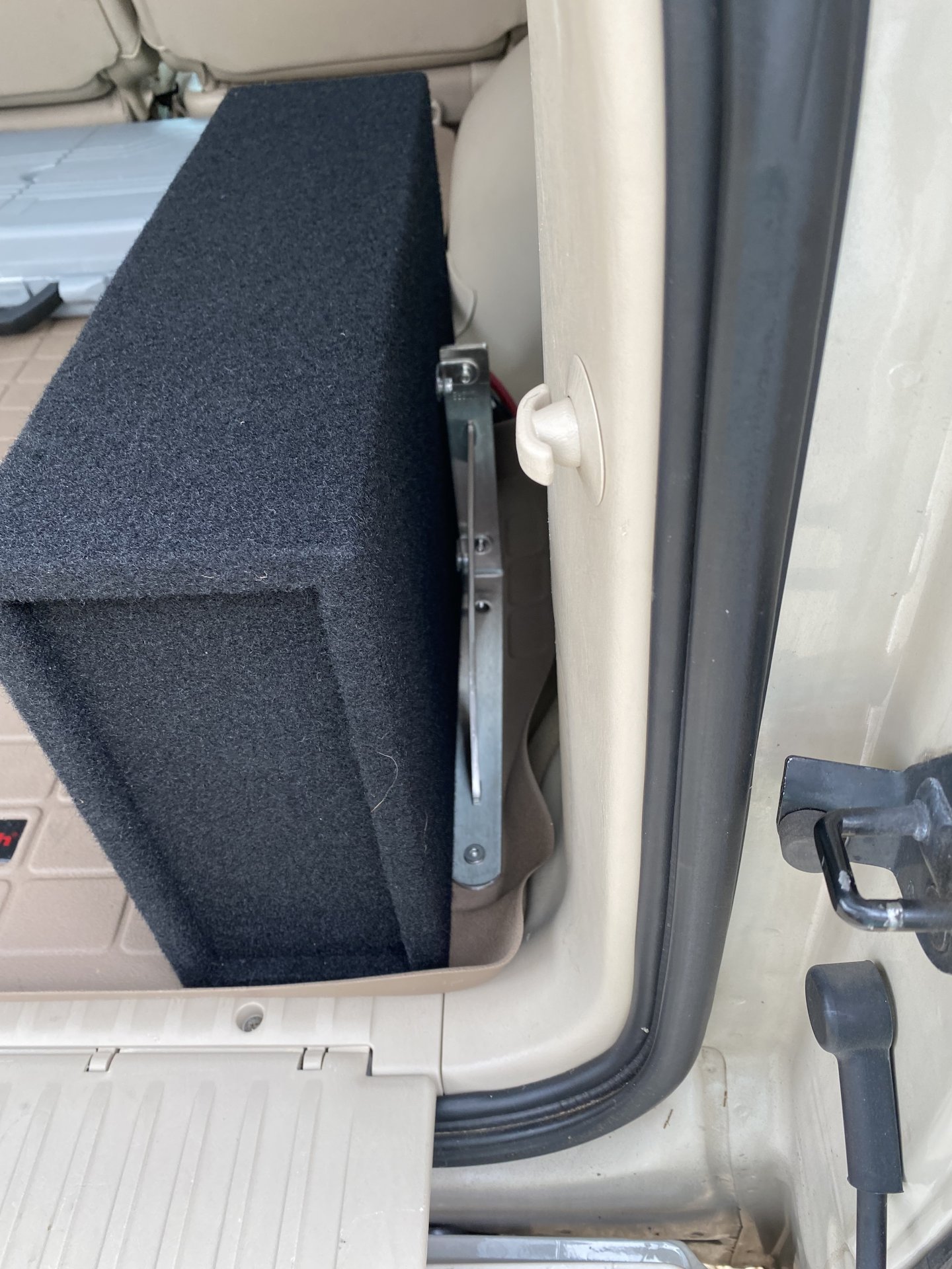

Personally, I installed a 6" bazooka driver in the factory location, then added a 10" powered sub, JL Audio ACS110LG-TW1, with a separate volume knob, JL Audio DRC-205. Full discolsure: I replaced all my door speakers with Focal, and replaced the ML amp with a JL Audio VX700/5i. The DRC-205 also allows me to adjust the volume when using the stock radio, since I lost the volume control and steering wheel controls when I deleted the factory amp. Normally, I stream directly from my phone to a VAIS SL3 bluetooth module that plugs into the factory wiring and sits in my glove box.

Even with 300 watts on the 6" bazooka in the stock location it was still missing something, so I added the JL Audio ACS110LG-TW1 self-powered sub. I usually don't turn it up past 3/4 to balance the system. Note: I installed threaded inserts into the back of the box and used a shelf bracket to anchor it. I'm thrilled with the results, but this was NOT a one-weekend project for me.

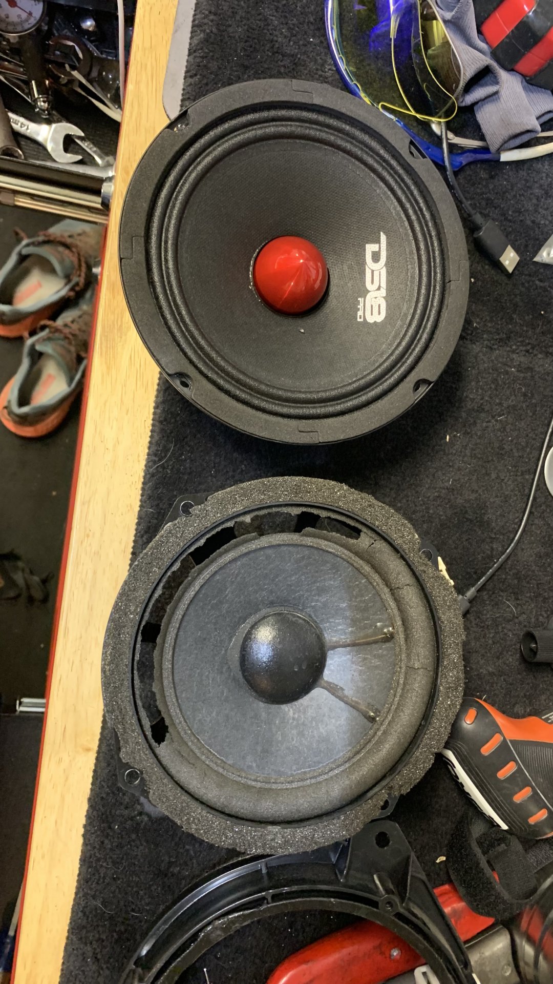

I did also replace my front door 6.5’ speakers with DS-18 Pros, the originals are anemic in comparison.
https://www.amazon.com/dp/B0766CHN7C?tag=ihco-20

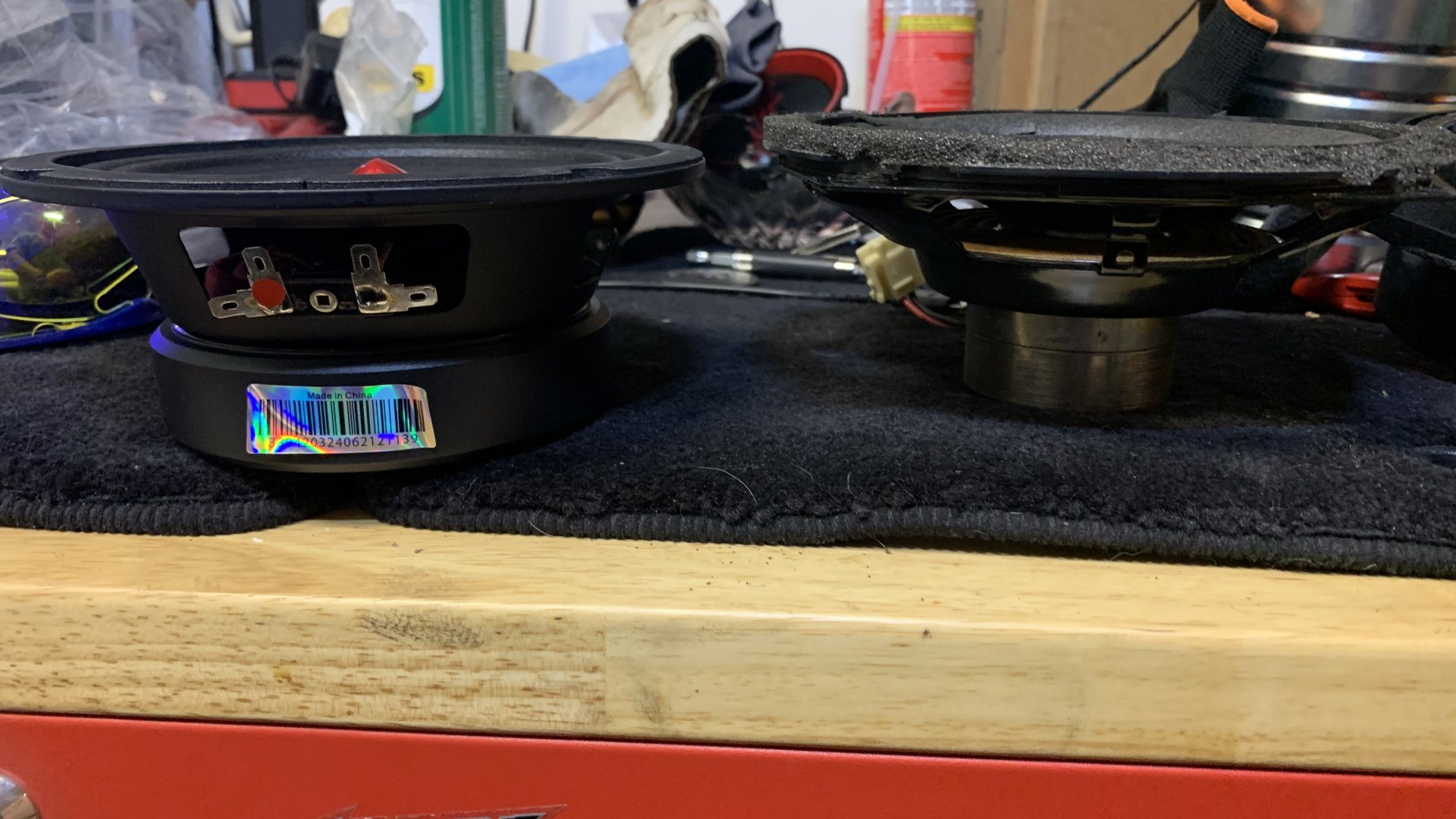

Some pictures. The DS18 did require opening up the mount holes in the frame and bending down the outer metal. I unsoldered the stock connections and soldered them on. I did use tin snips to fold down the Mount points for an extra “stock-like” install as well as clipping off the nub on the OEM frame as shown.

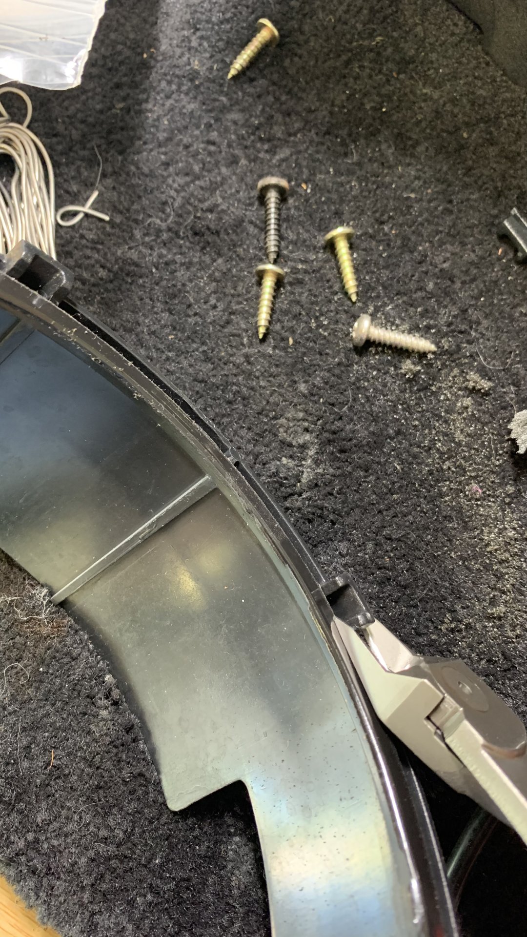

I managed to fit the largest and lowest Fs 6.5" subwoofer I could find in the stock enclosure - JL Audio 6W3v3
I used two generic 6.5" speaker adaptors that I cut in half and glued together so that the subwoofer would clear the rear wall.
I will have to modify the grill on the trim piece so that it will fit back.
