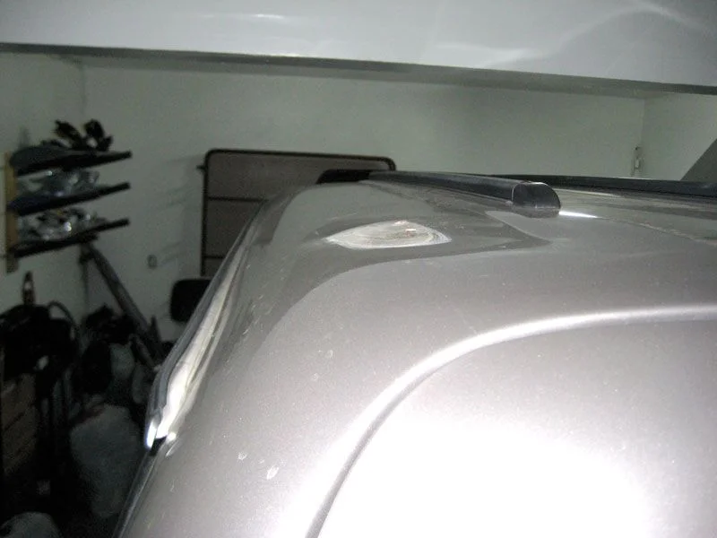

The back story is my wife was in a parking garage and long story short, on the lowest level the truck's roof rack smacked into the structural beam and tore the roof rack clean off.
The damage is limited to the rear legs of both rails. On the driver's side it just pushed down on the leg and now the roof line is wavy there. On the passenger side its more wavy and the nutserts were ripped out.
So, after reading I only found two solutions, stainless steel bolts with silicone or weld. I can't silicone where the nutserts are and wouldnt trust it. And I have no metal working skills nor tools.
So any thoughts on what the next step is and should I just have a body shop do it? Have to think about what they will charge but its gonna start raining here eventually.
Pop it out, fill it in with something (weld if you want, some FastSteel, JBWeld, or even Bondo should work fine), and then bedline the top.
It's doubtful that anyone will even realize it's bedlined. You can either do full coverage, or the "alien landing strip" style.
At least, that's what I'd do--and am planning on doing on both the :princess: truck and mine. I think I'm going to do full coverage on mine, and alien landing strip on hers. :D
If you want to get real picky, take it to a body shop and have them spray it after filling it with something (or fill it yourself and get it sprayed). Again, since it's the roof it won't be that noticeable even if the paint colors are slightly off.
A third option (and one that has been working well for me for over a year) would be to plug the holes in the roof with auto trim plugs and paint some bedliner over them. I painted two bedliner strips on my roof. One on each side of the truck that stretch to cover all four nutsert holes. If you go this route and decide to squirt a bit of silicone sealant under the auto trim plug, be precise and don't get any silicone seepage in an area that you intend to bedline.
Although, this option will not get rid of your wavy roof. :frown:
However, I drove around for months with duct tape over my nutsert holes before I decided on a plan. That is always an option too.

It looks like it came off relatively clean. I had a scary picture in my mind of what it was going to look like.
I have read on mud that silicone is a rust promoter.
How do you feel about bed liner? It seems to be waterproof and durable.
I was thinking about removing the rack, filling the holes with a nutsert or something solid, then covering it with DIY bedliner, especially since mine is black and it won't be as noticable.
I know your LX is a :grinpimp:ride, so maybe you would want to paint the roof the original color.
Is the wavy part creased or do you think it could be pulled out with a an autobody suction cup?

Ok so I am now leaning towards putting in some nylon inserts where I can, removing the nutserts that are now popped out and POSSIBLY taking down the headliner on one side and pounding the metal flat. Then I think I am pretty much resolved to the fact that my best option is to Line-X it. I am trying to decide between going the barcode or one large patch. I am thinking if its the bar code then either black or stock color. If its the whole thing then either the stock color or even white to help eliminate some of the heat soak. I'd prefer black but no way in hell being in SoCal.
I would go with linex and then a nice rack over it .
I like your new signature.
Well, it's not as bad as I thought it was going to look.
If the nutserts are still in, try using a screw to GENTLY pull at the sheet metal to straighten it out some. If thenutsert got pulled out, you might try using an allen wrench (right angle kind) and try to gently work the sheet metal - may or may not work and you're likely not to do any more damage than is already there.
I wouldn't try dropping the headliner. Major PITA from write up's here in the past - search E9999 posts on this IIRC. Where nutserts are still present, find some allen head screw inserts (don't remember what they are called), use a little locktite and screw them in to seal the nutsert hole. This is what I did before durabak'ing my roof. Been there for a couple of years now w/o leaks...not that we've had much rain in SoCal in that time period tho! Search for nutserts an you'll find other ways to plug them too from people that have removed their factory racks in more conventional ways (sorry - couldn't resist that one). :D
Cover the two strips with Durabak (do it yourself), or pay Linx or similar. They may help straighten out things a little too, plug holes etc. While you are at it up there you can see if the port monkeys that likely installed your rack in the first place remembered to remove the adhesive backing on those center strips. If they did, they are a major PITA to remove the adhesive. If they didn't, like mine, removing those center strips is a piece of cake. Worth unscrewing one and seeing if you're interested at all in removing them also. One way or the other, they shouldn't interfer with any aftermarket rack.

one cheap option for you would be to use some POR PUTTY to fill the holes, the stuff is easy to work with and super hard, I would:
- pull down the headliner if you can get to the other interior side of the hole, get a dolly and a body hammer and have someone hold the dolly on the inside while you hammer the outside to shape, then have a buddy weld the hole up OR use the por putty, wipe it smooth, let it dry, sand the area a bit, then go online and find a place that will send you a spray can of your stock cruiser color, there are places, mask the area off and shoot it.
the good think is it is in an area that nobody will really see, especially when you get the rack on there, I wouldn't spend much fixing this. Talk around the local area and see if you can find somebody with a welder, most guys that have them are open to helping, I am in san diego if I can help at all.
