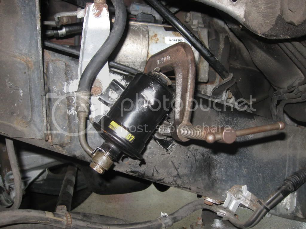

Did mine this weekend... wasn't bad. Just wanted to say couple of things and of course show photos... love photos :)
I'm grateful for IH8MUD and thank you everyone for posted their experience.
1. Remove the banjo line bolts (17mm) FIRST if you can. I couldn't get the bolt close to front of the truck off, so I had to struggle getting it off by clamping the filter to the frame w/ a c-clamp to get leverage.
2. I had more fuel spilled out of the filter than the fuel line, so have a small container ready. Fuel was so dirty coming out of the filter, I couldn't believe it.
