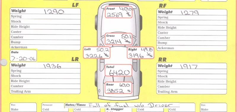

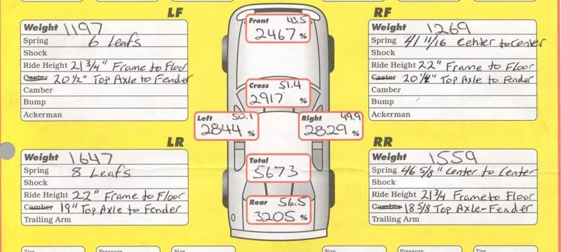

Loaded weight and empty weight on my 60.
