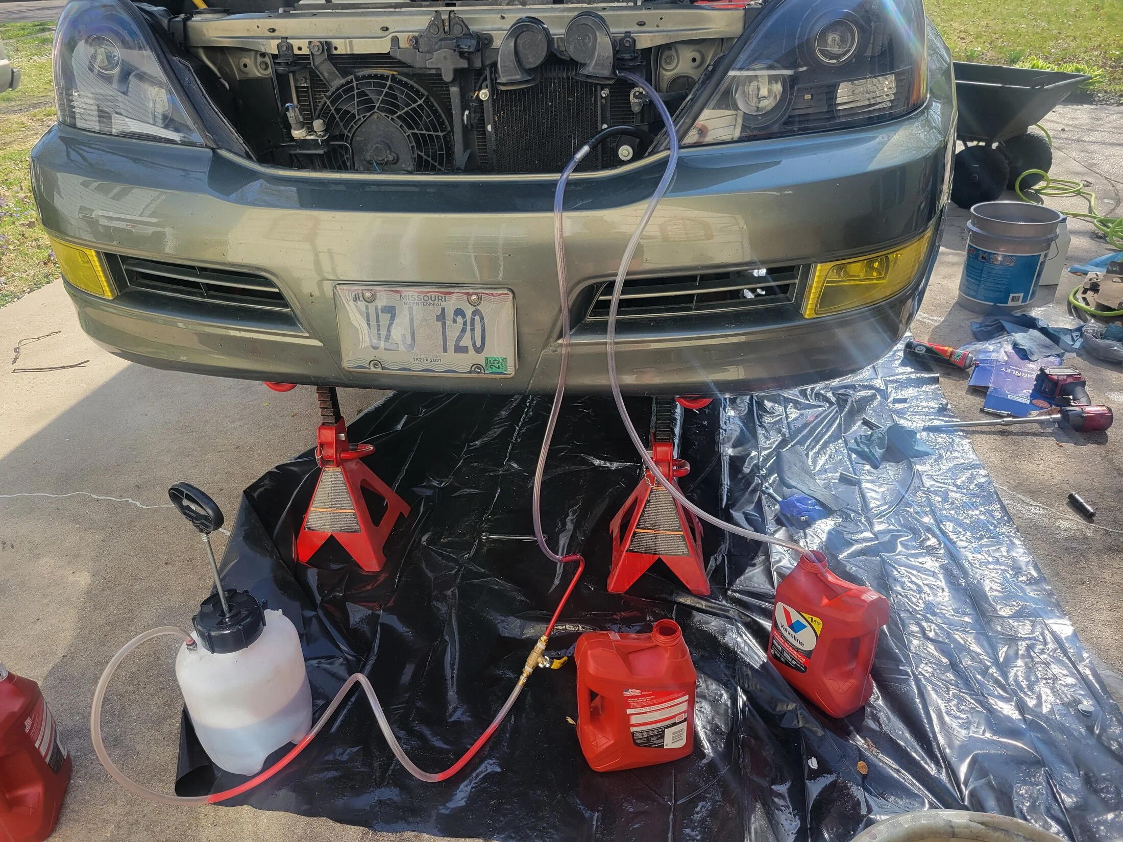

A pan drop/clean and full fluid replacement from the trans cooler is the right way to do this job. Then you get everything. I've done 2 fluid replacements on my rig and also did one on a 1st gen Tundra. Both shifted much better afterwards. If you transmission is "shocked" by putting in fresh fluid it was going to die anyway.
