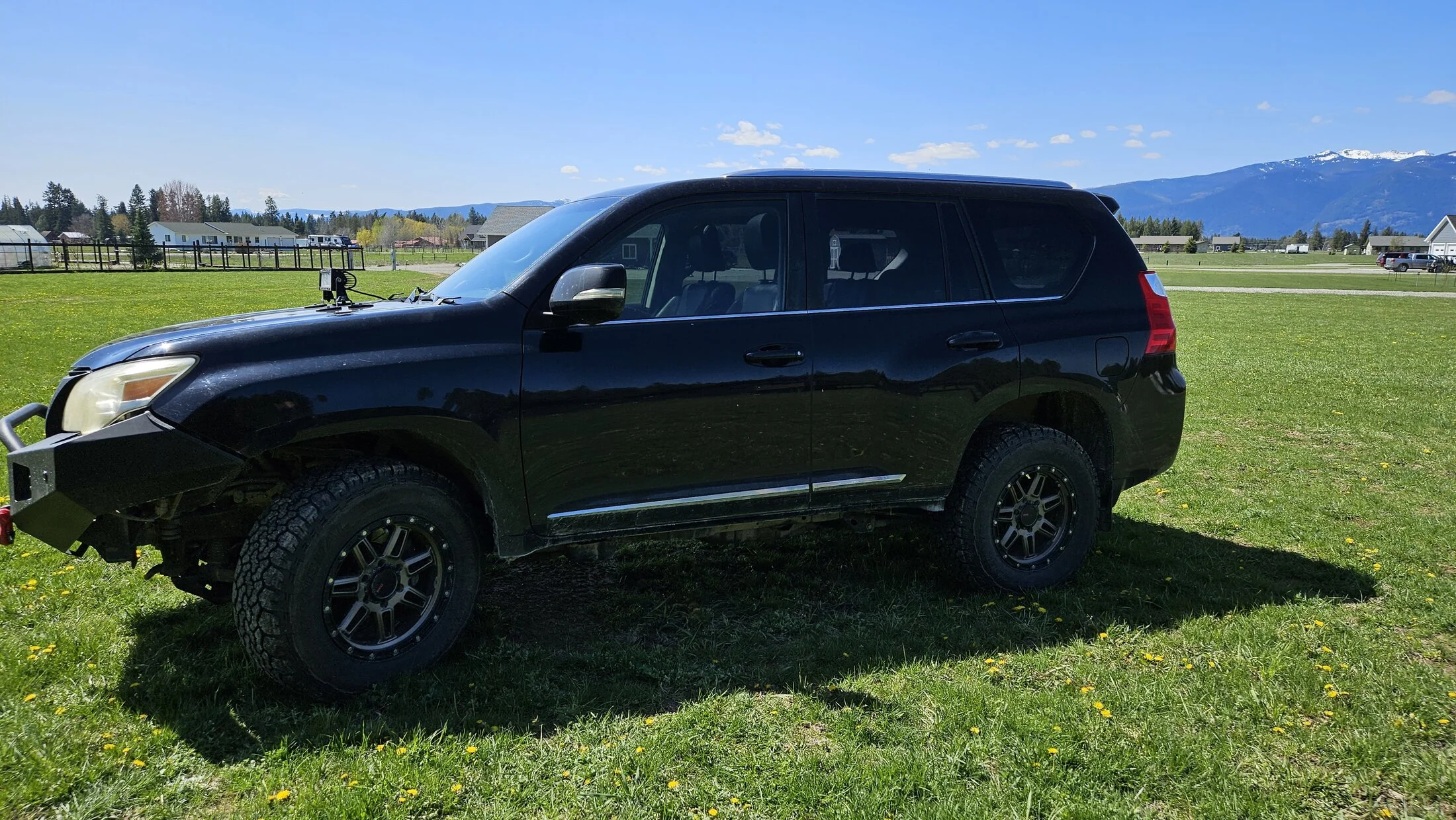

Depending on tires, which does vary on manufacturer, 265/70/17 seems to be the sweet spot. I only had issues with the rear running board bolt head when I went to that size. A low profile bolt, rivet, or removal altogether solves that problem.

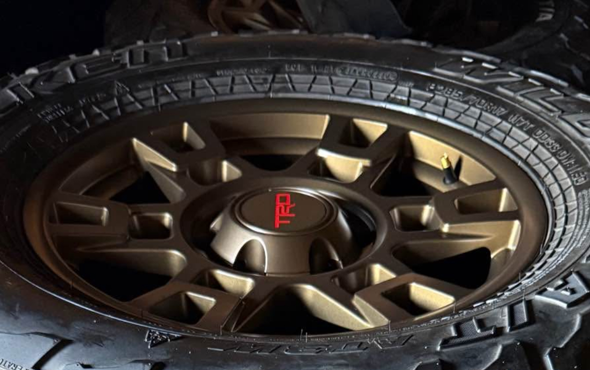

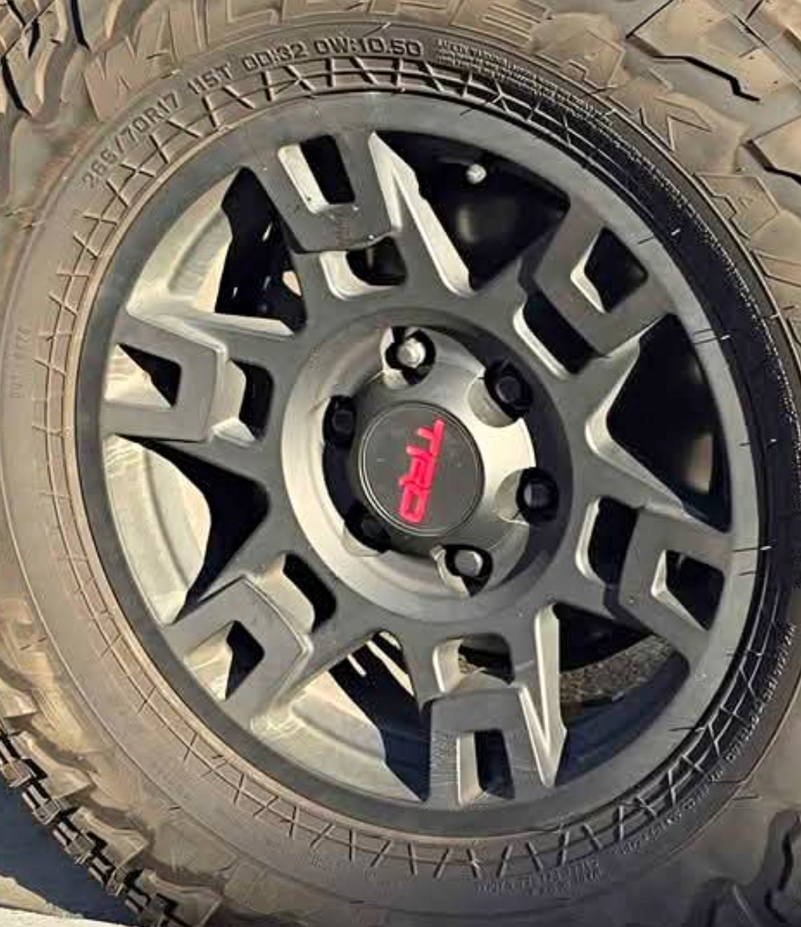

What Clint said. I went with TRD Pro wheels which are 7" wide and 4mm offset. And Wildpeak AT3W tires.
The important question at least to me when doing this was what is the largest size tire that can fit in the stock spare location. It is reported as 31.6” however as Clint said diameter can vary even among the same brand. The AT3W Wildpeak fits but is a struggle with the factory tow hitch installed. Some have reported that the new AT4W does not fit because it is slightly larger. It is individual tire dependent.
I took care of the rubbing side step bolt by removing them and installing Expo One sliders
