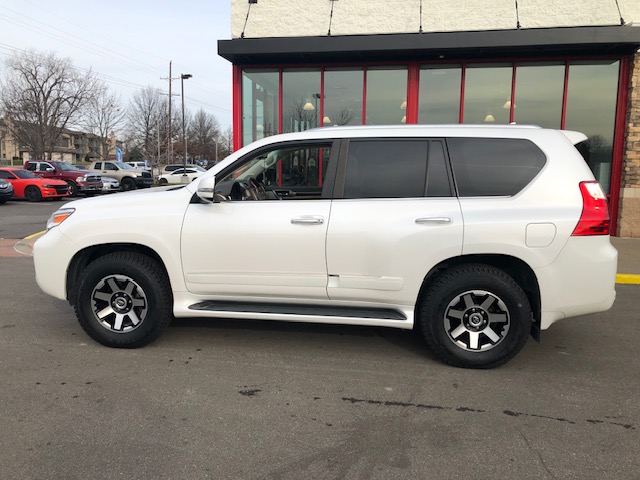

here's what i found...
18" oem rim weight: 32lbs
oem 265/60/r18 mich. defender 30.5". 36.99lbs
total wheel weight. 68.99lbs
bought:
RIMS
Method MR316. 25.16lbs - 26.12lbs, 8", 2650lbs/tire. 5.51" backspace. +25 offset (same as stock)
TIRES 255/75/17
Firestone Destination x/t. 41lbs. 32.1". upto 118mph (T). 50k mi wrty. 648.80 rotations per mile. load E
total weight oem: 68.99lbs
total weight aftmkt: 67.12lbs
went up 2" in size, dropped a little weight at the tires. no change in mpg's either.
this wheel combination will fit without problem in the spare location. i dont have a trailer hitch at present, nor kdss spacers.
rubbing occurred very rarely in the front only. just changed the offending bolt to a lower profile screw head and removed a small square piece of plastic screwed in the front of the front wheel wells. no bending needed.
VERY happy w/ this set up, driving & handling.
