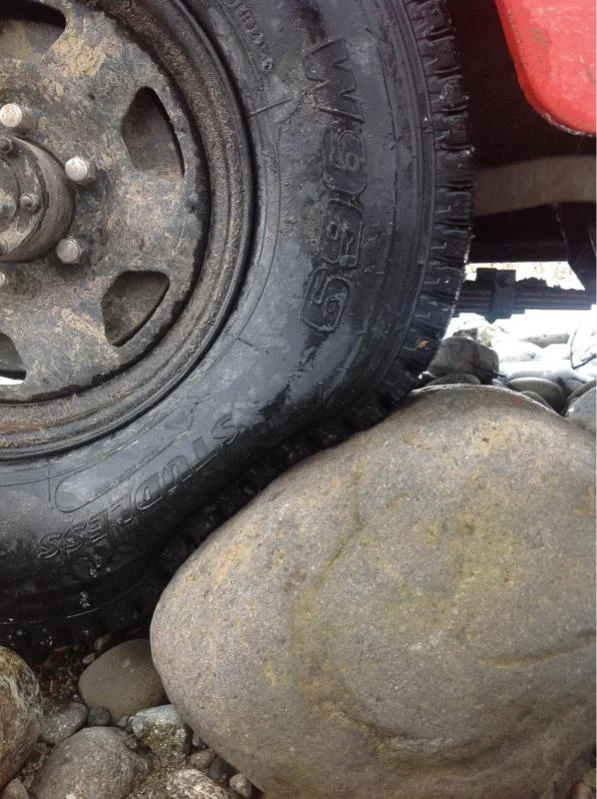

That's exactly what I'm doing. Pic is 20psi on 10 ply (E load rated) 7.50r16's. I usually run them at the factory spec of 27 psi front. It also will depend on terrain as in my case there are occasionally small trees that have been cut down on the trail leaving what amounts to 6 " long spikes sticking up. Wouldn't want to roll the sidewall over a set of those. Pete
Not bad. If definitely try a little lower.
