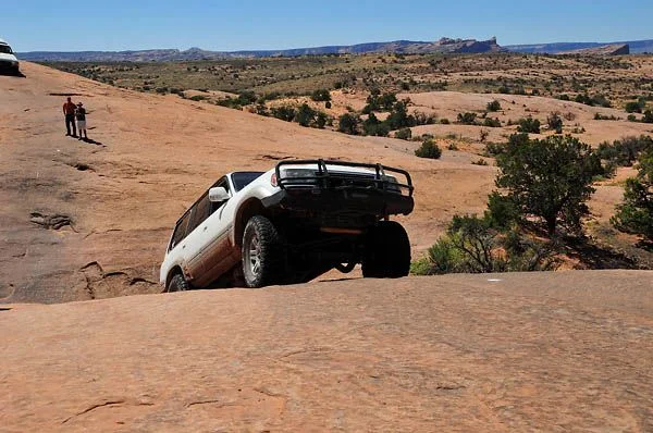

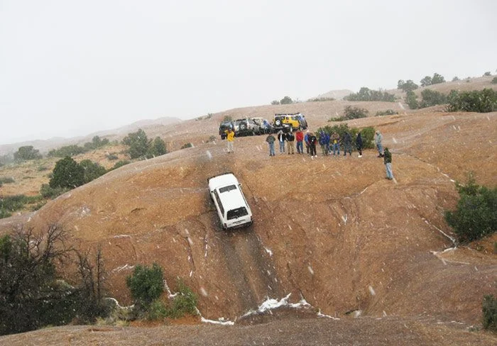

What hills have given you problems on 37"s?
Mine goes right up this. From the driver seat:
attachment.php
From the following rig:
attachment.php
Cresting the top:
attachment.php
