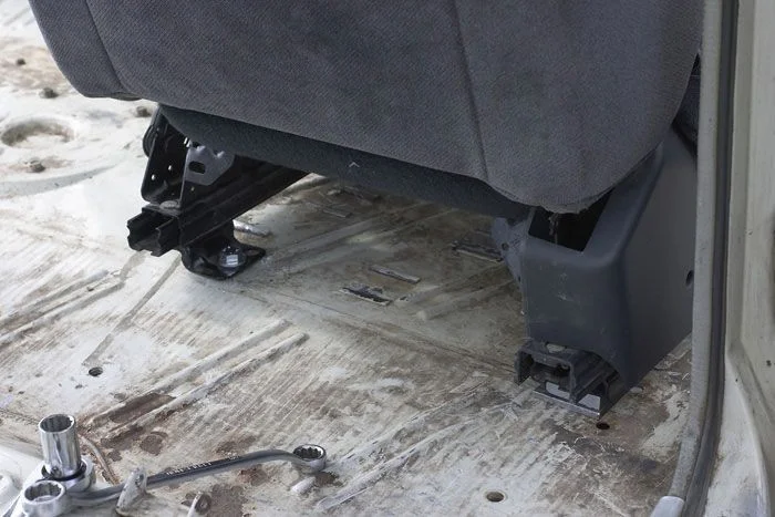

I used my 4" angle grinder with one of those thin cutting disks. Here are my before and after pics.
Watch out for the structural pieces that run underneath the pig's floor, I was very close to mine. I plan on moving the driver's side seat back a little more to clear better.
I used the raised round area as my level reference surface that I rested my straight edge on. I used those values to decide what size spacers to use. Passenger it was 3/4" and drivers it was 1.5" That takes care of 3 of the mounting points, I used Hardened washers to spacer out the 4th point.
Note: I think the driver's side spacer is a little high, maybe 1.25" is better, but I will decide that when I do the painting and interior work in a couple months.
These pics show the high point on the floor I chose and the spacers I used.
more
last ones
