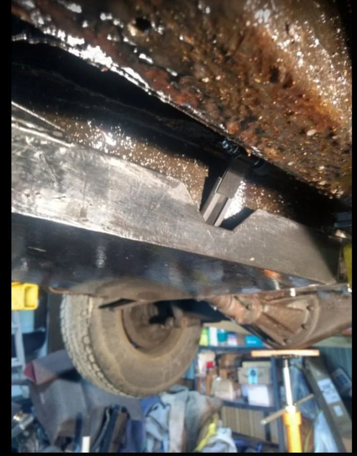

From another thread talking about rust. I fabbed this skid plate about 6 years ago from virgin steel. Wouldn't fit in my sand blaster so just used various abrasives to give the paint bite. 6 years in Ohio salt and the POR15 is still mint.

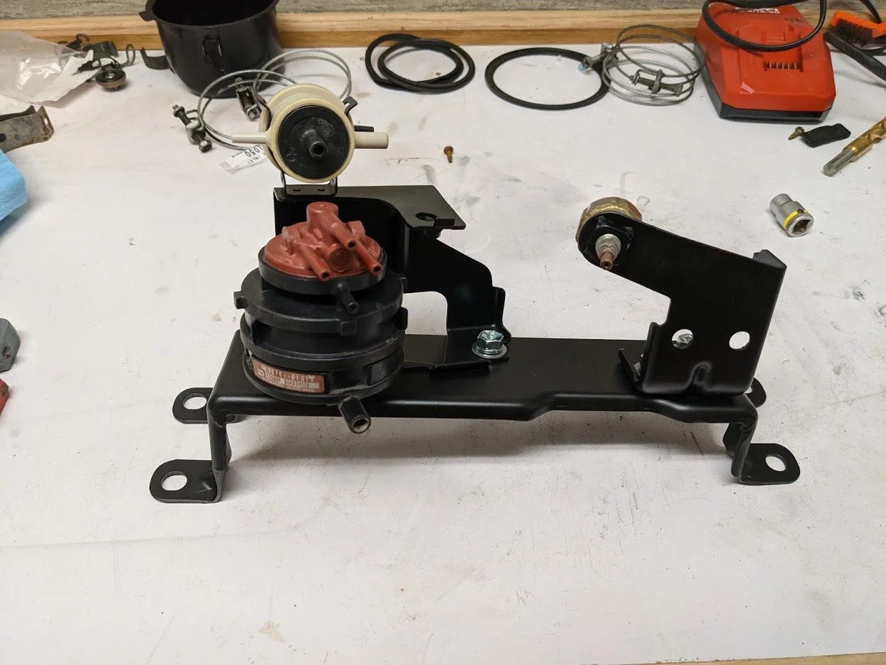

Here's the vacuum valve bracket for my 60 which I just painted.. Overall the paint stuck pretty well (when following the steps outlined above), but if i drag my fingernail across an edge, it flakes off in that area.
Is that normal and to be expected.

Post up a pic of this flaking. In general, paint won't stick to a hard corner nearly as well as a softened corner, so it may be expected. Can you get it to flake with your fingernail on your painted flat surfaces?

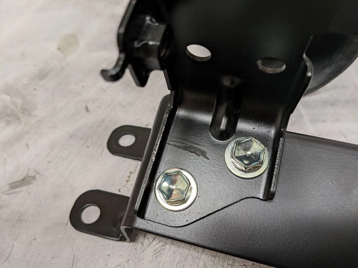

Here's a pic where I scratched and edge and the surface with my fingernail.. It sticks on the surface, but nowhere near as well as factory paint.

That looks to me like it's not cured. A rustoleum enamel style paint will cure hard enough that you can't do anything to it with your fingernail. Not curing may be due to temp.
Also make sure you are sanding the parts bare metal of existing paint to put small scratches in the surface to be painted so the new paint has something to adhere to. 45 degrees is too cold to have paint cure properly. I put my parts in from of a quartz light after painting to flash off all the solvents in the paint so it will cure properly.
Agreed w/ all of the above that it looks uncured. But note, I am bringing them inside after painting to cure in a ~70 degree room.
