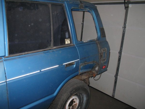

It started with trimming the rust which led to bobbing the rear. As I finish welding the bob, I take a step back :whoops: and decide it is best to open the fenders more. Here is where I am at now.

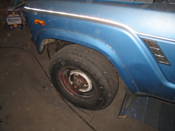

You can see where I have cut the front fender. I am going to go back and open the rear equally.

ive just bobbed my 60 ,4 weeks ago took 15 3/4" of the back its great , but i want to open up my front fenders like you but i carnt see what youve done to make them bigger ????
How do you open up the front fenders and what do you do with the inner guard ( wheel well) how do you get that bigger the easiest way ?????

Well, at LEAST a 33x11.5, 34" swampers would look nice, but I'm not as optimistic as Lowtideride about 35's fitting without rubbing under compression. Sure, they might fit for DD duties, but maybe not trail duty.

Well if 33's fit with out rubbing on a stock rig, then a rig with 1.5 inches removed from the fenders will fit a 36 inch tire. remember you only gain one inch in height for every 2inches up in tire size.

You cannot trim much from the back fender. There is only a lip that is trimmable. Sure you can cut a lot out front but the door in the back blocks it. You can trim as much as you see.

For the rear, I only removed the 1" lip around the fender well. I have decided tp come back and trim the outer body to the largest diameter of the inner fender well. This will give me another 2" to the top and rear of the axle center. As the axle moves to the rear when stuffed, this will allow a larger tire in compression.
For the front fenders I have cut the outers to meet the largest radius of the inners. I will then lay a stip of material back in to close off the fender well. I am going to try to finish the trimming tonight. I will post an update then. The pics should better explain.

There is actually a lot of material that can be removed from the rear. The majority of it will come from the top and rear of the fender well. I am simply opening the outer fenders to meet the inners.
I figure that I can stuff 36" tires with a shackle lift. For the front, I will have room for 5" of up-travel with a 36" tire on stock suspension. The shackle that I am working on should greatly increase this.
:cheers:
Right on. Good to know. BTW, a lot of the tire rub in the rear will occur on the inside part of the fenderwell. It's a pretty smooth surface, but it does make a lot of noise. I can only imagine that it would be worse with a bigger tire on little lift. I think that a more offset rim will help a lot here.

My plan is to use a healthy wheel offset. That is why I am trying to open the outer fenders as much as possible. After final trimming, I was able ot scalp 3"+ from the rear fenders. My only concern back ther now is the body mount behind the rear tire. I may have to modify it also. We will have to see...
