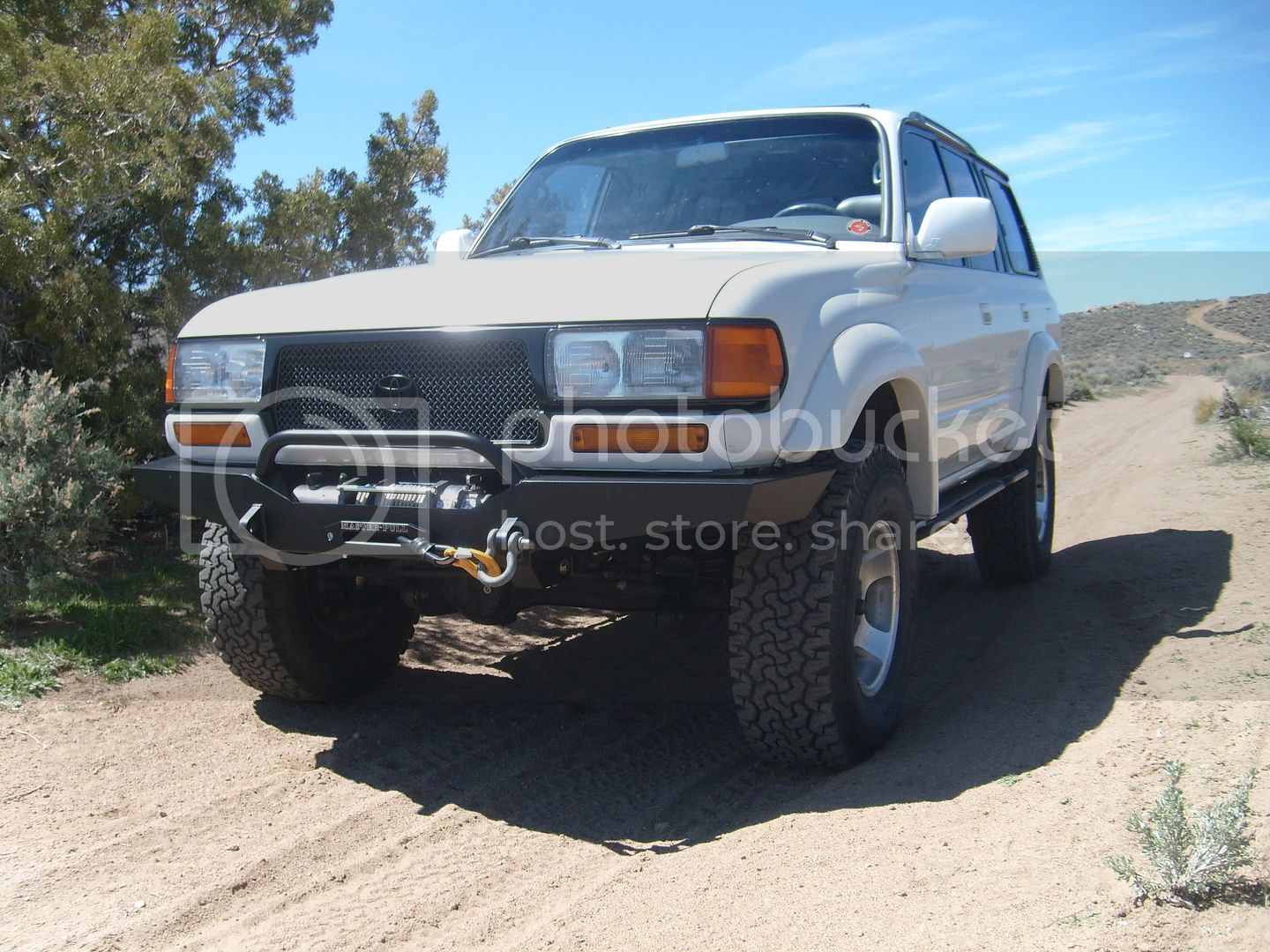

Home Made Plate Front Bumper
x10 for wanting one!
I volunteer to CAD this (for an FJ62;) if you can send any dimensions of the top plates and front plates to help me get started, and the angles as well, I LOVE the angular look and think it will fit my 'Land Shark' build perfectly!
Very well done!
Finally got the bumper back from the powder coater.
I'm digg'en the style, may-be time to install that 4:88 from the group buy, and slap on some 35+ shoes. That https://forum.ih8mud.com/80-series-tech/229592-fjz80-strut-grill-satoshi-grill-mod-style.html should put a nice finishing touch.
Sadly, I made a grill just like that.... but the accident smashed the plastic. I still have the mesh insert, but I cant get the paint to stick to the chrome so it looks like crap in two weeks after I paint it!
heres the grill...
https://forum.ih8mud.com/nv-battle-born-cruisers-northern-nevada/401546-my-new-grill.html
Thanks fellas.
I think it looks a LOT better than it use to a couple months ago... :eek:
Hopefully this bumper won't be "tree tested!"
Just a great looking bumper. I bet it would do better than the factory bumper in a tree encounter. It's amazing how professional that thing looks once it's finished, but that's a comment on my ignorance of metal work not on my assumptions about your ability.
A sign of one's accomplishment is how much it inspires others to follow suit. This makes me want to learn about metal working and welding.

Finally got the trim and grill back together. Hopefully grill #2 wont have any encounters with trees anytime soon! :lol:
Now if I only had the money to mount a Vision X Evo Prime LED light bar on the bumper... :eek: Someday...
That's the best bumper build I've seen on here yet. It looks fantastic, not overkill at all but still looks like it means business. Congrats on a job well done.:cheers:
I made a front bumper a couple months ago that looks almost exactly like that one. I made my center hoop higher and then split the headlight-turn signal with bars that then angle down to the wings. We've got alot of deer, so I wanted a little taller protection.
I wish that I'd have dropped my winch plate down in between the frame rails like you did though. I placed mine on top and it forces the bumper to stick out a little farther than what I'd like.
