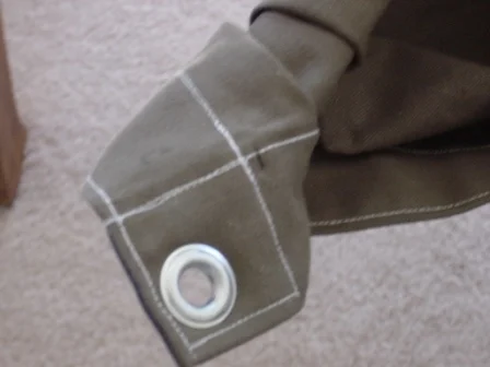

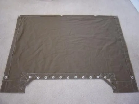

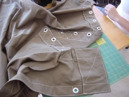

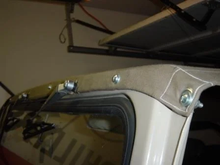

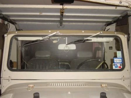

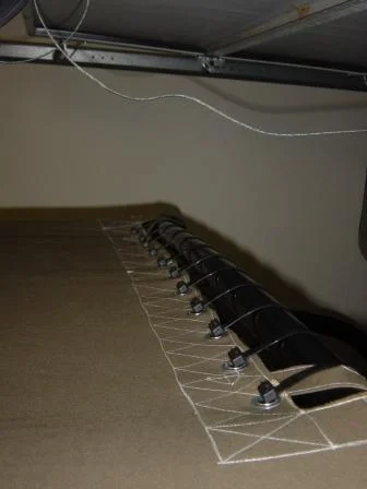

So far it is going well here are a couple of pics... I will post some of it installed and complete... I am using some 7/16'' stainless gromets and zip ties to mount the back of the bikini to the roll bar. My whole goal was to eliminate those ridiculous (2) straps that get in EVERYONES way on your normal bikini.....

I love it but I'm more concerned with the material used. Wonder how well it would hold up to weather and the sun. Especially black but I love the design. I think you could sell a few of these. I would consider buying one if the fabric used is durable. You could also use Sunbrealla but that might change the price. Another thought would be to use some sort or durable rope to wrap in and around the holes and bar without the zip ties. Like one long piece of paracord or something. Could you possibly post a few more pics. Maybe of it outside and the whole cruiser??

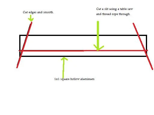

If I made my own top I'd buy the awning rail used on RV's. It's like the aluminum tube idea but pre made with a flange to attach it. You sew a length of rope into the hem of the fabric and it slides into the tube with the fabric exiting through the slot in the side. The style sold by Best top et all has a flat piece of plastic on the top that fits into a groove in the mounting rail, sometimes if you let the top get too loose it will come out while you are driving, don't ask me how I know.:lol:

I disagree. I have seen many bikini tops including the ones you have posted and i am extremely dissapointed with the fitting of them. I think the only time those bikini tops look, much less fit, decent are the instant they are installed. I also believe the two strap/ footman loop mount is a mickey mouse design as well. In all reality half of those bikini's stretch sooo much due to the water and air it catches. I have seen on numerous occasions a pool of luke warm water watiing to iether slowly evaporate or be pushed out from beneath leaving a poor excuse for a bikini top.
As far as the last post regarding self adjustment that is what the zip ties are for, i dont quiet understand how one would mistake that for not being self adjusting. :meh:
Also i had brainstormed on using some type of rope through the rear gromets but that does not allow for a uniform fit. When installing using the zip ties one can start from the middle of the roll bar and work your way out, similar to placement of a sticker. This bikini really does fit like a glove :clap:when installed properly. As for material i liked the idea of it being canvas allowing it to be thrown in the washer for a quick rinse.
Just my thoughts.

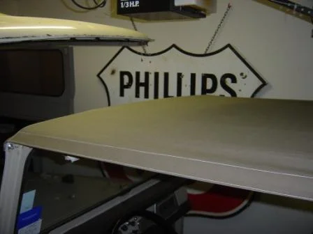

I'm sewing one of light canvas....I used 2 small flats of aluminum from Lowes sewn into the front that fits perfectly in the windshield channel (via bestop)......I havent done the back yet but think I'm going to try wrapping around the roll bar and using velcro.....we'll see....................Other than the mess Bestop has with their velcro issues around the door posts it actually is a great working product......Just not sure how it'll work there but I have to try it.....
