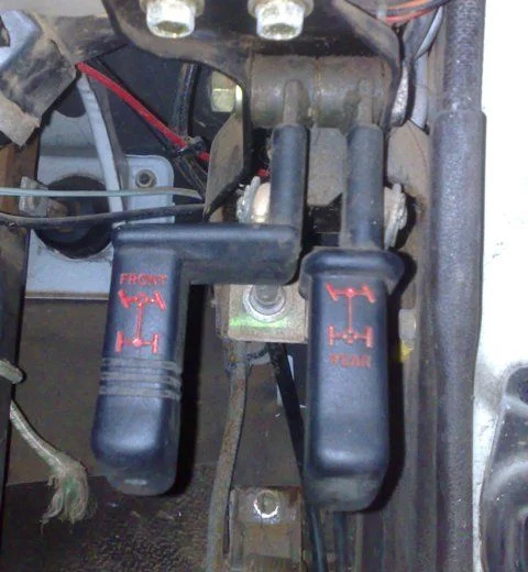

I have a 1989 HJ75 Troopy(with the 2H) that I'll be building up over the next year. The truck was my father's which he had since new! now that it has been handed down to me, I want to build a really nice troopy. I love this old truck and would never part with It! I have sooo many childhood memories! Needs a lot of body work done and a few other things here n there, but with some effort it could be a real nice Rig, it also has Toyota factory cable diff locks in it :D(included pic) and from what I hear they are highly sort after, is this correct?

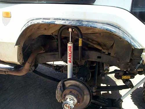

I would love to fit front shock hoops(see pic below) and have something a little special like Pro Comp MX6R shocks. What do you guys think?

Thats pretty cool having factory lockers and they are sought after;)

Pretty cool dad ticking the box for factory lockers option

I called pro Comp(after a week of no reply from my email.) and they couldn't tell me or email any info, shock valving etc....this was the tech department I talked to:bang: I think I go for a setup that uses the stock shock mounts to save my self a lot of messing around, It will be a lot cheaper as well.

Anyway, the 2H/cable lockers combination is almost unstoppable.
