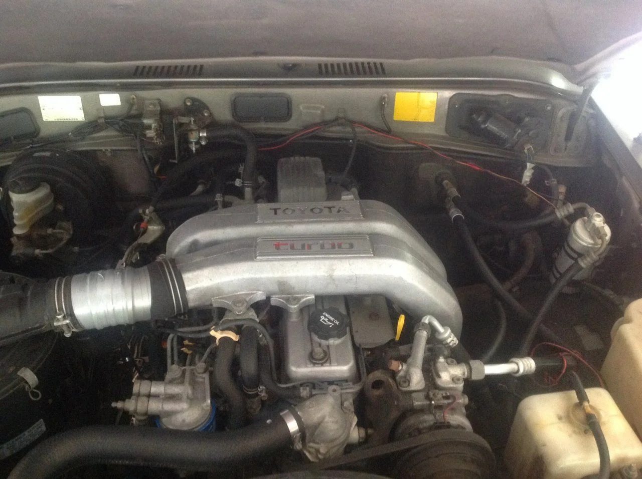

I did it and pulled the trigger on a couple hj61, bought a donor for the manual swap, and some associated gear for it, once complete I will sell off. The machine below is the primary rig that will receive all the attention .
As I know little about the 12Ht, other than they are great donk, my tech is very low at the moment, and need some of the subject matter experts to chip in and point me in the right direction.
I have some oil leaks, I have degreased the engine and watched the return of fresh sheens of oil, So question is where is the most common oil leaks within the 12ht general population and what are the general reasons / causes behind it.

Around oil cooler, intake manifold, Not sure if they are the leaks that is running down either side of rear of sump, or it could be either rear crank seal or sump gasket, also some sheen appearing below exhuast manifold, near turbo??

Thanks gents, I have degreased engine , the runs down either side of rear of sump is still there, so I am leading to believe the sump gu, or sealant is shot on the pan , or a main rear crank seal, learning towards a more a pan issue.
With regard to my intake manifold and exhuast manifold, I will need to get new gaskets in time as well.
SIDE PLATES!!!!
They're a prick to get to with the turbo and bell housing in the way, gasket goo and half a case will get you out of trouble.
Do not go down the rear main path until you've ruled everything else out and even then I'd say leave it until clutch time unless it's spewing out.
