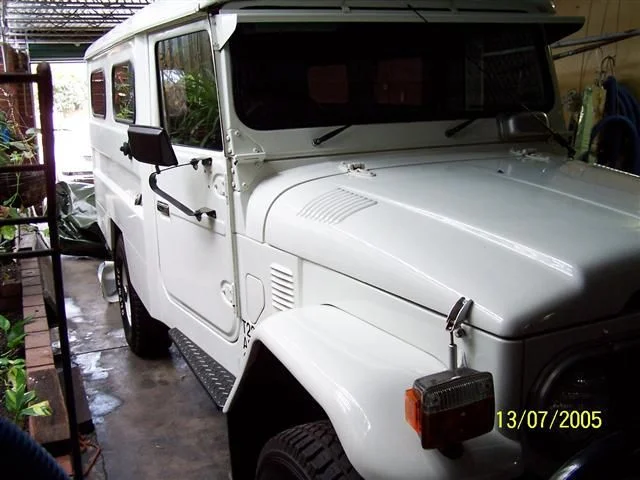

i like that sunvisor over the windshield...any better pics?
they used to have one like that in oz offered thru Theiss
looks like some fiberglass replacement panels
Nearly all were built by Arkana Body Builders.
This is one of their troopies with a better pic of the sun visor
