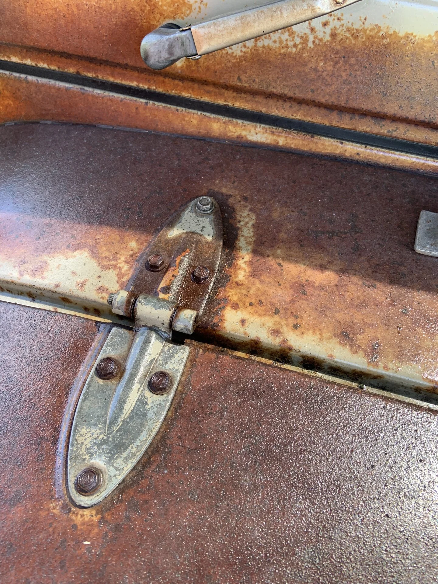

Hey guys anyone know if the bonnet pins punch out from the inside out or outside in?
just replaced the door bushes to stop the drop now doing the bonnet.
Since you can unbolt them from both sides, I assumed they were replacable as a unit and so probably welded somewhere.
I guess you'll easily see once they're in the vice?
Would love to see photos of the process followed in each case

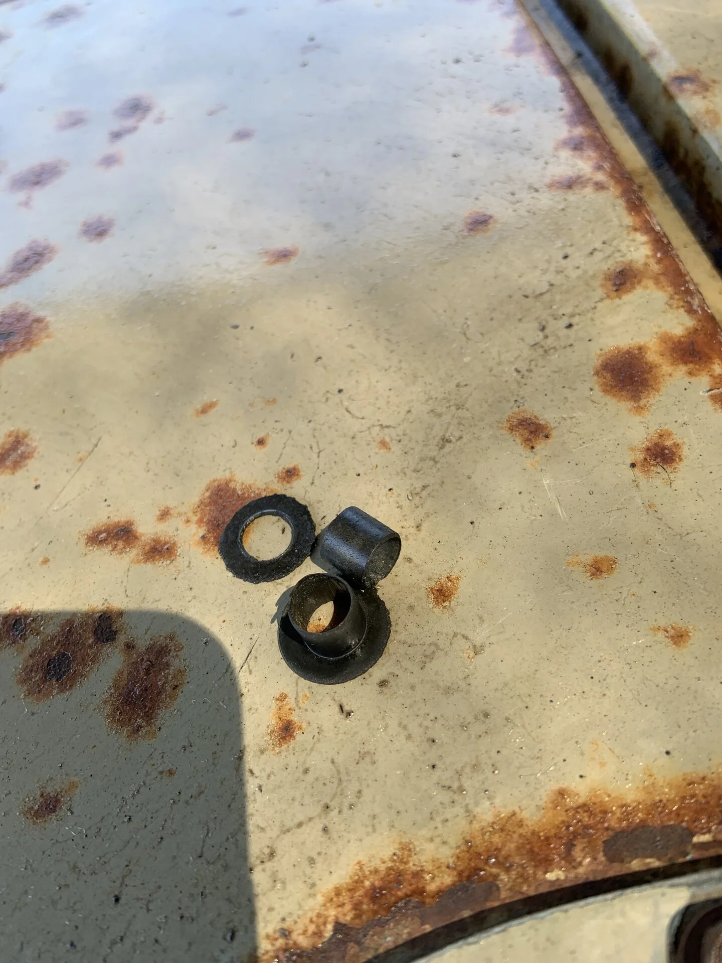

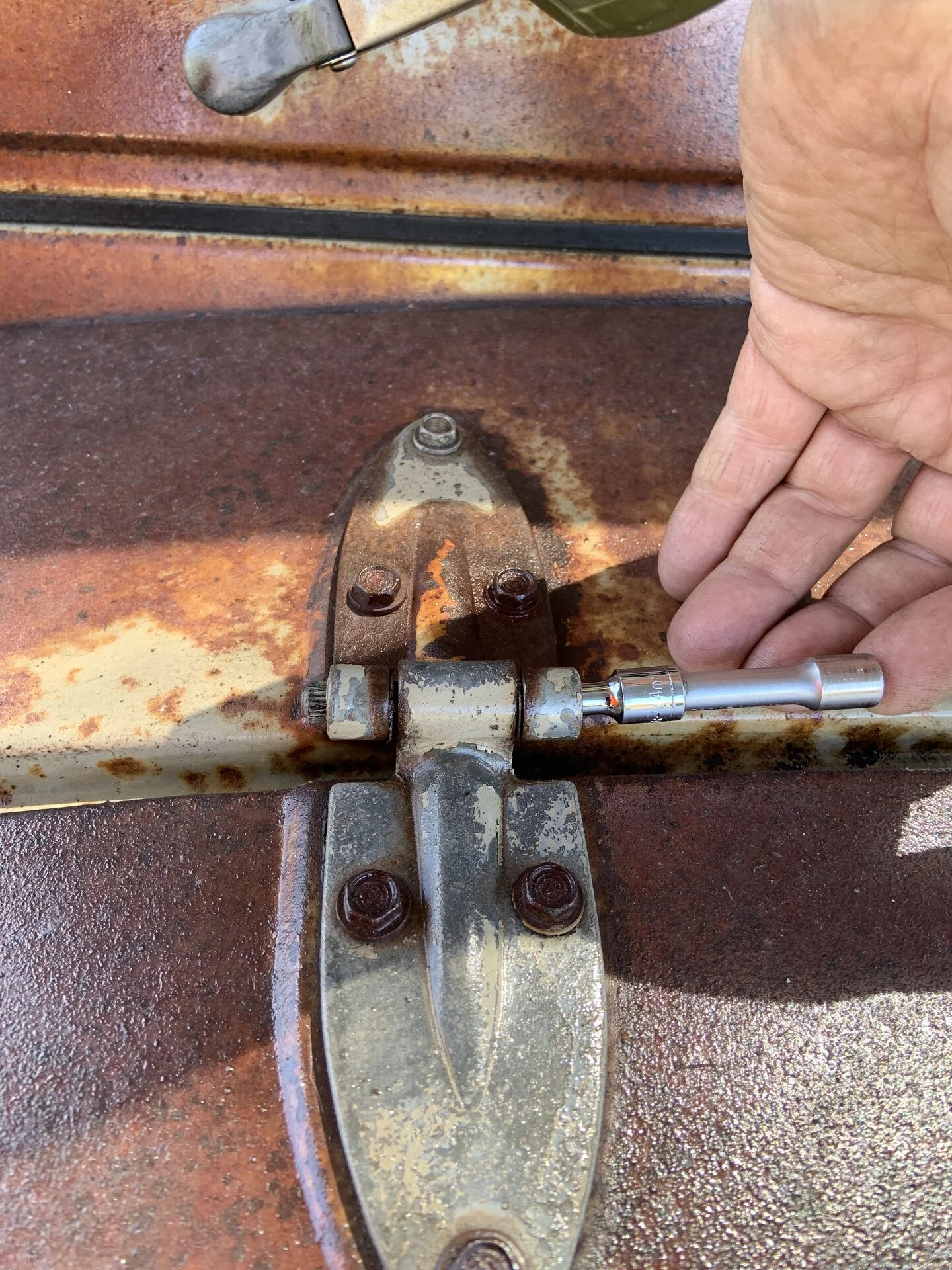

The process is the same as the doors, don’t take them off…. Just knocked pins out and put bushes in and place pins back in ….. fixed 👍
These are the hinges
Old crusty ones
Just used a small socket on extension bar and punched it through

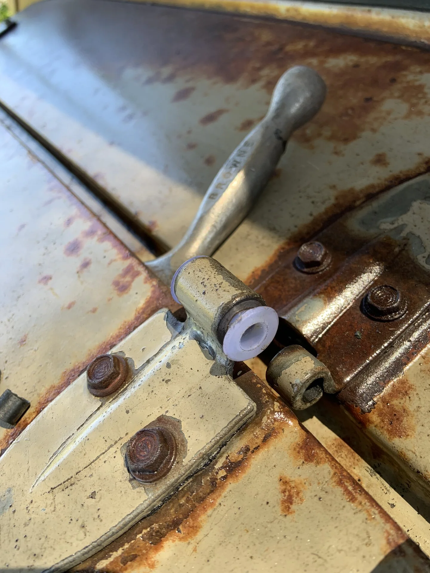

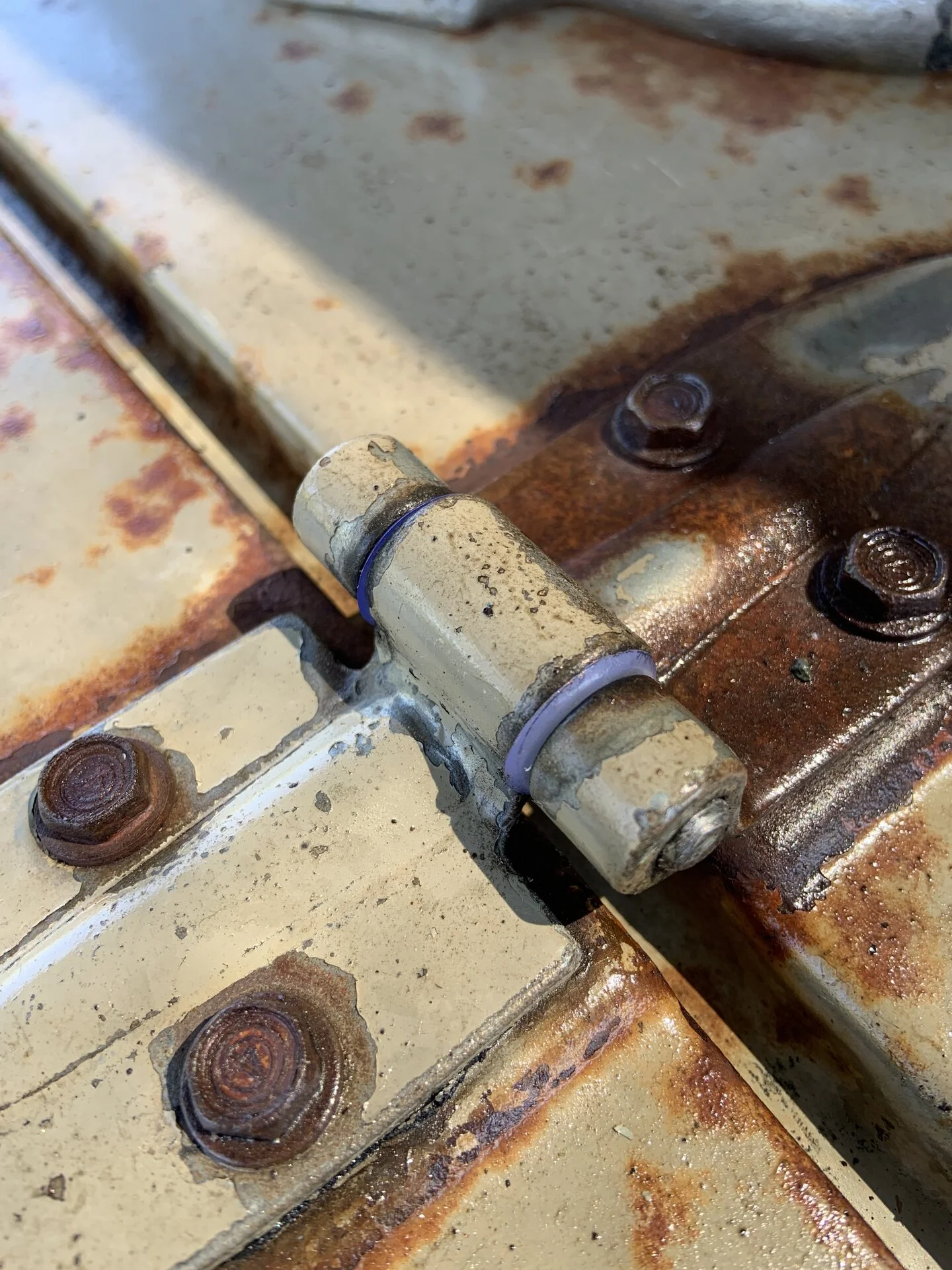

Place new bushes on and tap in with a mallet
Bit of grease on the pin and drive it home, job done ✅
