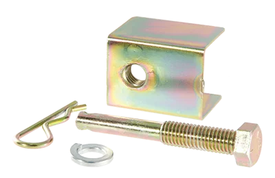

Good initial results with this one by Curt. I might attempt slightly enlarging the the cotter pin hole to slip in a light duty padlock. Spotted some other tool-less types and a cylinder lock model on their website recently.
Shop Anti-Rattle Hitch Pins & Clamps - https://www.curtmfg.com/towing-accessories/security/anti-rattle

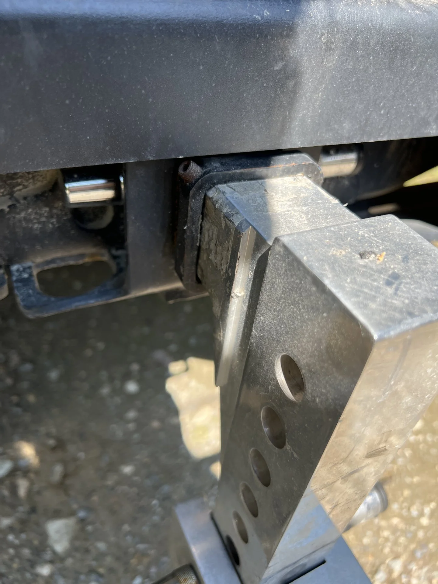

How are you attaching the U bolt version to the factory receiver? I have one and my feeble brain couldn't figure out how it attaches with the OE style receiver setup
Me either... our 200 series needed a longer U bolt.
Don't know who has them.
I have Dobinsons bumper .
Any trailer supply or trailer builders in your area? Should be able to fix you up. Or a spring shop will bend you whatever ubolt you need for very cheap.
