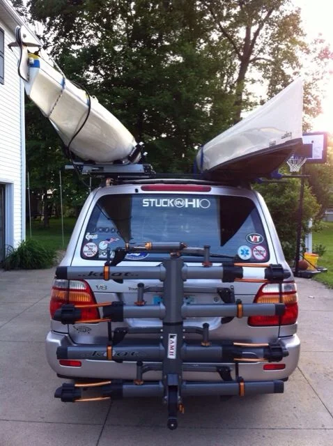

Last year purchased a Kuat NV (1 1/4 inch) for the Maxima. Got a hitch adapter for the NV so it could be used on the LC too. Have to say it works really well. Tilts away so both the glass and gate can be opened while loaded.
The fit and finish on the Kuat is great.

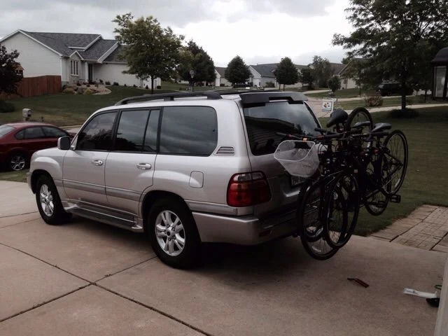

I don't have a tray style, I have the Yakima Double Down 4 (the bikes' down tubes rest on two forks), regardless, I think a hitch extender would work for other style racks. The extender I have is here: http://www.rampconnection.com/Trailer-Hitch-Extender-HE-3-3.html
although there are variations elsewhere on the internet (and likely cheaper). This does push the bikes further back from the truck (in my case about 8 inches), but that is the idea, right? You may need a different extension length depending on your rack and I can't guarantee that this would work for other racks - the best thing to do is measure how much clearance you need with the rack on the truck. I would assume that going too far back would not be a good idea and that the extra length may put additional stress on the receiver, but it worked for me! I keep the extender attached/locked to the bike rack all the time, so I don't have to install the extender each time; it's like it is part of the rack. I can open my liftgate and tailgate no problem and access the cargo area no problem!
