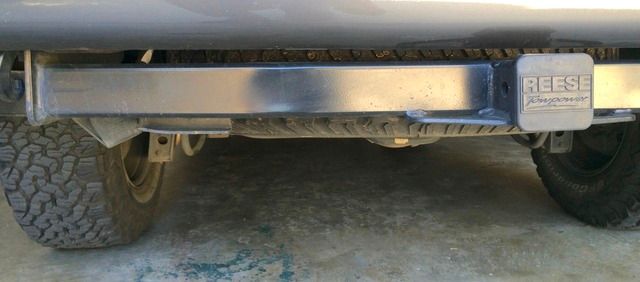

I was looking at the back end of the 100, thinking about what it'll look like with a high-clearance bumper and without the receiver hitch - and all I saw was that spare tire.
The resonator and tail pipe can be addressed by an exhaust shop, e.g. rerouting, etc. But that spare... that damn spare. I really would like to keep the tire in the factory spot - the truck sees a whole lot more daily-driver duty than trail duty. But, clearly don't want to use the side of the spare tire as skid plate.
Anyone done that - install a high-clearance bumper and leave the spare under the truck? Is it as susceptible to damage as I'm thinking it's going to be?

I think you're correct that any of the high clearance designs will leave the spare ridding pretty low. I think with a very narrow spare and the minor bump you can get from raising the spare would still leave it hanging low. I think for the spare to stay down under you're better off with the more conventional bumper designs. For me a high clearance rear with the spare on the swing was a huge improvement over tail-dragging the stock hitch all over the place.

Crawled under the 100 to look at doing the spare tire mod... But the charcoal canister (thanks SmoothLC) is in the way.
Looks like I can move the mount up about 1/2". Hardly worth the effort.

What about making a 1/8" steel plate cut to the diameter of the spare? After raising it with the mod (for those w/o A/C there) and cutting the exhaust so it comes out in front of the rear tire, I think one would have a fair balance between clearance, protection for the spare and stock functionality.
I was even thinking of eliminating the spare cable lift completely. Since I can get under there and catch the spare as I lower it, welding a heavy-duty stud in the right place could get the spare even higher and, from my assessment, get it to a complimentary departure angle. To do this right a cross beam w/ the stud on it would have to be welded into a good position using the frame rails as the main brace points. A couple chains with appropriate mounting hardware could be added for redundant security. Tack on the aforementioned steel disk and you have the stock look with a meaningful percent of trail functionality.
While it's a lot of trouble and expense, I want as much expo/trail capability as possible without sacrificing day to day function (not having to use a swing out to access the rear) and low-profile looks. Thoughts?
I think the 1/8" plate (or HPDE, aluminum...) is a solid option - just using the wheels's stud holes to mount would do it. It wouldn't take a lot to keep the tire from getting cut. But, you'd want to give some thought to drainage - that plate snug to the tire - could (would) collect a lotta mud/crap.

Crawled under the 100 to look at doing the spare tire mod... I guess it's only for trucks without rear AC.
That is strange, I have rear AC and I don't have any of that under my hundy.
Charcoal canister . . .
