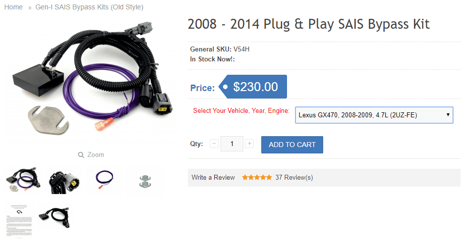

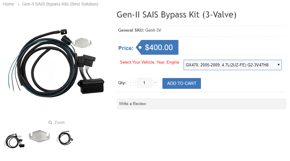

What is the difference between the gen 1 and gen 2 kits? When I look at the listings both of them say that they will work with my 2008 GX470. I obviously don't want to pay an extra $170 unless there is a good reason to do so.
View attachment 2560191View attachment 2560192
The Gen-I units only prevent the system from running. They can only address mechanical codes like the valves stuck open/closed and pump stuck off codes by themselves. For the electrical fault codes or those caused be damaged pressure sensors they need extra kit add-ons. The Gen-I V36H kits for the 05'-07' vehicles connect to the MAF/IAT and the the Gen-I V54H kits for the 08'-12' vehicles have additional connections to the ECT sensor. The Gen-I units all use a starter relay sense wire to trigger the module whenever you start the engine to make sure the unit prevents the system from running. As an example of codes that Gen-I kits need kit addons for; codes like P0418 and P0419 for bad air pump motors or damaged air injection control drivers would require a kit addon called a Pump Proxy Pack (PPP $155) and every once in a while a new air injection control driver. Because the Gen-I kits only prevent the system from running it is still possible to get electrical fault codes in the system later on and need kit add-ons at that point, the most common is the P0418/0419 codes because water settles in the pump motor and corrodes them out of spec.
The Gen-II units are completely stand alone and emulate the entire system by replacing the factory air injection control driver(s) and connect to the pressure sensor(s). There is no connection to the MAF/IAT, ECT and no starter relay sense wire to clutter the engine bay. On a GX/LX/LC 470 this is done with the GenII-3V which also connects to the two VSV harnesses on the top passenger side of the intake manifold and has a three wire whip that goes directly to the ECM to tap into the pressure sensor (there no way to make it plug and play without pulling the intake manifold).
The Gen-II kits can take care of ALL of the codes mechanical and electrical except those caused by damaged pressure sensor(s). They can take care of the electrical fault codes P0418/0419, P0412/0415 and there is no way to get them later on either. The Gen-II kit also prevents having to replace the factory air injection control drivers with new units or replace the air pump fuses if they are blown. The only kit add-ons we have for the Gen-II kits are pressure sensor replacement add-ons which none of our kits can take care of.
The Gen-II is simply the most comprehensive solution for current trouble codes and the prevention of future codes. It is completely stand alone, looks like a factory part, does not have to manipulate the engine temps, does not have a triggering requirement and will even let the secondary air system's emission monitor show ready/complete.
Both kits include block off plates which are still important parts of the solutions, Free USPS Priority Mail shipping, Limited Lifetime Warranty and full Technical support.
Below is a basic comparison of the two kits that cover most instances of the system failures. There are exceptions where certain codes are caused by damage pressure sensors, wiring or even in an extreme case a damaged ECM. Because there are so many specifics to the system we prefer to talk to our customers to discuss the vehicle and the most effective solutions for them.

WOW! Excellent response and thank you for taking the time to answer my question so thoroughly! So I understand fully, the Gen II kit emulates the system and prevents all future codes except the case of a failing pressure sensor which must be replaced. It will allow the SAIS system to show ready on OBD. The downside of the GEN II is that it requires removing the intake to install and requires soldering 3 wires to the ECM under the dash (as well as the increase in price). GEN I doesn't require removing the intake or soldering but can result in future issues and will not allow the emissions to show as ready within OBD? That said and given that the SAIS in my truck is still working with no errors what would you recommend?
None of our kits require removing the intake manifold for any reason. Unlike the GenII kits for the other engines the the pressure sensor we need to connect to on the majority of the 4.7L vehicles is underneath the intake manifold. This is the reason for the 3 wire connections at the ECM so you don't have to remove the intake manifold to connect to the pressure sensor. The ECM is really the only place to identify and be able to make the connections to the correct wires. I think you have the rest of it. For simple prevention it is hard to beat the V36 if you have a 05'-07'. For the 08 and newer I would still recommend the Gen-II to avoid the potential side effects of having to mess with the ECT.
