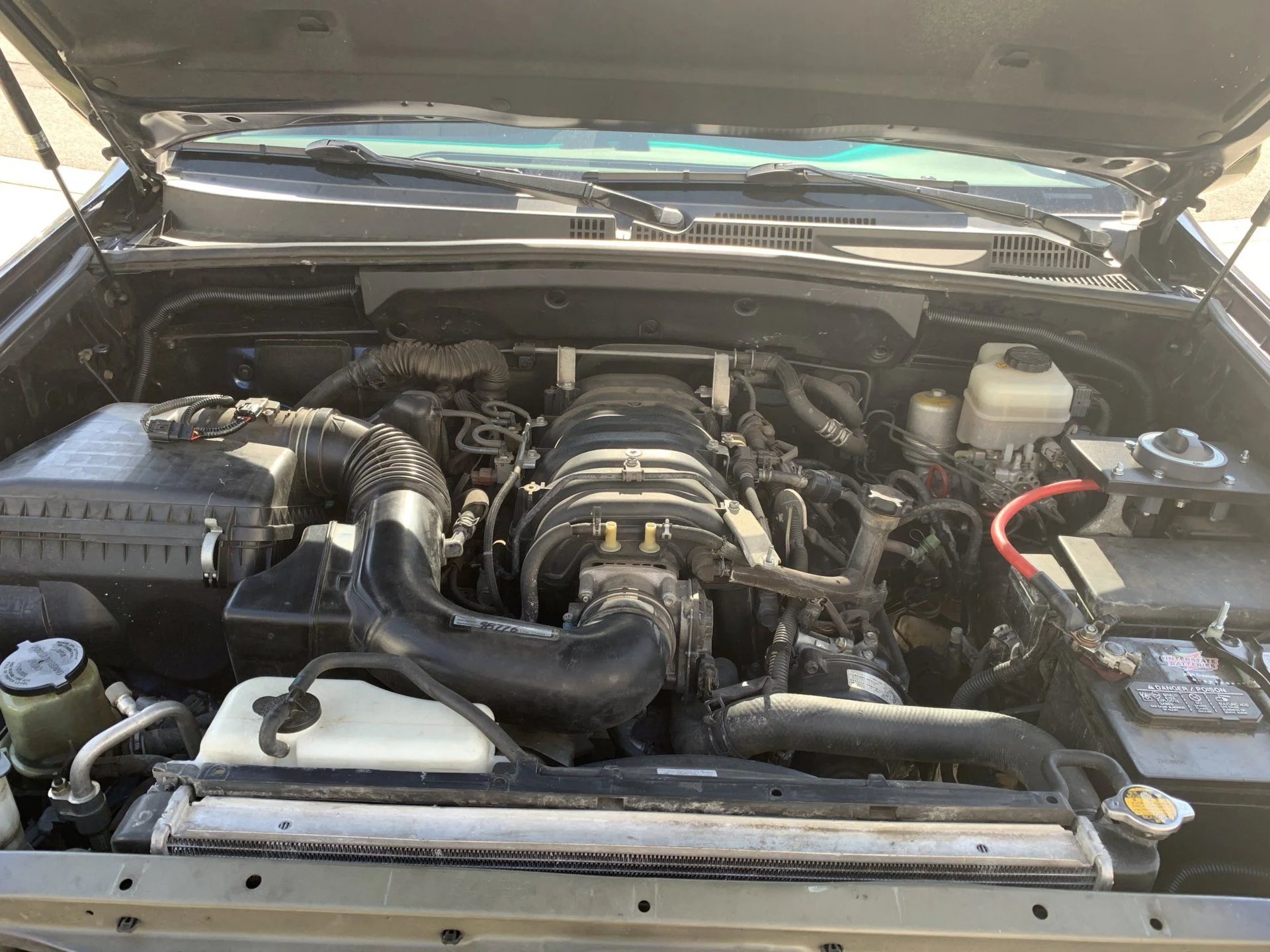

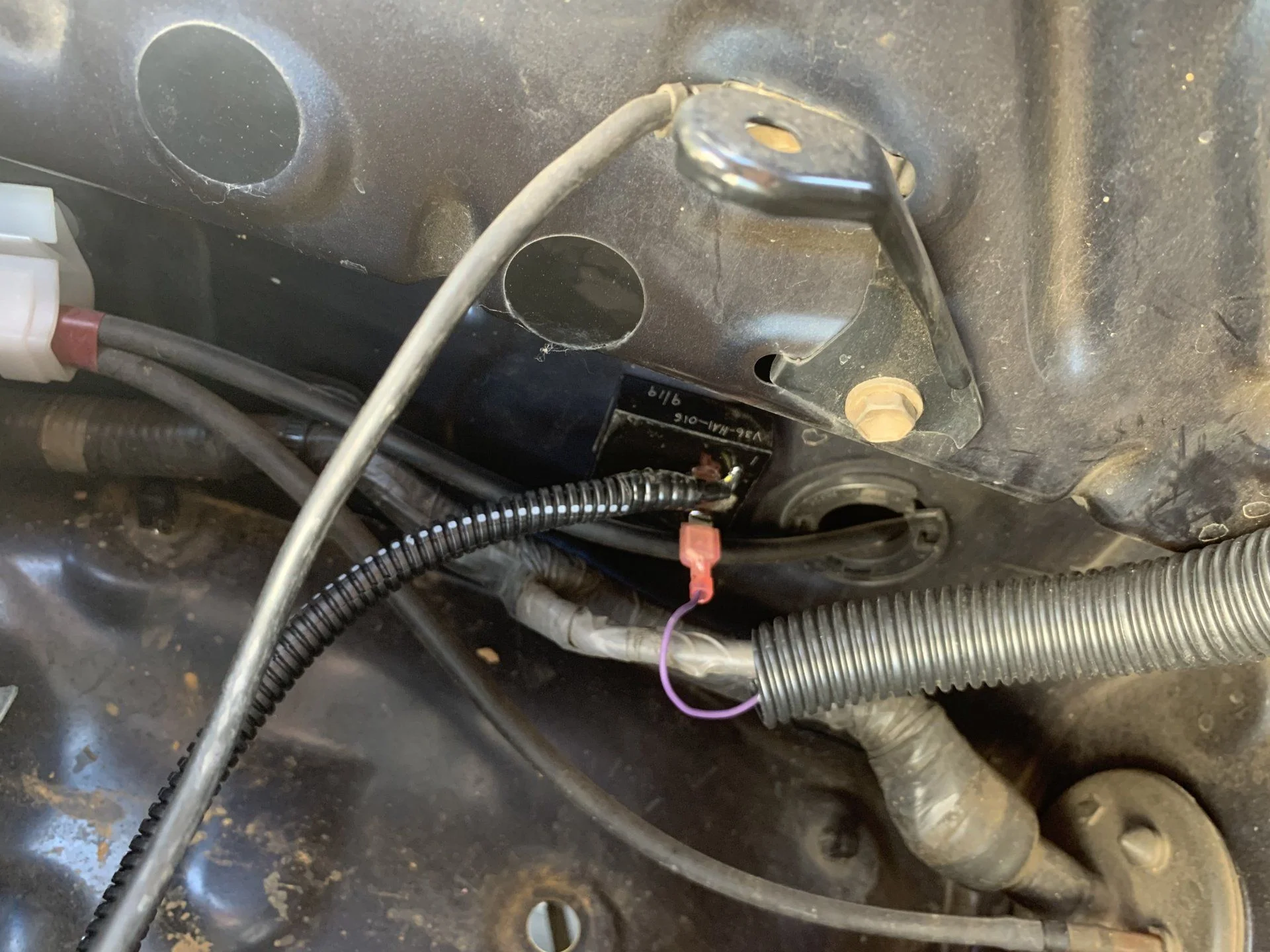

I installed the Hewitt Technologies SAIS bypass kit today and it went very smoothly and without issue. I didn't have an issue with my SAIS but I thought this would be a good preventative measure. Here are pics of my install. I ran it along the existing wiring on the firewall and then covered it up with split loom. I installed the module on the inner fender instead of on the air box as it is completely out of the way from everything and close to the wiring harness. I did not remove the nuts from the manifold but backed them way out and simply slid the plate in from the side (I hope that is the right way to do it). I hope this helps others.

Yes it came with instructions with color pictures. The hardest thing was routing the purple wire in a fashion that I was happy with the appearance. You can't see mine because I used split loom to hide it. Otherwise it is a greyish wire that follows the firewall and goes behind a black plastic holder. You can download the instructions from their site Hewitt Instructions.
