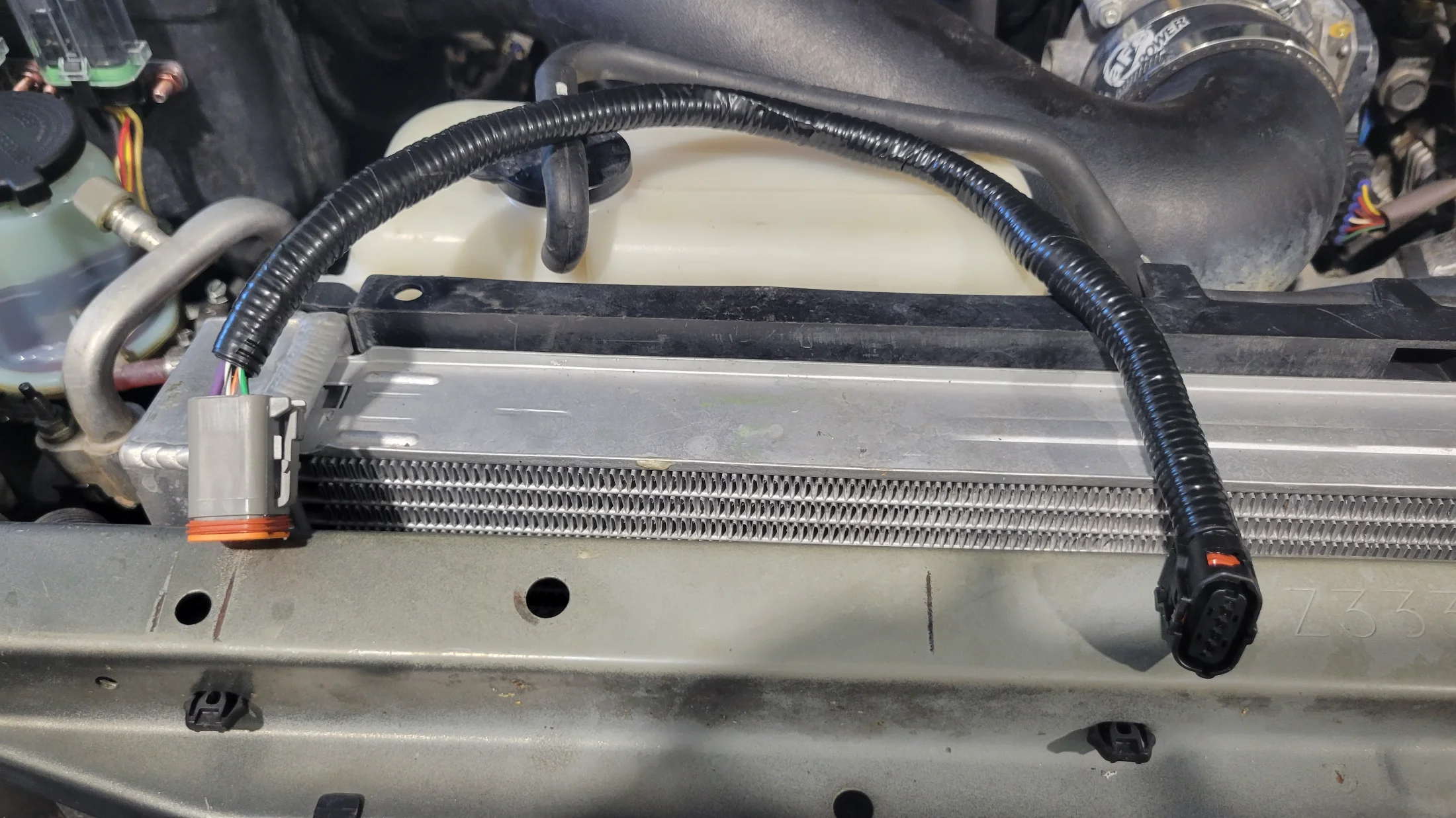

It could be your MAF connector myself. I've had the OEM one go bad - and then my splice job on the replacement to bad later one. A bad MAF plug will cause all sorts of codes and issues. Others have also had this problem. I've since spliced in a new one, including making the connector easily replaceable by adding a Deutsch connector to the OEM harness, then another Deutsch connector to the MAF pigtail.
Interesting Rednexus. My MAF plug was broken and taped together. That could be my problem.
Do you have the part #'s for the plug you used?
I used one from Amazon, but the pigtail was kind of short. Since your MAF wiring isn't pre-hacked/cut like mine, that might not be a big deal. You could cut off the OEM MAF plug, add a Deutsch connector in it's place, and then add a Deutsch connector on the end of the MAF pigtail. Or you can direct-splice, but the splices have to be really good to not have issues down the line like my rig did.
I'd post pictures of my new/improved splice job, but the forum is giving me a server error message. Here's the MAF connector.
EDIT: Server is working.
Here is the new pigtail I made:
And it installed. The Deutsch connector on the ECU side can be seen attached to my ARB twin mount.
