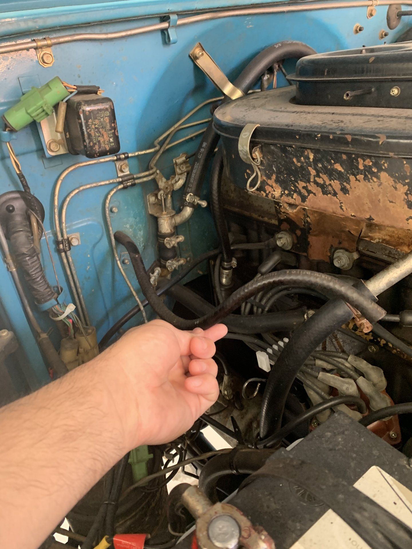

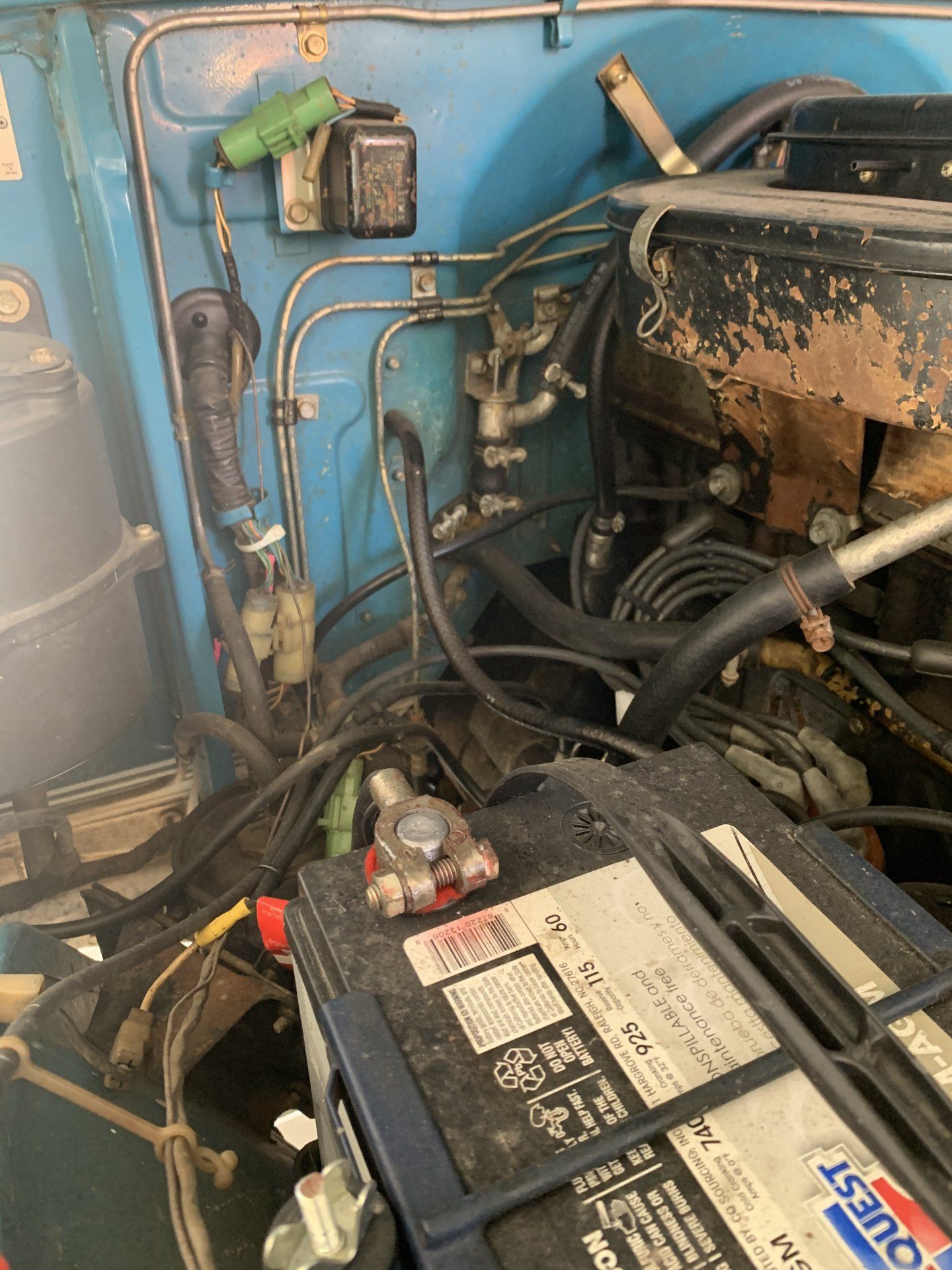

No idea, can’t seem to trace or find itpull it off and see what's it connected to on the other side of the firewall. Or does it pass through to connect to something
Thanks team! Found it on the top of the distributor cap. It's a 1978 FJ40V. Thanks again! It is now attached where it should be.That is attached to the air filter in the cab and the free end should attach to the vent on the distributor cap.
That was all you guys’ doing!Good work, take a look at filter end too... I had to take mine off and clean all sorts of mud out of it!
