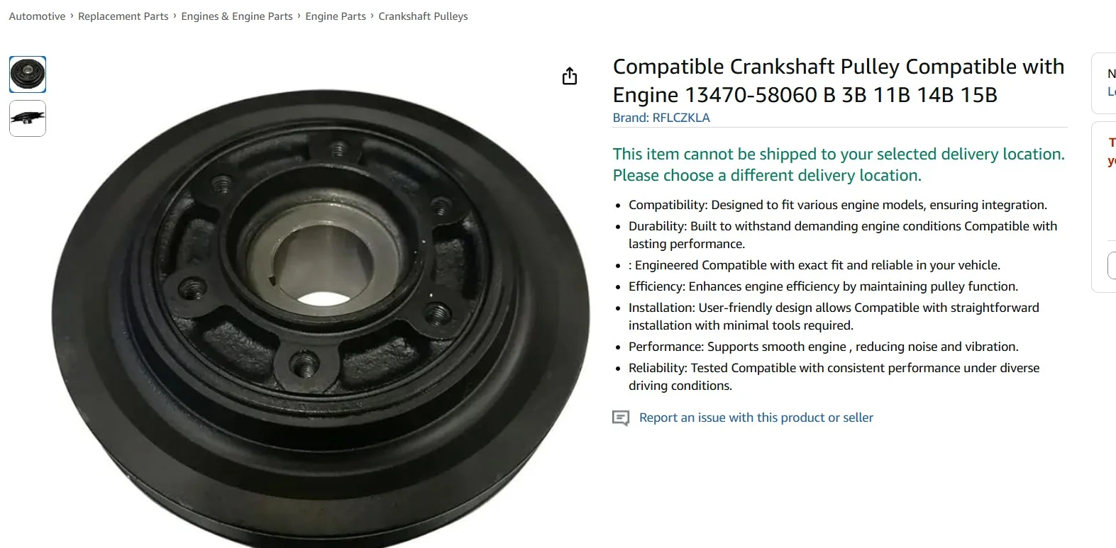

hello im planning on to put power steering on my bj41, it has factory ac but no PS, issues ive found is that the crankshaft pulley has only 2 grooves, and has only one center bolt in it, so you cant put the additional pulley for the PS, will this main pulley fit in my engine?

model - Bj41View attachment 3941905
2 grooves, you mean threads for the extra pulley mounting bolts?
Yes, you can change it to that model.
