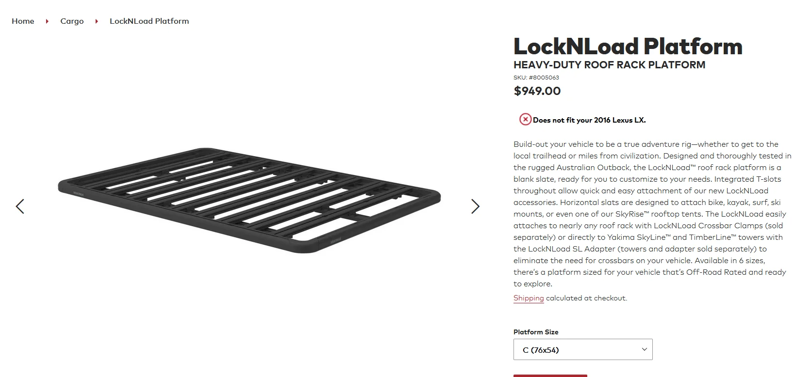

So I'm half considering a different path altogether. And that is running Yakima Sightline Mounts on the OE flush rails and then using a large LockNLoad platform on it when needed.
Advantages:
- Only run platform when needed for trips. Saves drag and noise when not needed. Able to keep the roof clean.
- In the winter can run Yakima ski racks on crossbars with them pushed outboard for ease of reach.
- Can quickly mount Space Case when needed.
- Vehicle can be quickly converted to a slick top for highway use.
- Ease of install. Not dropping headliner.
- No risk of water leaks. OE rails stay in place.
- Can enjoy sunroof when platform is not on.
Disadvantages:
- Large potential for wind noise with platform due to combo of crossbars and platform.
- More expensive.
- Need to find alternate mounting points for scene lights, antennas, etc.
Potential Problems:
- Strength of SlightLine clips in overland application? Will they pull off of the flush rails? Should I run four crossbars instead of two?
Thoughts on any of this?

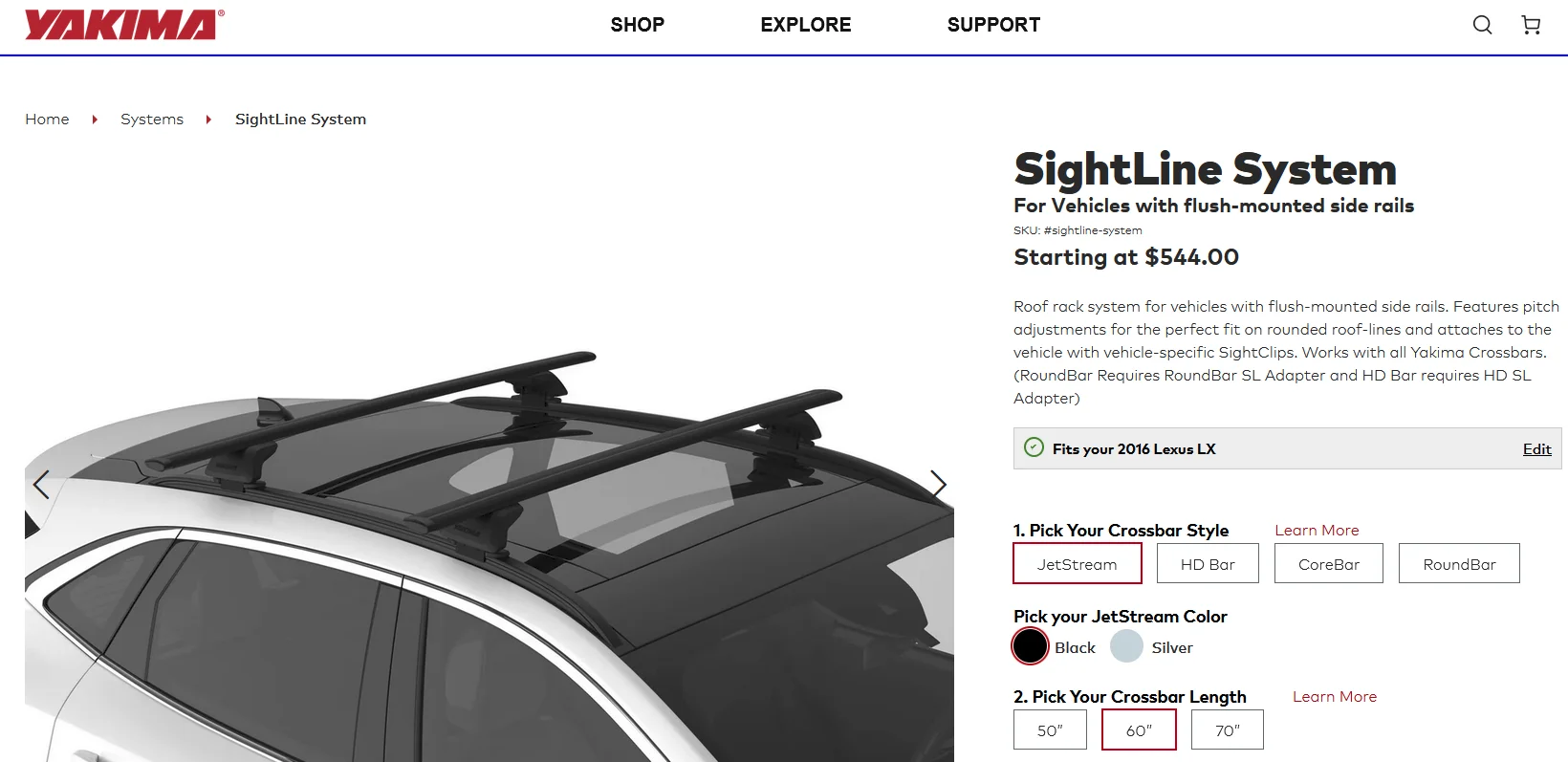

Thanks @Sandroad. Any thoughts on the grip strength of the sightline mounts on the flush rails?
Good question. The Skyline roof system on my RAV4 attaches securely to the flush rails with vehicle-specific Landing Pads. I don’t know the attachment for the LC/LX, but I assume it’s strong enough up to the rated load.
Same with our Yukon XL. I'm not concerned at all with the gravity load, but rather retention over rough terrain where the rail clamps are subject to negative loads. I don't intend to have a heavy RTT on it, but will have a 75lbs OZ Tent + the usual accoutrements, so probably 150-200lbs live load.

It would be great if there was a flush clamp for those stock rails. The way the tower/clamps add three or four inches puts the load high.
We have the SightLine clamps on the Yukon XL and they’re pretty short. I’d say maybe 2” from top of OE rail to bottom of bar. They’re not like the old towers that are really high.

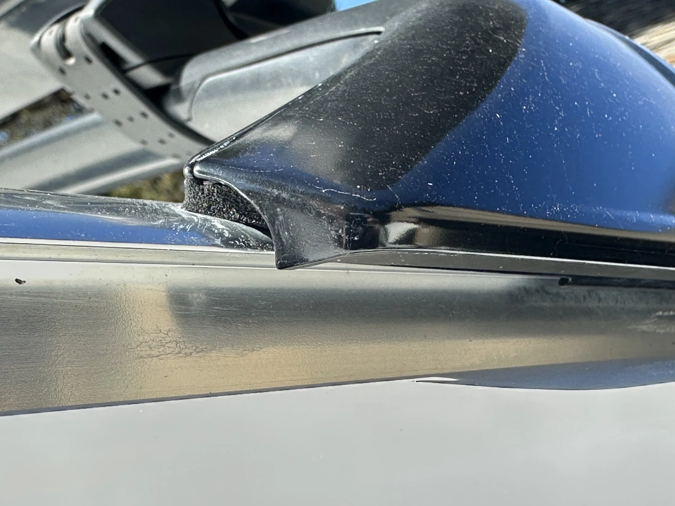

I hadn’t looked at the LX’s rail that closely. It has a much more pronounced lip than I had remembered on the GM. I’m much less concerned of it pulling up and off.

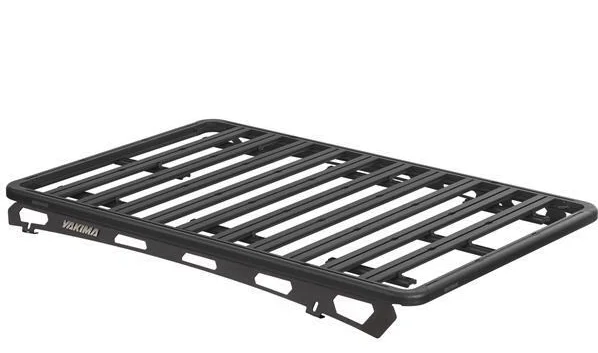

Another option is the RuggedLine from Yakima. For whatever reason we don't get it here for the 200, but it's available in Oz. It's the same LockNLoad platform but using rails down the side. We can get the same thing here, but branded as the Atlas platform through Ironman 4x4. They currently don't have the rails on the website, but I did confirm they're in stock. It's a cool option in that it gives you some choices in platform size should you want it to stick out more. I did this with my FrontRunner by ordering different slat widths, though it took a bit of convincing before they would sell me the front and rear end pieces.
I'm not sure it the right thing for me as I like the idea of keeping the factory rails, but it looks like a really good solution.

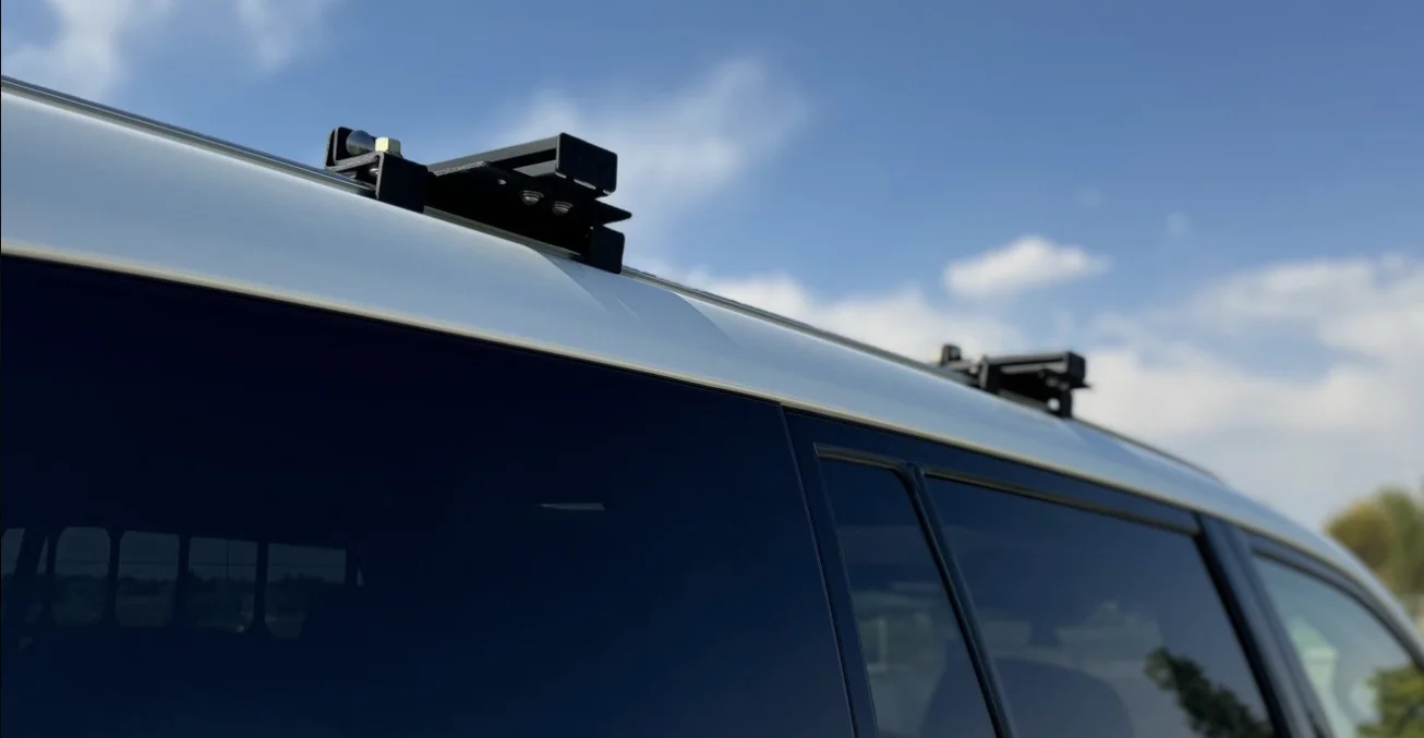

lx570 brackets — Gamiviti - https://www.gamiviti.com/lx570-brackets is the solution we came up with. Not as sexy as some of the others but definitely clamps down and supports the cross bars when installed correctly, you can see the vid on the website.
