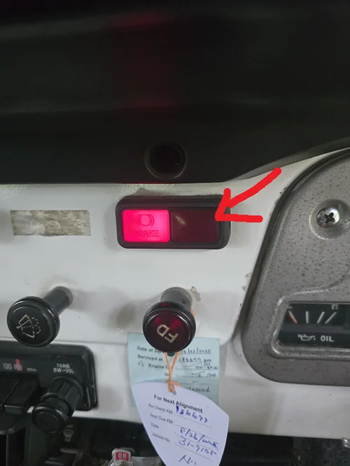

Guys i have a 1982 BJ40 land cruiser. fuel preasure gauge is not working. im wandering what is this light its not working. and not hooked on. is it oil preassure light ? how can i fix it. engine is 2B engine.

No clue. Maybe a manual will help free downloads Land Cruiser Factory Service Manuals (FSMs) - https://www.cruisercult.com/factory-service-manuals
There is a diesel section around here somewhere to look/ask in too.
Any loose wires near the light - color code on the wire will help with a wiring diagram. Look on the engine block for the oil pressure sending unit (round can golf ball size with a wire and connector to it) again color code on that wire can help identify it.
Fuel pressure has a sender, connecting wire and a gauge if electric - any of which can be bad plus a connection threw the fuse block
on US spec rigs
1 light is for park brake
and the other light is for seatbelt warning
not sure on overseas rigs and diesel what it is used for
the wiring schematic should show it
99% sure it’s not for anything! My Colombian rig has the same light fixture. One side is parking brake, other side has no bulb/socket/wiring.
I looked mine up in the EPC, part number 81850-60200. Even new only has one side illuminated.
To answer your question, run your vin through the EPC and see what number comes out. Or check dash wiring. Or look up the wiring diagrams. All as suggested.

EPC is the electronic parts catalogue.
You’ll need your VIN, your region, and your model code. In Sri Lanka, you’re likely in the general region. Your VIN and model code are stamped on the vehicle VIN tag.

thank you i found it <3 i used chatgpt
