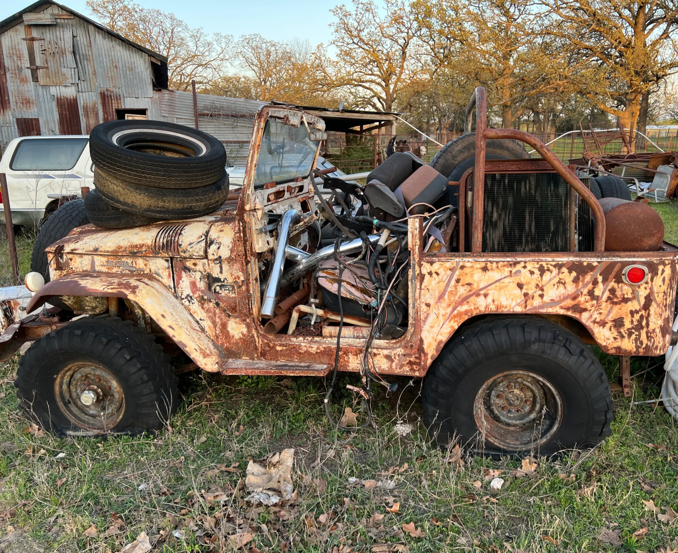

Hi. My name is Jack, and I’m working to save this 1963 land cruiser that was in my grandpa’s pasture. He collected toyota trucks all his life, and then he passed away a few years ago from leukemia.
I’m 21 and just starting out on this project. I’m hoping to work toward getting it running first, and then will work on it slowly as I have time and money.
The cruiser is in Oklahoma, and I’m in Wisconsin. If anyone has recommendations on a trustworthy place to help me get an engine and brakes in it, I would welcome suggestions. It currently doesn’t have an engine at all.
And if you have any other advice for me, let me know. I’m glad I found this group. Thanks.
Brakes are easy enough. You can maybe get kits for the wheel and master cylinders or just get new ones, shoes and drums. Shop the vendor folks up top. Engine well used ones are around, most will need work. A chevy 350 will worked with adapters.
Wiring is old and who knows what has been done to it by PO and mice. A GM one wire alternator with a volt meter would bypass lots of issues.
Download some free manual and start reading. Plus tons of build/repair threads here.
Start a log book and get a plan before spending lots of money/time
Good luck and welcome you are in the right spot
Perhaps would be get all that extra stuff out of there just so you have a better of idea of what you're working with, then get more pics and put them up here so everyone can help look it over from afar. Also see if there is anyone in any of hte local clubs that may be willing to come give you an idea of what all is needed first off.
Then make sure tires can hold air and get it onto a trailer and bring it back to you in WI. Do you have a designated space you could store and work on it in? That will make all teh difference. that is unless you're moving to its location in OK then skip bringing it back to WI...
Do you have much mechanical experience?

If I had a $5k budget-
Later model 40 disc front axle and rear axle
As late as possible running F engine/drivetrain
Adapt a budget 12 circuit aftermarket wiring harness
Scavenge Mud for seats and other smalls. Replacement suspension bushings. Bimini top.

I have to find a time to go visit soon and empty it out, from my understanding there's not engine and it's pretty gutted. I don't yet have a proper place to work on it but I have some ideas I'm looking into
Thanks for the insight, I will look into some Manuels and the other info you shared.

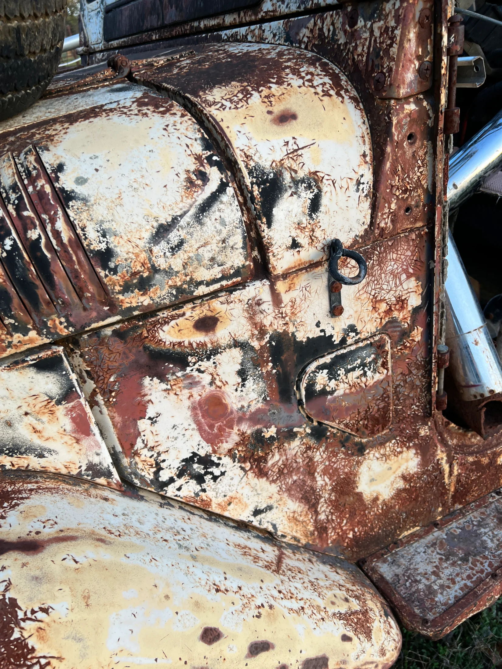

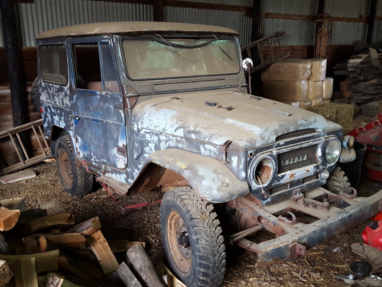

Money can't buy patina like that.
Sure it can. Bought an early 63 (62 production date with 1963 on the plaque on the firewall just get the floor. Ended up selling the cruiser I bought the floor for and just sits in my RV parking. Somewhere other than the southwest it probably worth something.
