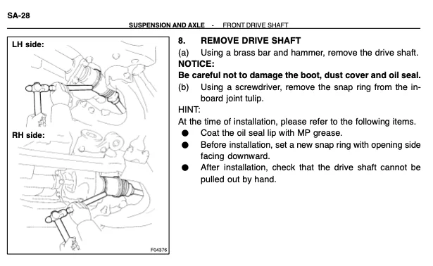

I've seen a few videos suggesting the snap ring orientation needs to have the gap in the ring at 6 o'clock position? and the FSM suggests this too.

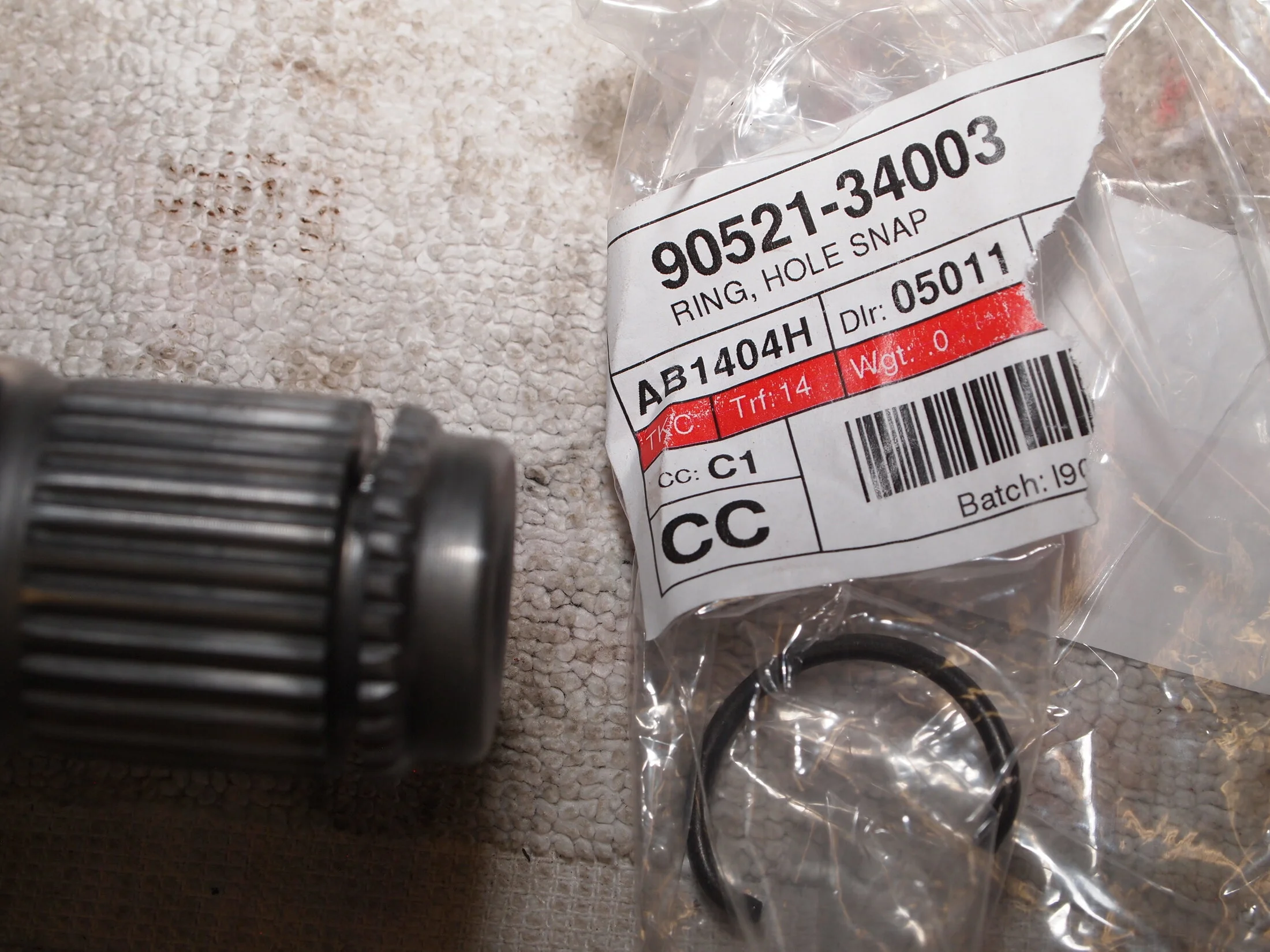

Do not reuse snap ring. 90521-34003 RING, SHAFT SNAP. FOR FR AXLE INBOARD JOINT SET.

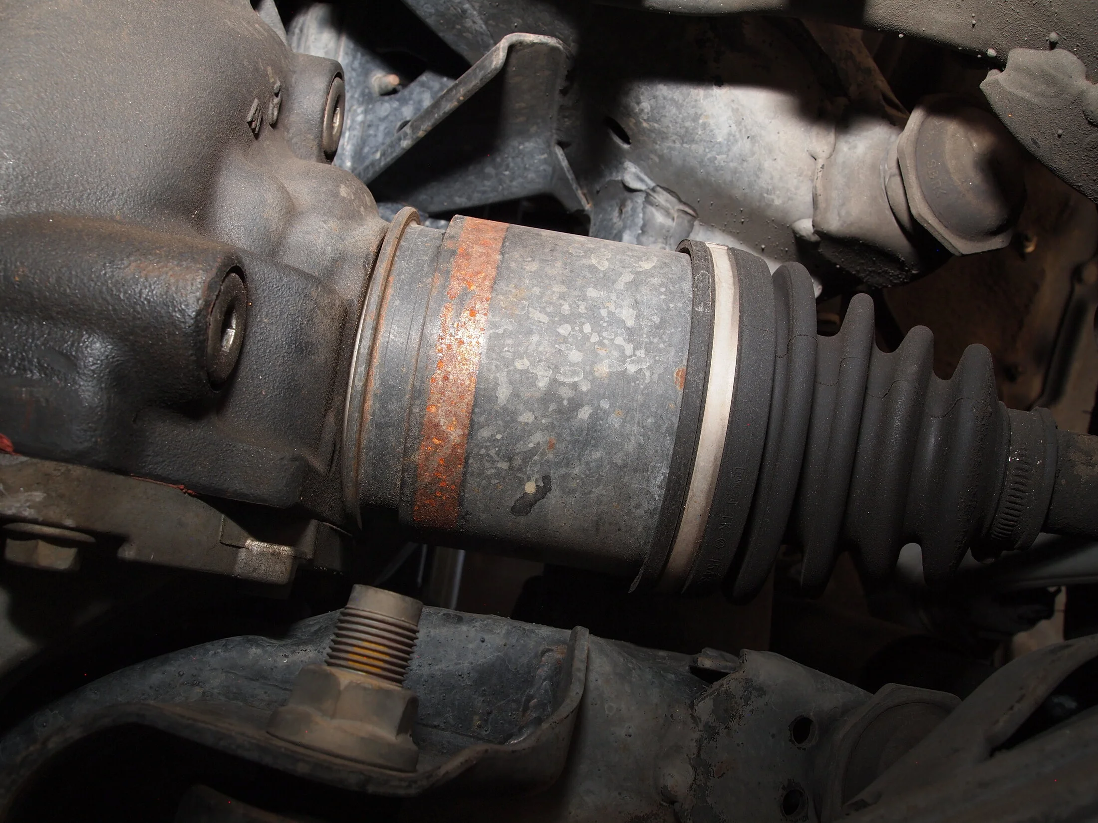

You'll know, when locked in. When dust seal (Shield) is in past edge of diff.
You test that it's in, by pulling outward, to see if come out (not lock in)
Dust seal
Properly seated FDS, dust seal is in past edge of diff.

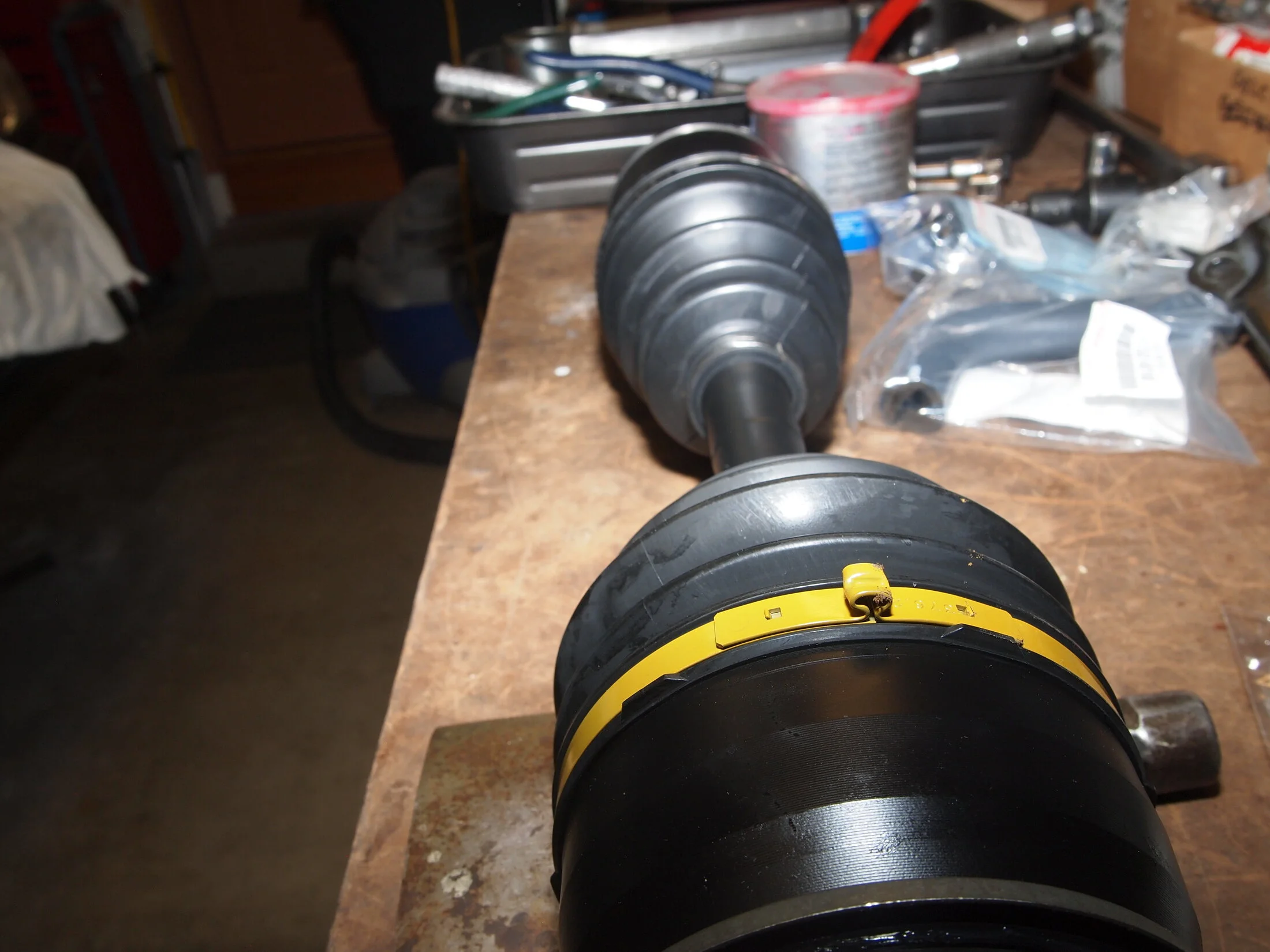

All are somewhat loose. All inner FDS snap ring, are made with the same span. All come on new FDS, loose and without any blemish (marring). They collapse as they fit into front differential. Do not try to pre collapse (tighten) or expand.

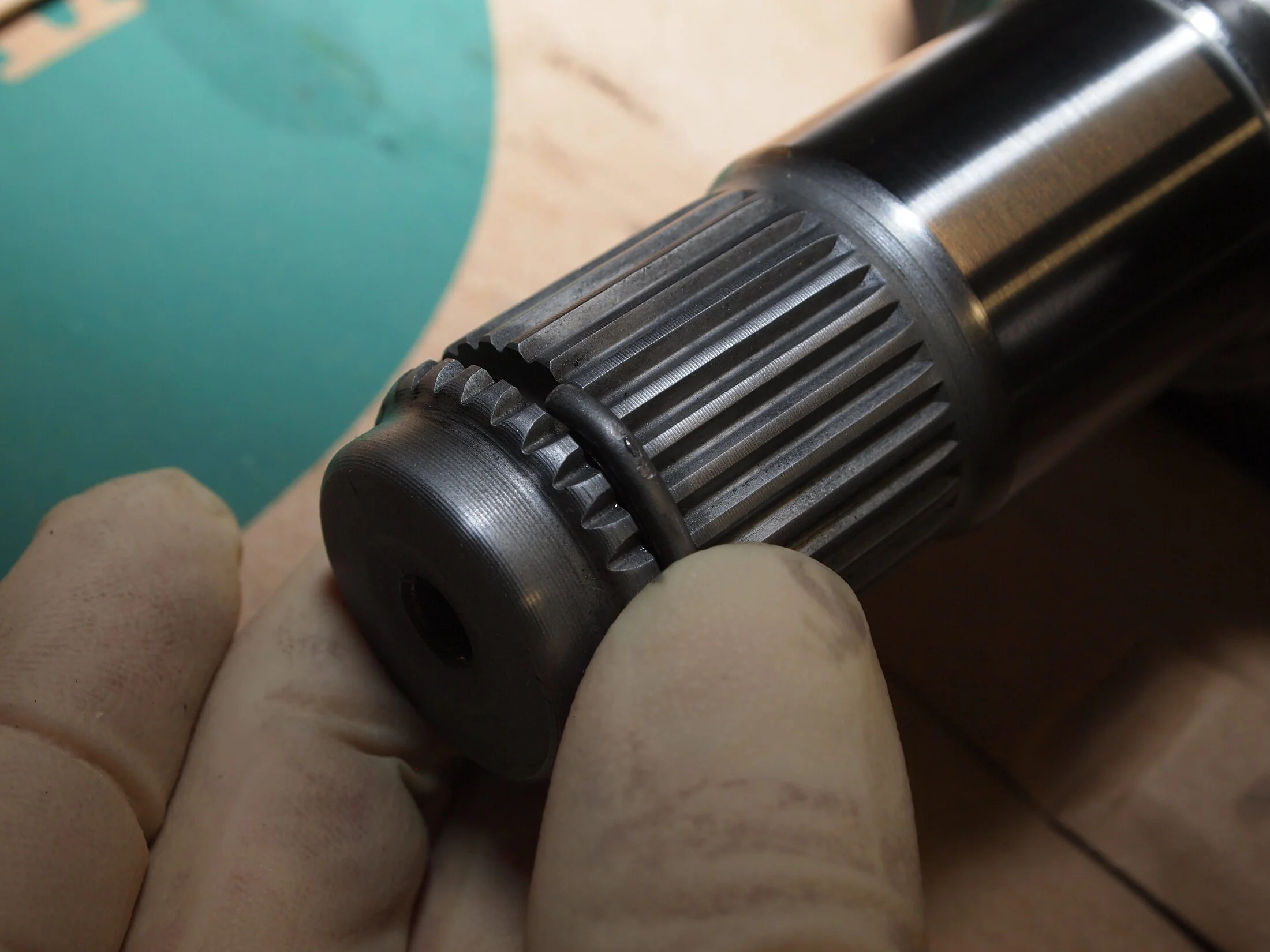

I add grease into groove to help hold snap ring in place, with open end down. I also center side to side, and make the top of snap ring, level with axle groove. I use a boot clamps' pinch protrusion, as my orientation point, like a sight on a rifle. Placing sight on top. Just as I mention in video..
If, I must replace snap ring, with new. I simply place on top of axle groove, open end down. Then press or tap down onto/into groove. "Tap" on with a plastic hammer, so that I do not mar the snap rings surface. I do not use a snap ring expander pliers. Once used they become marred and compressed. Which inhibits reentry into it's locking position and ability to lock in differentials.
We do not want to mare, expand or compress the snap ring. It will compress on it's own, just before it seats (locks) within differential inner groove.
Snap ring, is so loose a fit, it moves freely in all direction.
I orienting FDS with clamps pinch protrusion up as my sight. Helps keep my bearings, as to snap ring open end down

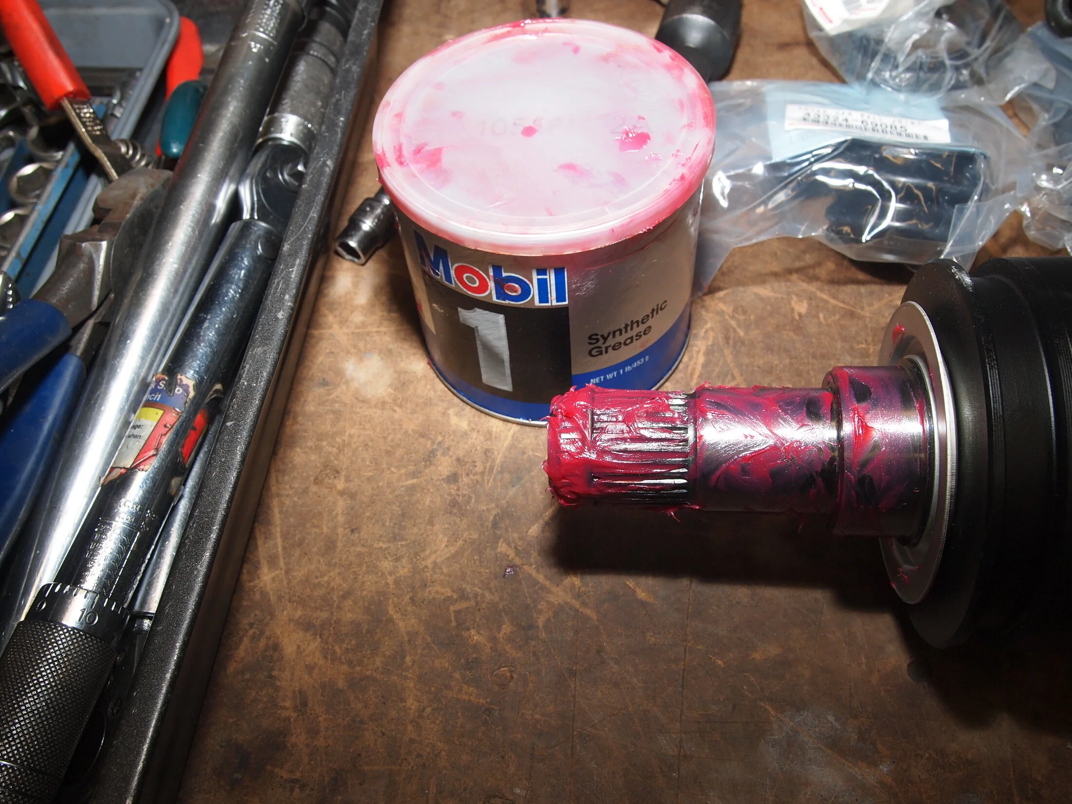

I use grease (not this excessive) in snap rings groove to hold it open end down. I also grease diff oil seals race (inner large area just before dust seal)
I grease diff side oil seal.

Do not get too excessive with grease on inner axle. As it is going to mix with grease lube. Too much grease in gear lube, my result in excessive foaming.

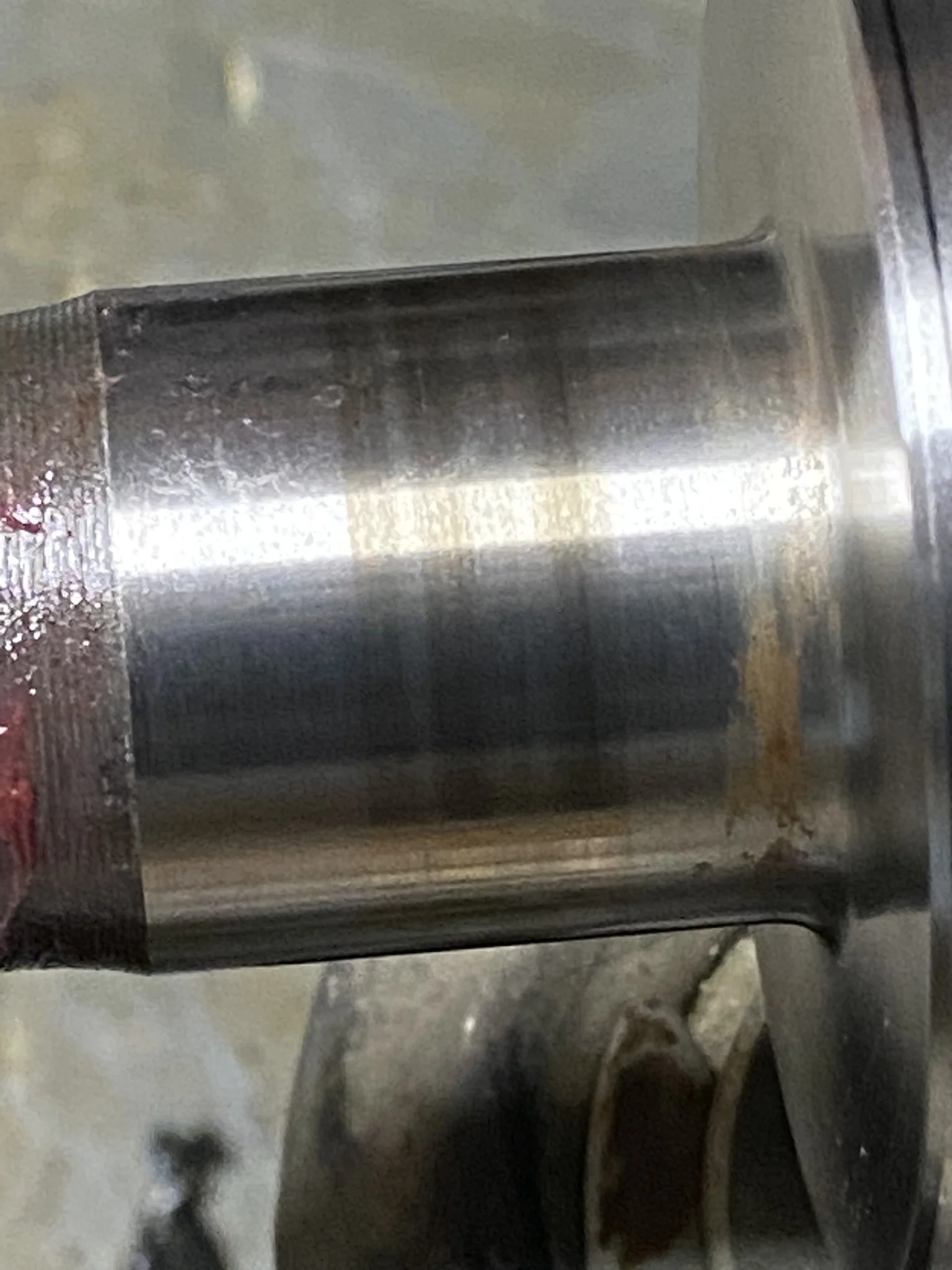

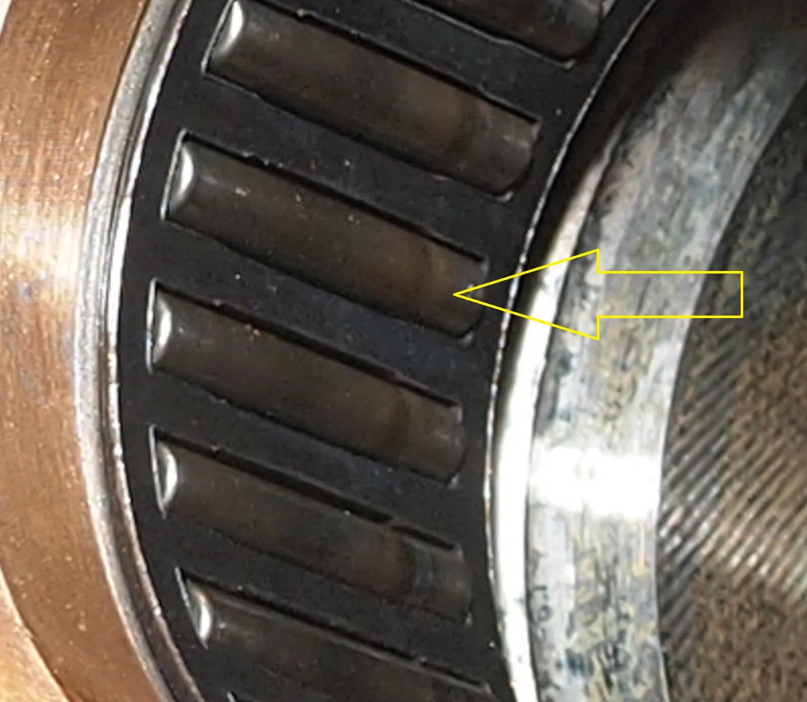

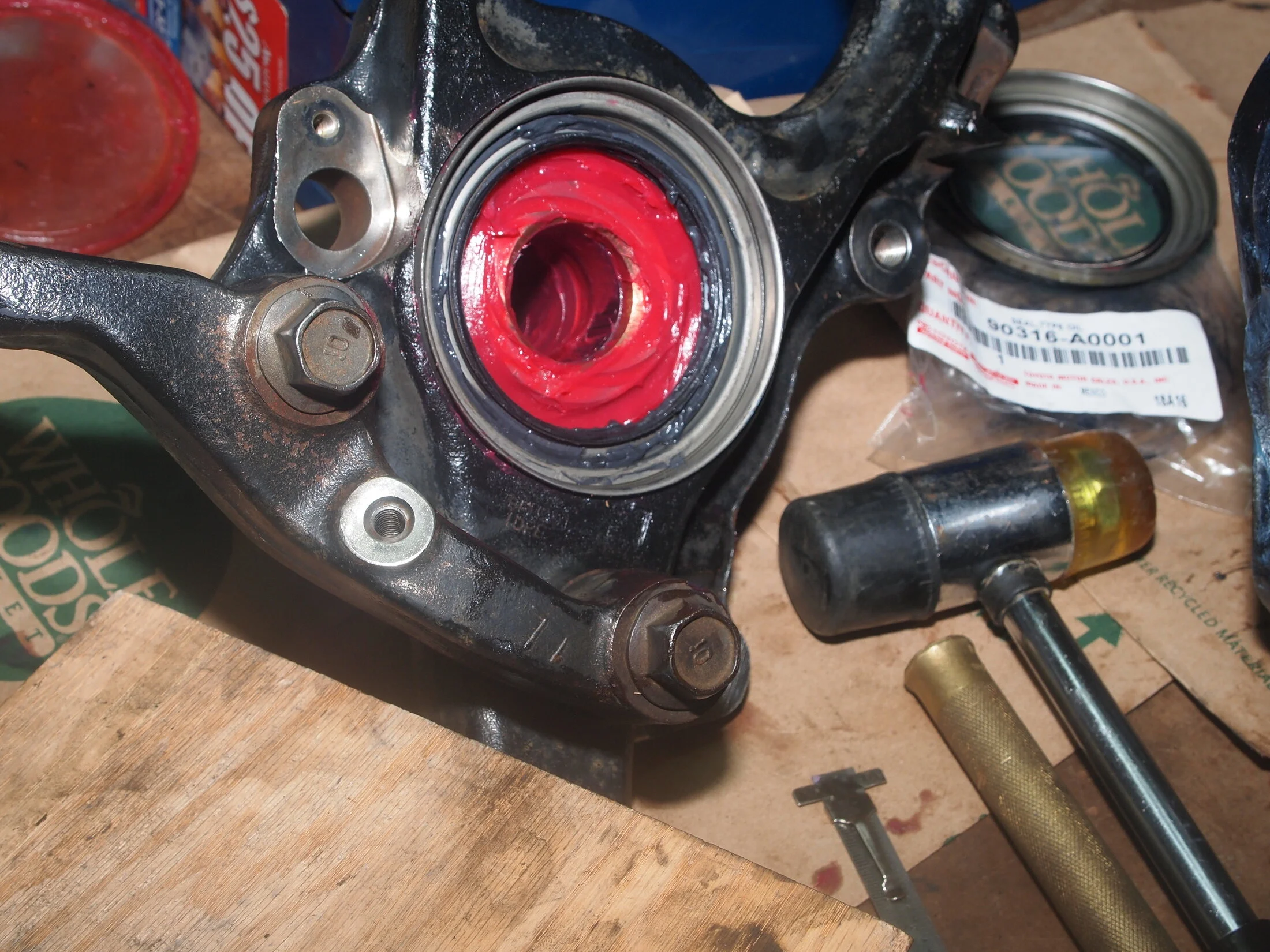

I also like to replace axle needle bearing and brass bushing. Which are in the knuckle. If I suspect past useful life. Old FDS axle scoring, where needle bearing rides, Is our best clue as to health of old needle bearing. The brass bushings thickness determine if it needs replacing. At minimum we must grease the needle bearing and brass bushing.
This axle needle bearing, is trashed.
Minor scoring on FDS axle from axle needle bearing. This bearing was bad, and made the very hardest to pin point rotational sound.
New needle bearing brass bushing and knuckle seal, installed a lubed ready for new FDS>
