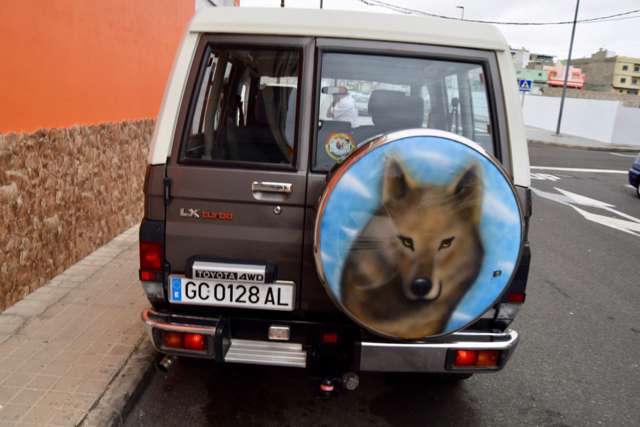

Personally I'd see if you can buy this tire cover separately and put it on whatever you buy. :)
I would be the primary driver with the wife driving on very rare occasion. She might be able to do RHD, but not manual. Would prefer manual but I'm flexible from that standpoint.
I never knew I needed that tire cover until I saw it haha.
