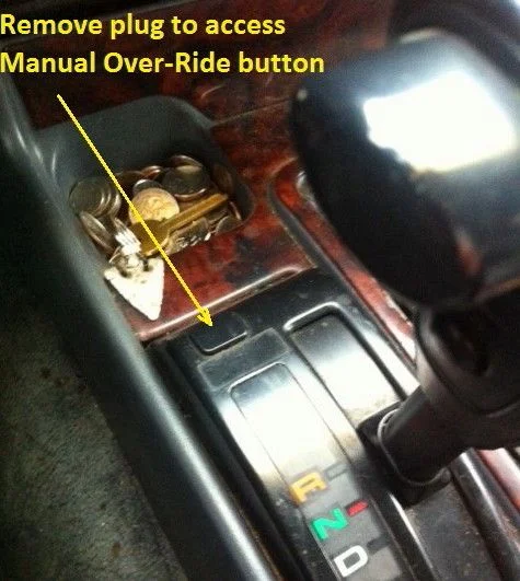

Above the shift lever there is a small cover you need to pop off, under that cover is a button you need to press. Use a screwdriver or something similar.
There should be a cap to pull off near the shifter. Take it off and put a pen of screwdriver down the hole then shift.

Had this happen to me late last night in a deserted parking lot in the snow. Jammed the shift to drive to make it home to discover the brake/turn signals also out. By luck, checked the fuses and they were blown. Replaced them and the shift depressed, but this afternoon started to lock out again (without blown fuses) so I used the pencil go-around trick. I will bird dog the steering column solenoid, any observations on this process are appreciated. Thks.
For future reference.
Thanks for the pics. Still bird dogging the overall issue as the fuses keep blowing...so a pencil it is!
