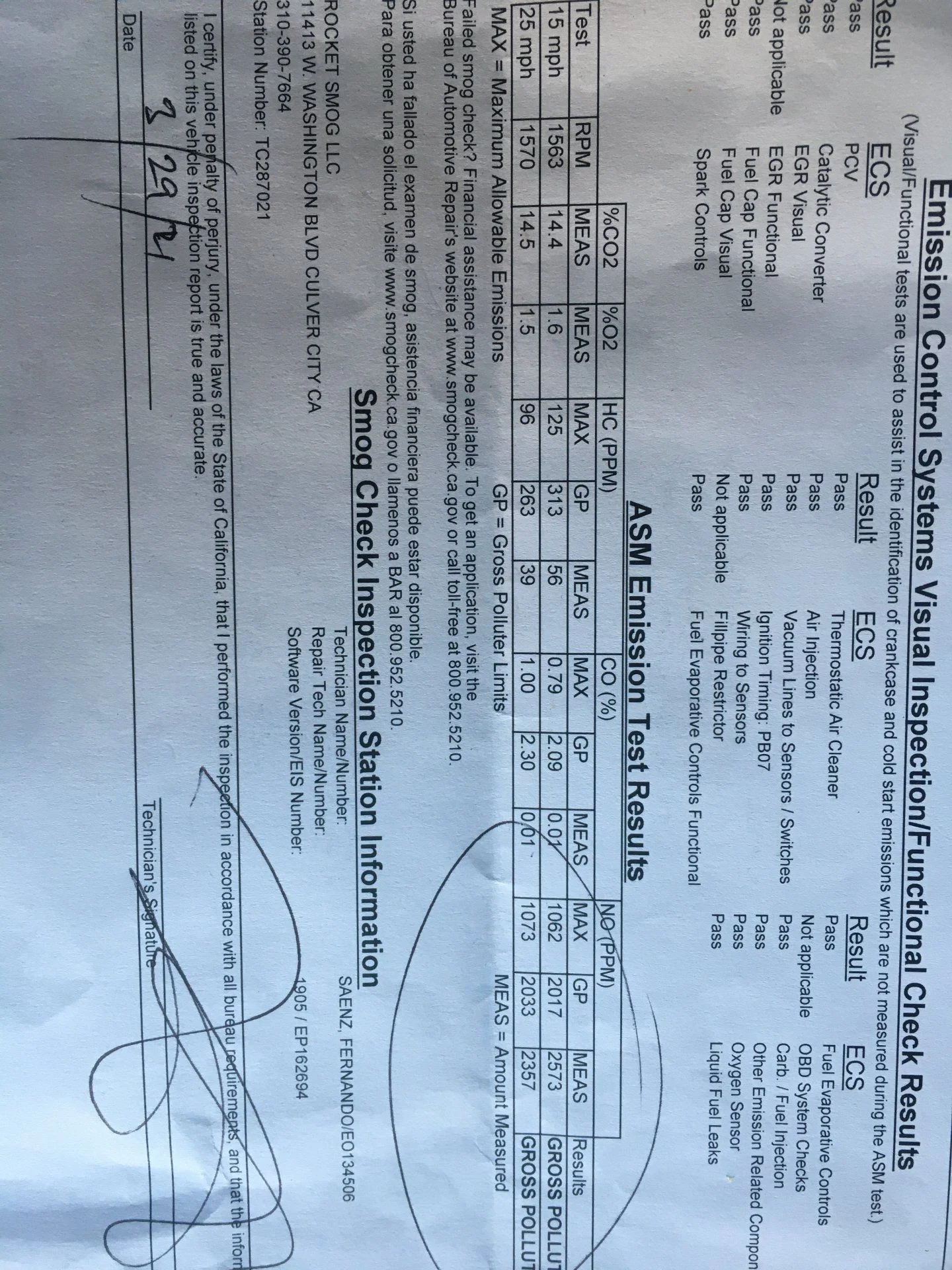

So I have been through and through with the emissions book and checking everything.
I did find a vacuum hose connected to the wrong port. Still can’t get the NOx down.
Input needed.!!
What am I missing?

Hey Frickre
Thank you for the reply. I have read your thread several times since I have been doing this.

He actually did Check the timing!
He told me the same thing after I tested. “What he would do”
