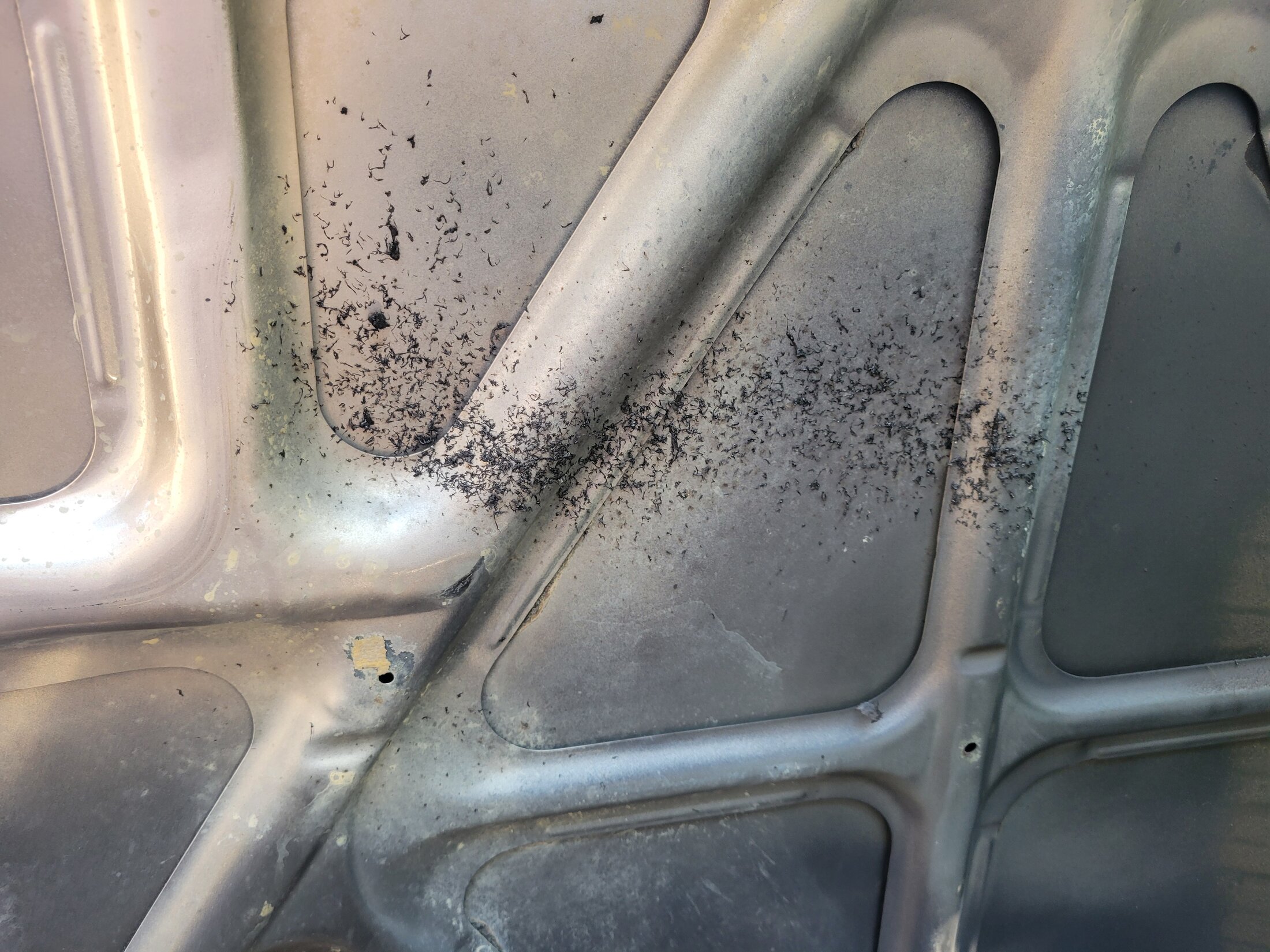

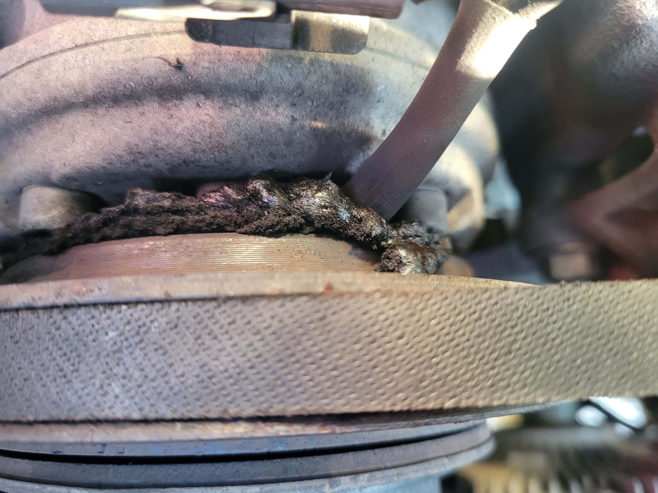

Well....this was exciting, driving on 295 north coming back from Quiton Virginia. Started to smell burning smell than instrument gauges started to bounce all over then gauges all died. Pumba hesitated for a moment, got off on exit for pole green road pulled into gas station. Found what looked like electrical wire splatter, smell was wonderful. Also found instrument cluster fuse blown. Unplugged connector at compressor clutch and replaced instrument cluster fuse. Everything seemed OK on the 40 minute ride home. It looks like clutch assembly can be replaced separately from compressor. Anyone done this?

Just buy the whole compressor. It has age to it also. If you get the clutch from Toyota it comes in many pieces and does not come with the compressor. fwiw
