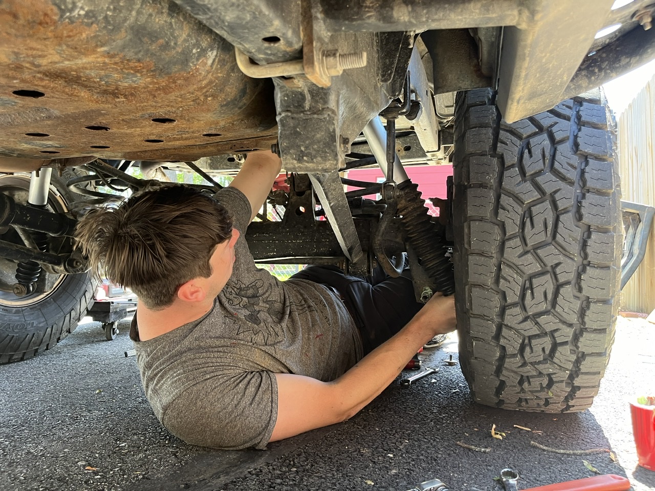

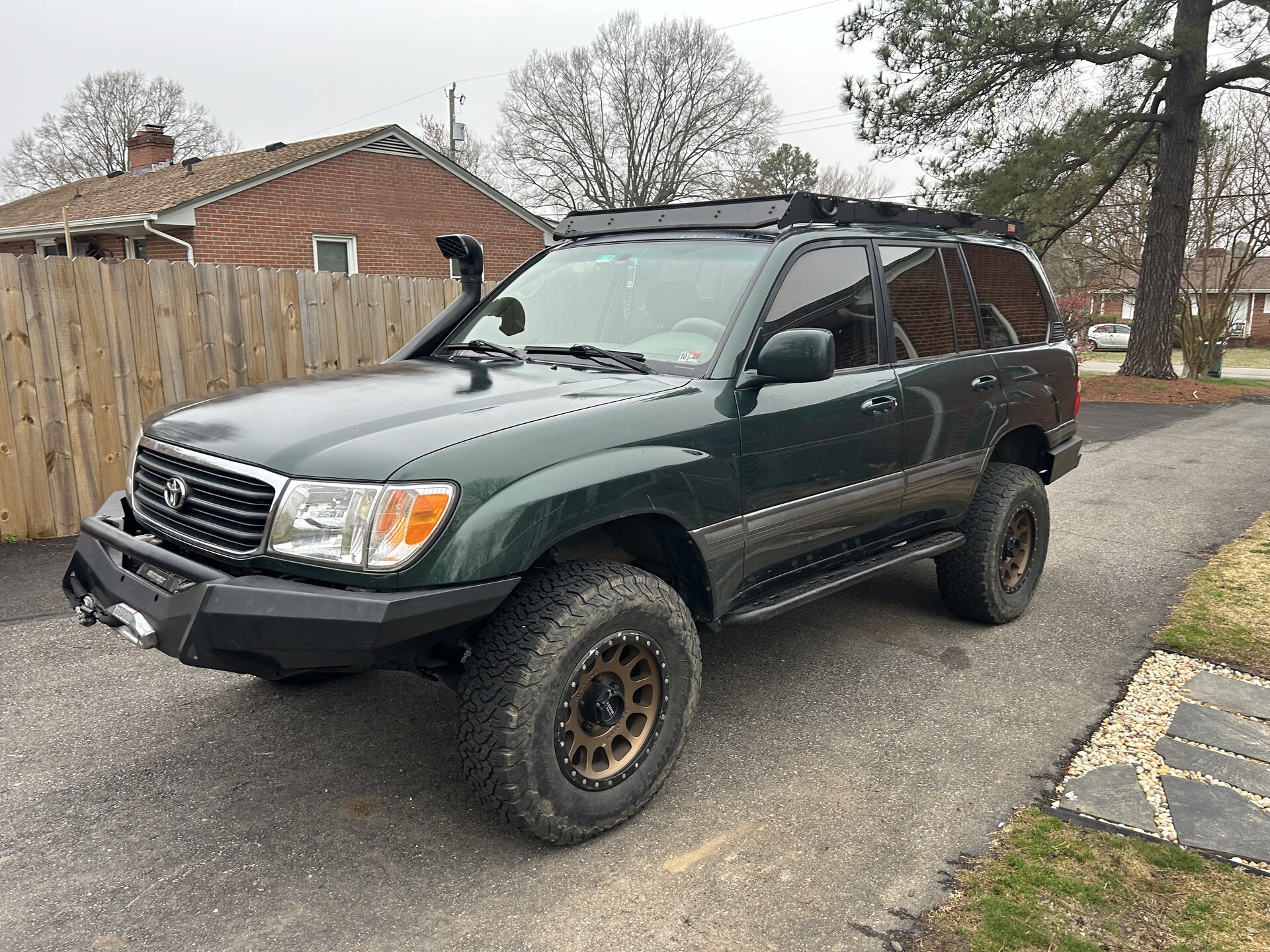

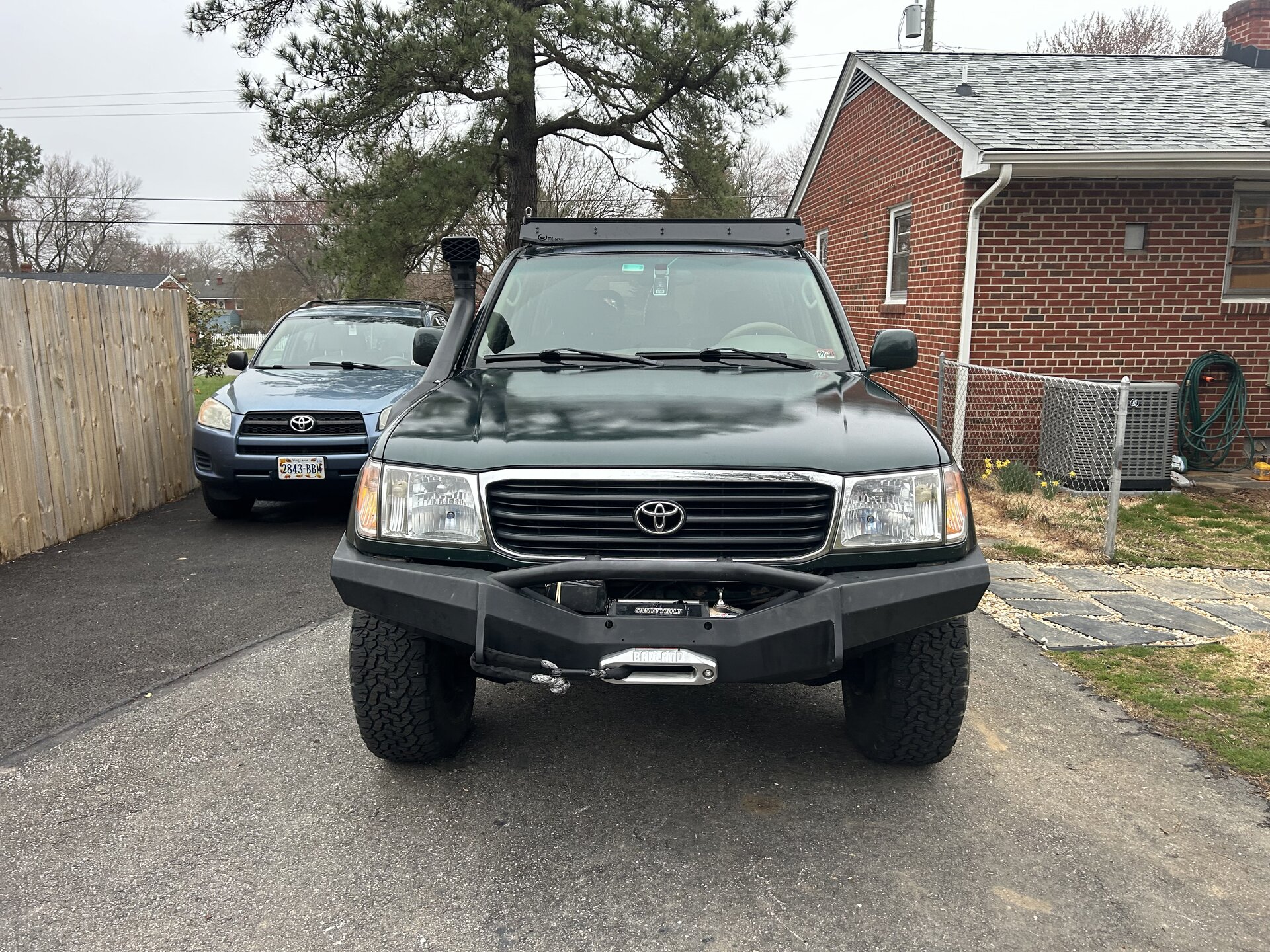

Too many small details to go into you all now how it goes but many hours later this project is almost fully wrapped up. Thanks so much @Land Shark for making it possible by upgrading your bumper and also for the help and good times spent Saturday in the beautiful weather. Really look forward to putting this to the test at relic run. Also went with new synthetic line to reduce the overall weight gain. Steering is a little heavier but the dobinson ims shocks are holding off the body roll.

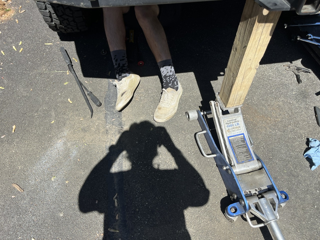

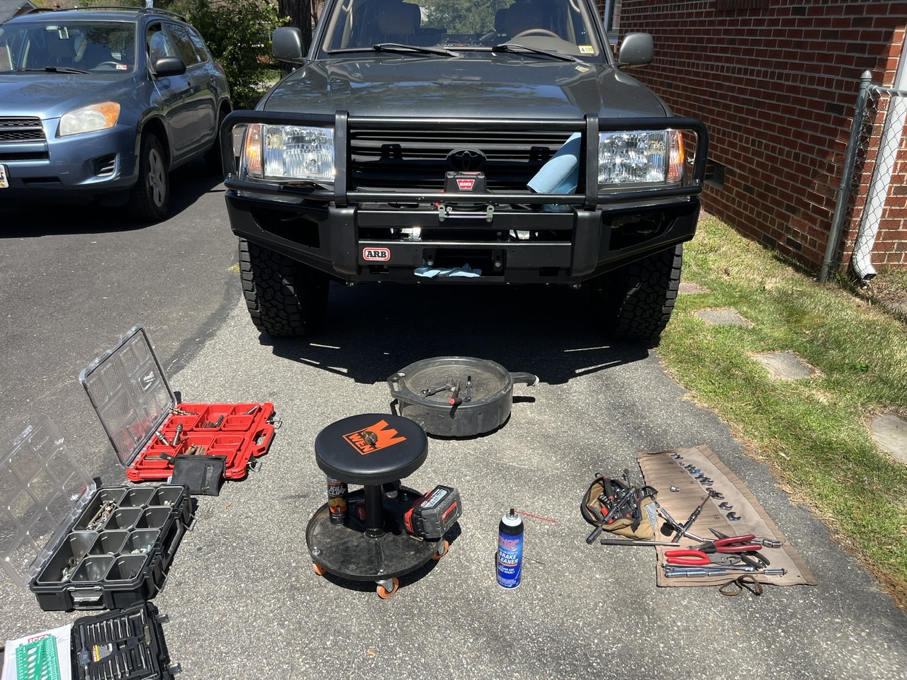

@Familycamper and I spend the day in the beautiful sun working on 100’s. Rear shocks for FC. Eimkeith PHCK for LS. Also got my winch wired with new rope spooled. Brats on the grill and Banquets shared. It was a good day. At some point there is a Wizard of Oz reference here
man, that bumper is purdy! I know I said I wouldn't be adding too much to mine but you got me thinking!
