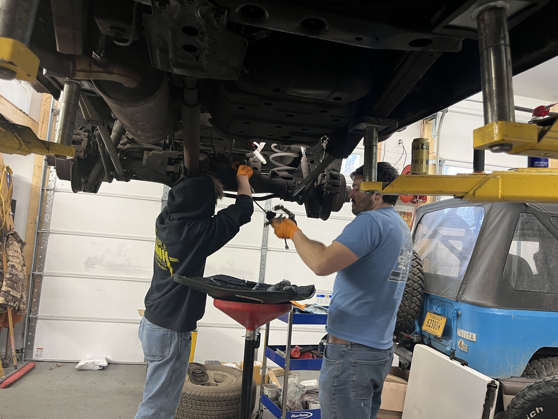

a few pics from Saturday. Nothing superfantastic just dudes in the garage

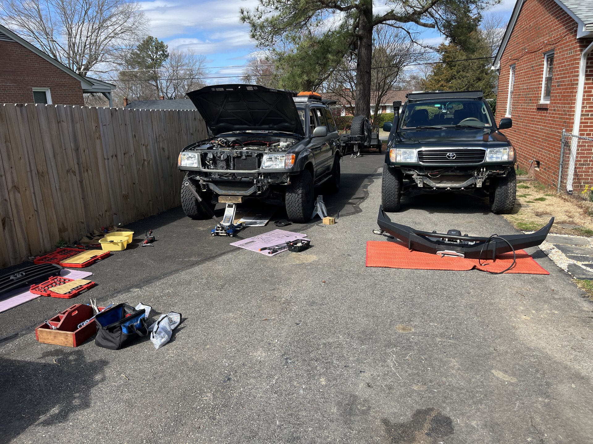

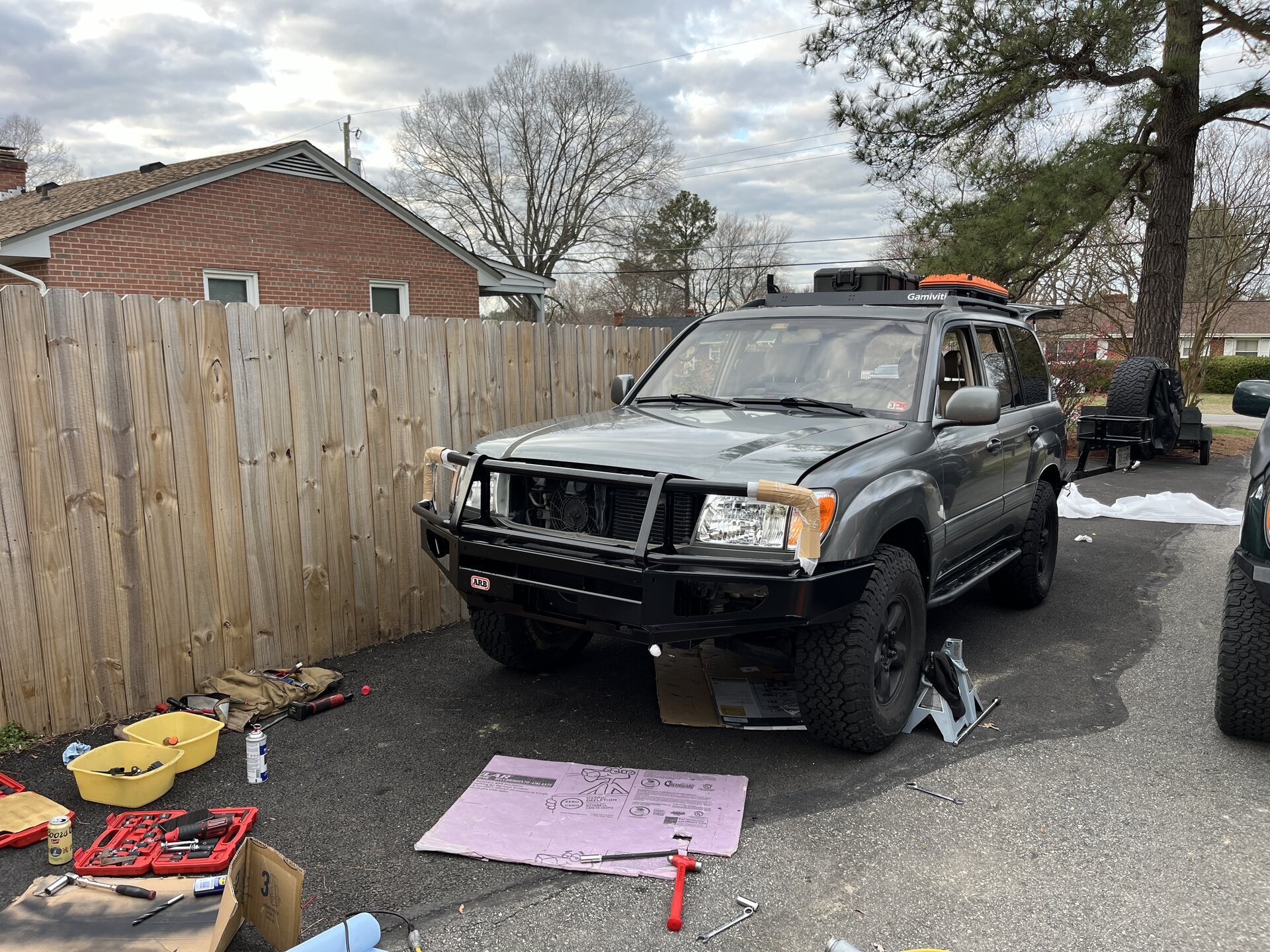

@FamilyCamper and I bit off a bit more than we should have yesterday. We tackled both front bumpers. My new ARB and his "new" @sleeoffroad. not quite finished with all of it but they are on and not going to fall off.
Charles will need to post up his installed pick as it was 2200hrs and dark so I did not get a shot of his. Lesson learned here. One bumper per day should be my limit ;)
This is not the finished product but it was close

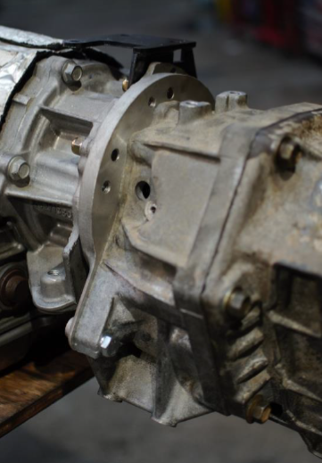

The question I have is what are my options / requirements in separating the transmission from the transfer case? It looks like in the FSM that you'd disconnect driveshafts and pull the t'case out with the transmission. I'll need to do some tinkering inside the t'case adapter housing for the torfab kit and it may make sense to have the whole t'case out at some point, but do I need to start that way? Is there a clean way to separate and pull the transmission from where it marries to the t'case adapter housing (35015-60070 Genuine Toyota Part - https://www.toyotapartsdeal.com/oem/toyota~adapter~sub~assy~transmission~case~rear~35015-60070.html).
End result of Tor kit (if some context helps -- GM on the L and Toyota on the R of the adapter plate):

You need a big cherry picker or a gantry crane. pull the engine-trans-tcase all out at once. you can leave the harness on them. It is heavy 1000#s or more. separtate the t-case off once you get it out. Use a floor jack under the t-case to lower that end and guide it forward and out the front end. You can pull the t-case by itself to save some weight but not worth it in my opinon.

Putting question a sort of different way: Can I detach t'case from transmission and leave it in place or can you just not cleanly pull them apart with the general upward pulling from the hoist?
You either have to take the case off before you pull it, or after. You can not really leave it in place as the tranny holds it and the crossmember goes under the tranny I believe. Nothing but hope and prayers after that to hold it in place.
I am not sure the engine hoist Edward has is big enough to lift everything you need to clear the front of the truck and/or the weight.
engine, tranny, t-case are a little over 1000# fully dressed.
