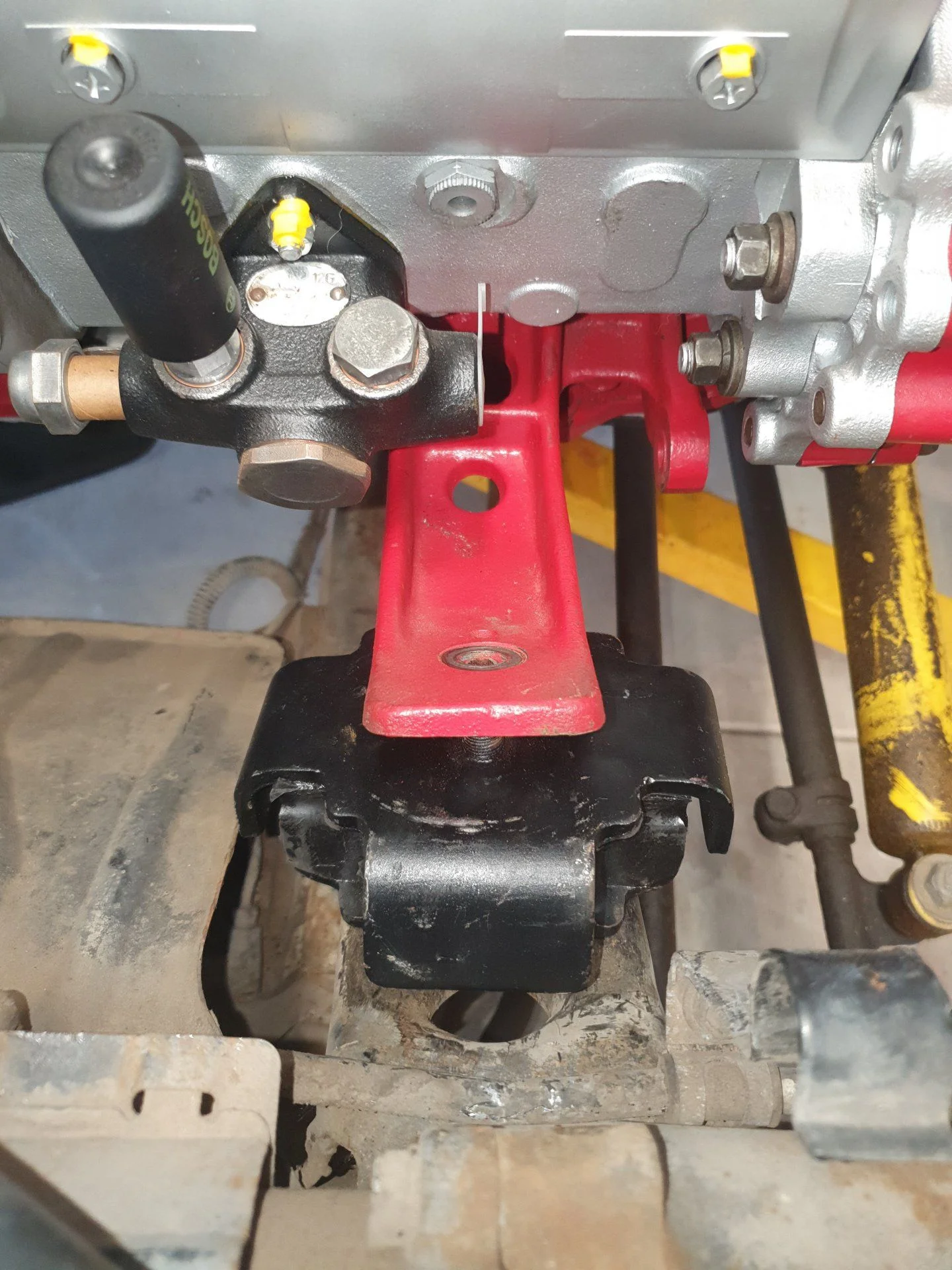

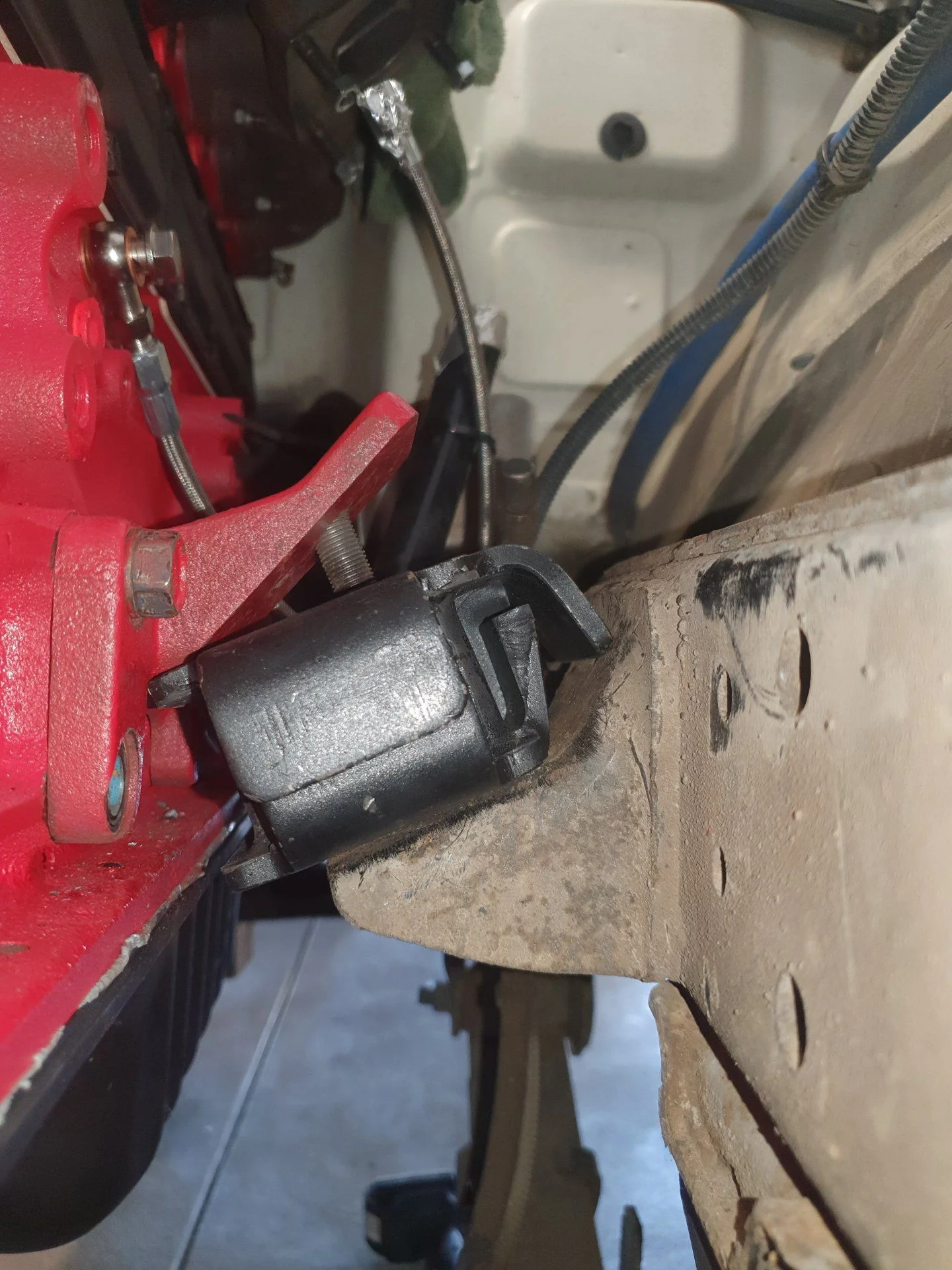

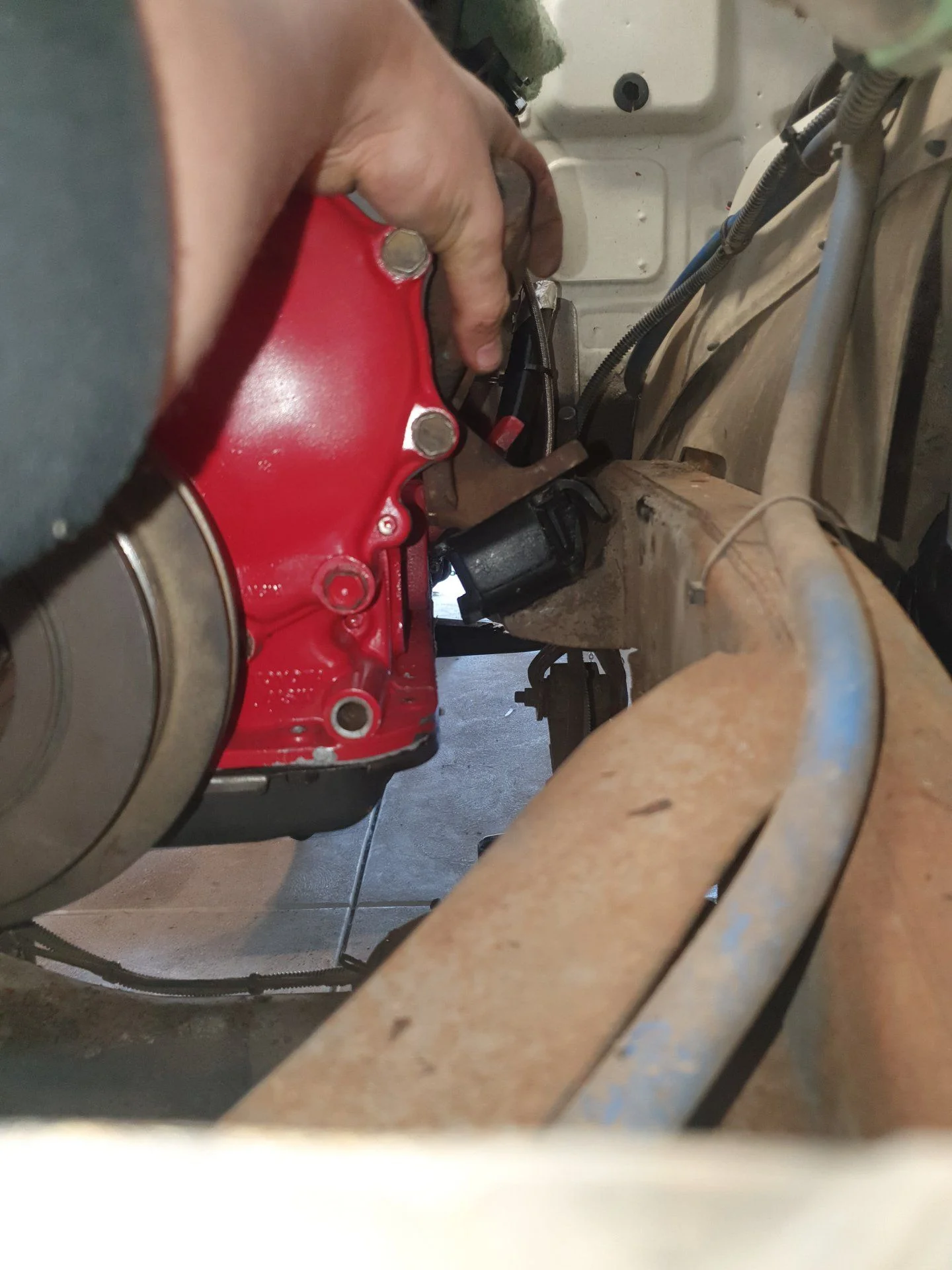

Currently in the process of planting my 12ht from an 1988 HJ61 into a 1988 HJ60 Chassis that had a 2H in it.
The mounts on the engine block are at a far steeper angle to the mounts located on the chassis. They line up okay, but when we tighten them down they stretch the rubber mounts out... the engine was also about 10 degrees off centre...
After a bit of looking around I found a post saying you have to change the RHS (drivers side - correct if wrong) with the old 2H RHS mount, the one with the power steering bracket attached.

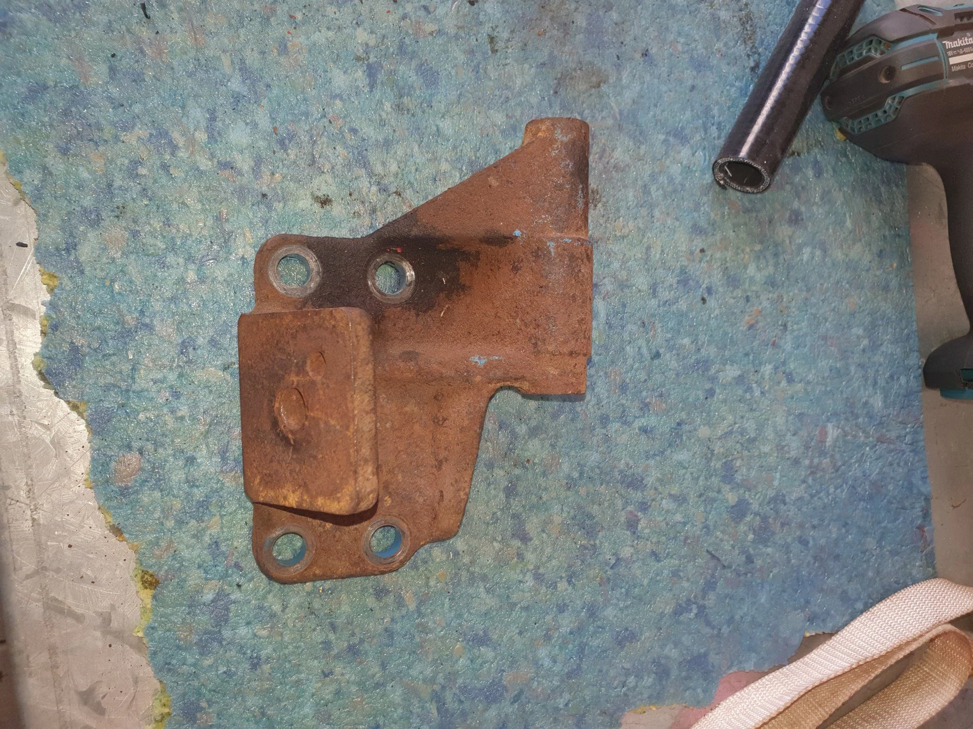

I found a wrecker who sold me one (No idea what they look like but i assumed he was right). The angle matched perfectly, however now it is no where near long enough to reach the chassis mount. It also doesnt solve my problem of the other mount still being at the wrong angle.
Ill post some pictures of what I am working with. Currently dont have the old motor (never did) and the old HJ61 chassis (recently got rid of it for space issues).
Anything in red is 12HT original, ill post the 2H mount I bought off the wrecker too.
Also, the gearbox cross member is correctly in place and loose, supporting the transmission but allowing some play while we move the engine.

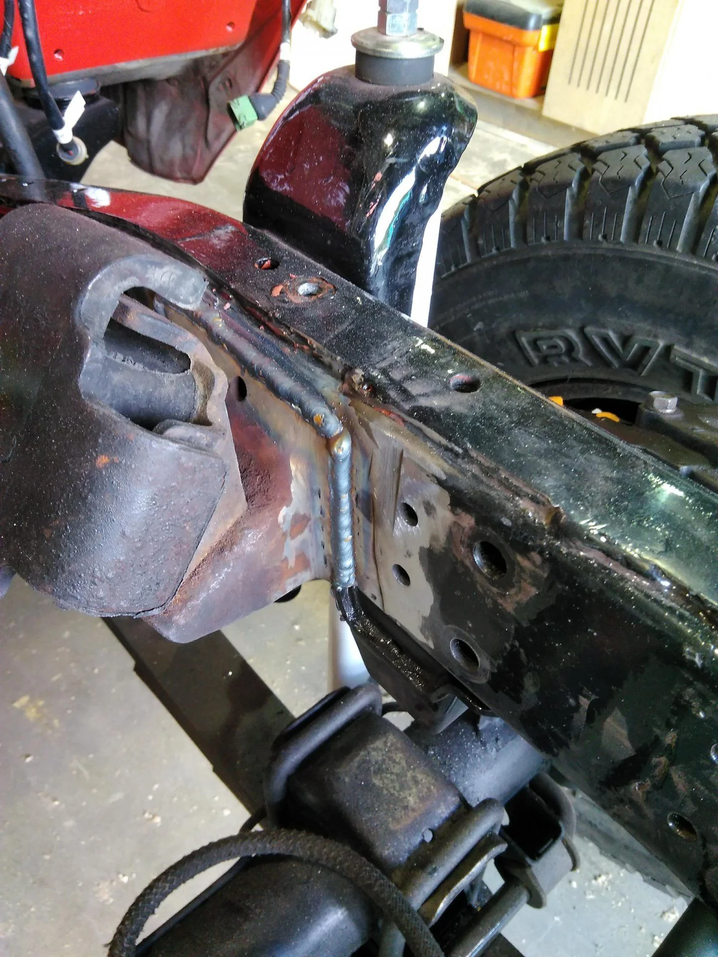

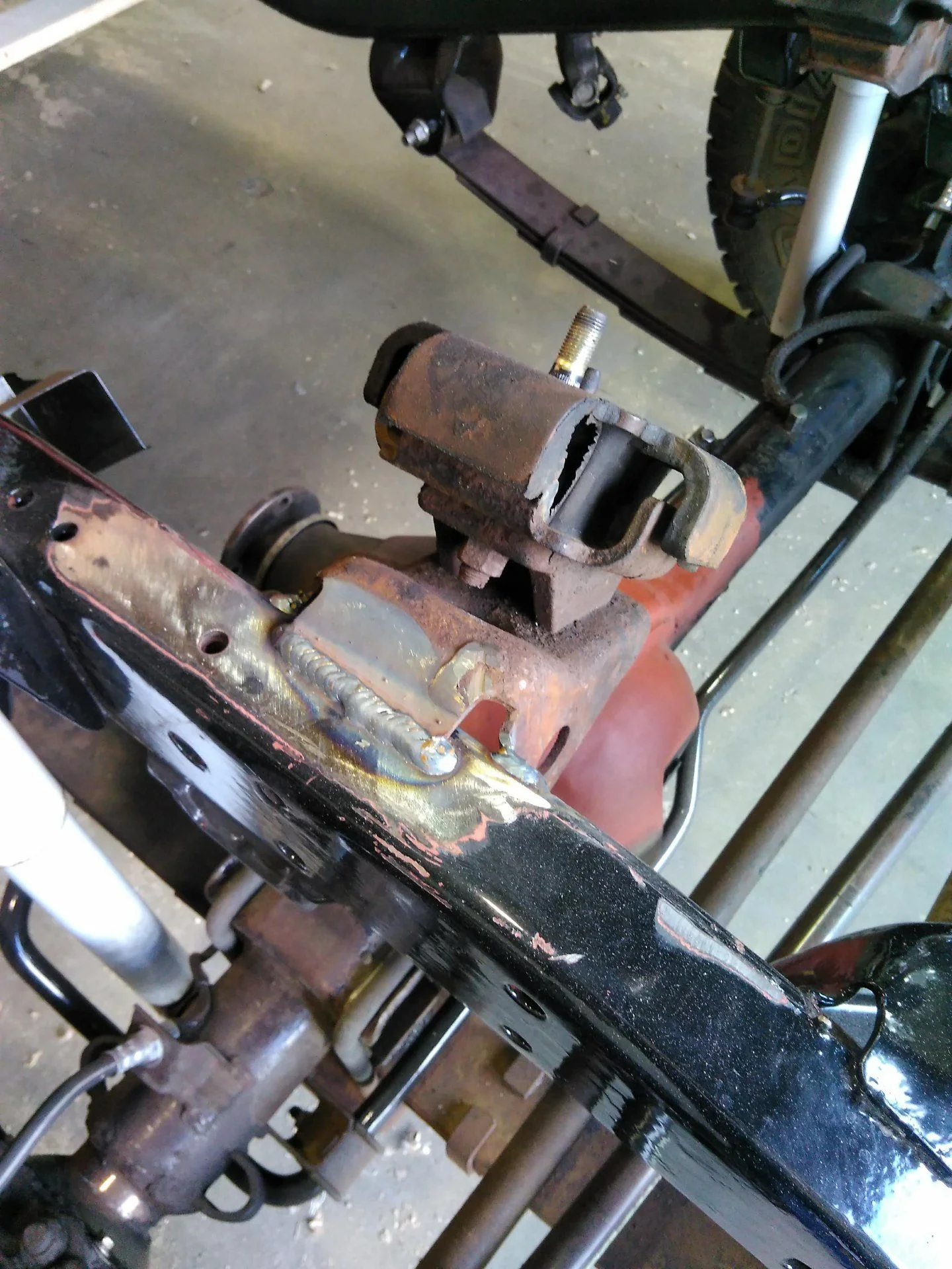

You're missing part of the 2H mounts. Here are some pictures of my 2H mounts that I welded into my FJ60 frame. You can see there are some spacers under the motor mounts to get you to the correct angle.
EDIT: Oh, and 10° off centre is correct. The 2H and 12HT do not sit parallel to centreline of the frame/truck.
Cheers georgebj60
