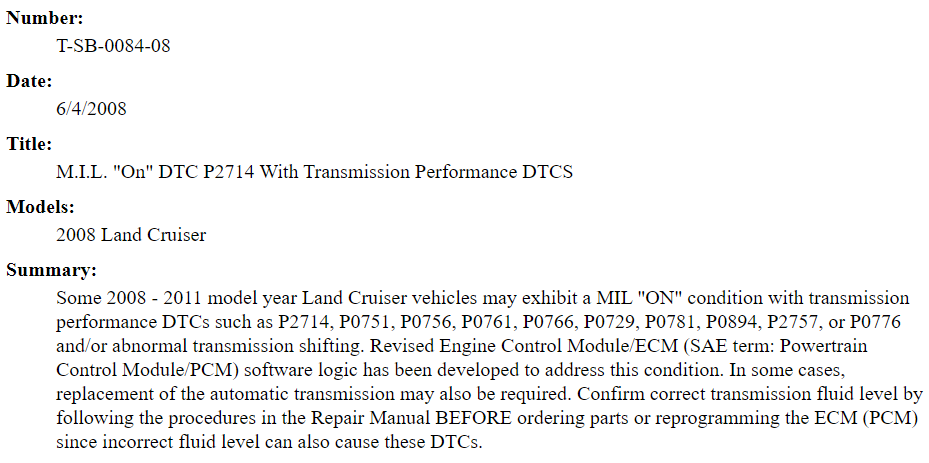

Well, it didn't go well. Took her to the local Toyota dealership today who took all day to do a complete diagnostic and test drive... they are recommending new transmission, ECU, and torque converter ($10K)! @linuxgod was right on the DTCs. Apparently, there is a TSB that says to replace the tranny for my model when these DTCs are shown, mainly due to ECU issues. See attached picture from paperwork.
What does everyone think? What would you do?
Your dealer is on to something, but they also aren't doing their complete due diligence. Why do I say that? "Suspecting an internal fault." Then proceeds to ring you up for an ECU which isn't part of the TSB. He also didn't state which ECU software version he found loaded (if he looked). Get another opinion. $10k for an educated guess is still $10k for a guess. Crap like this is why dealers are colloquially called "stealerships."
Furthermore, if you do end up needing a trans, I recommend you talk to an independent shop to see about having a salvage unit installed.
TSB text below for your reference if interested.
Your dealer is on to something, but they also aren't doing their complete due diligence. Why do I say that? "Suspecting an internal fault." Then proceeds to ring you up for an ECU which isn't part of the TSB. Get another opinion. $10k for an educated guess is still $10k for a guess.
Thanks for the TSB text. That is super helpful. I am skeptical of dealer service centers, and I noticed the "suspecting..." text too. Interesting about the fluid levels on the TSB... many on this thread had recommended that I baseline these. When I asked the dealership about doing this today, or to open the tranny up for visual inspection (for shavings or signs of damage) they said *IF* there is damage to the tranny and the shavings fall out with the fluid, then it could make the tranny and car inoperable. I didn't really understand this but I didn't want to continue the conversation with the service adviser. They did say the tranny quoted in the $10K quote was a reman transmission. Will definitely get more opinions for sure from independent shops.
