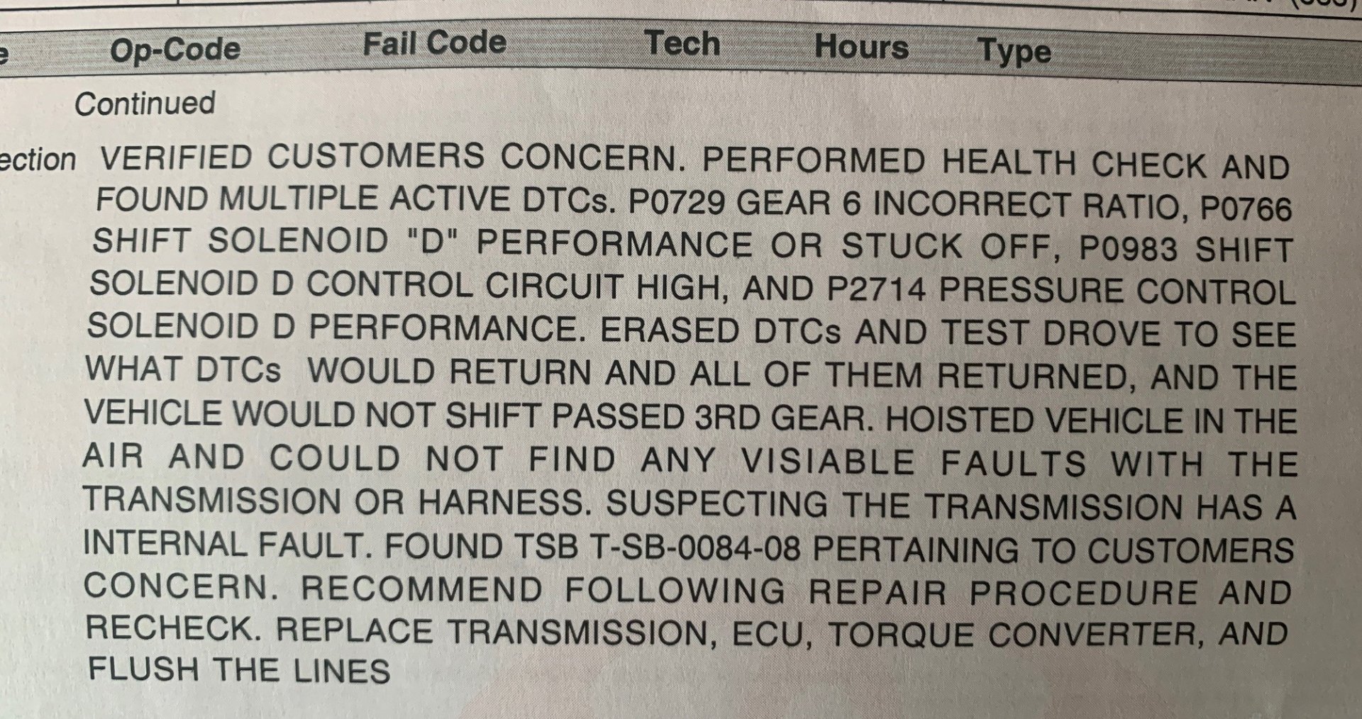

Well, it didn't go well. Took her to the local Toyota dealership today who took all day to do a complete diagnostic and test drive... they are recommending new transmission, ECU, and torque converter ($10K)! @linuxgod was right on the DTCs. Apparently, there is a TSB that says to replace the tranny for my model when these DTCs are shown, mainly due to ECU issues. See attached picture from paperwork.
<vent>I am beyond frustrated. I just purchased this car from a Lexus dealership last month for $40K. I already have about $3K in tires, mats, and Groom audio. This is the first time I have ever purchased a used car with this many miles, but I though "hey, it is a Land Cruiser, 136K is low" but just my luck. </vent>
Ok, vent over... what does everyone think? What would you do?

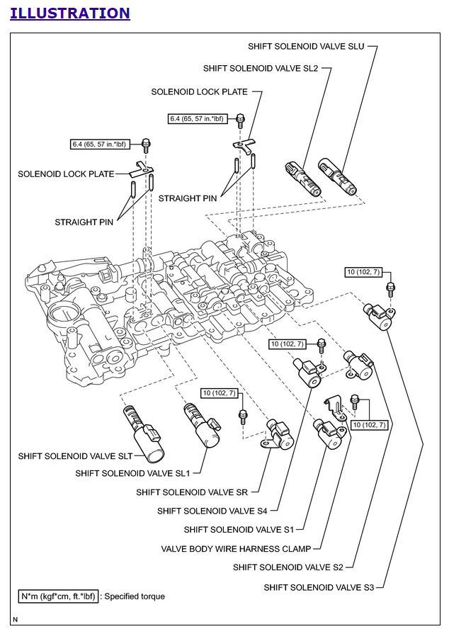

BTW the valve body is largely made up of various solenoids, which is what most of the original error codes were detecting as failed. It was probably faster for the mechanic to just swap the whole valve body instead of removing and testing each solenoid (and then trying to locate the exact part required), but I'd bet only one or maybe two of them were actually bad.
