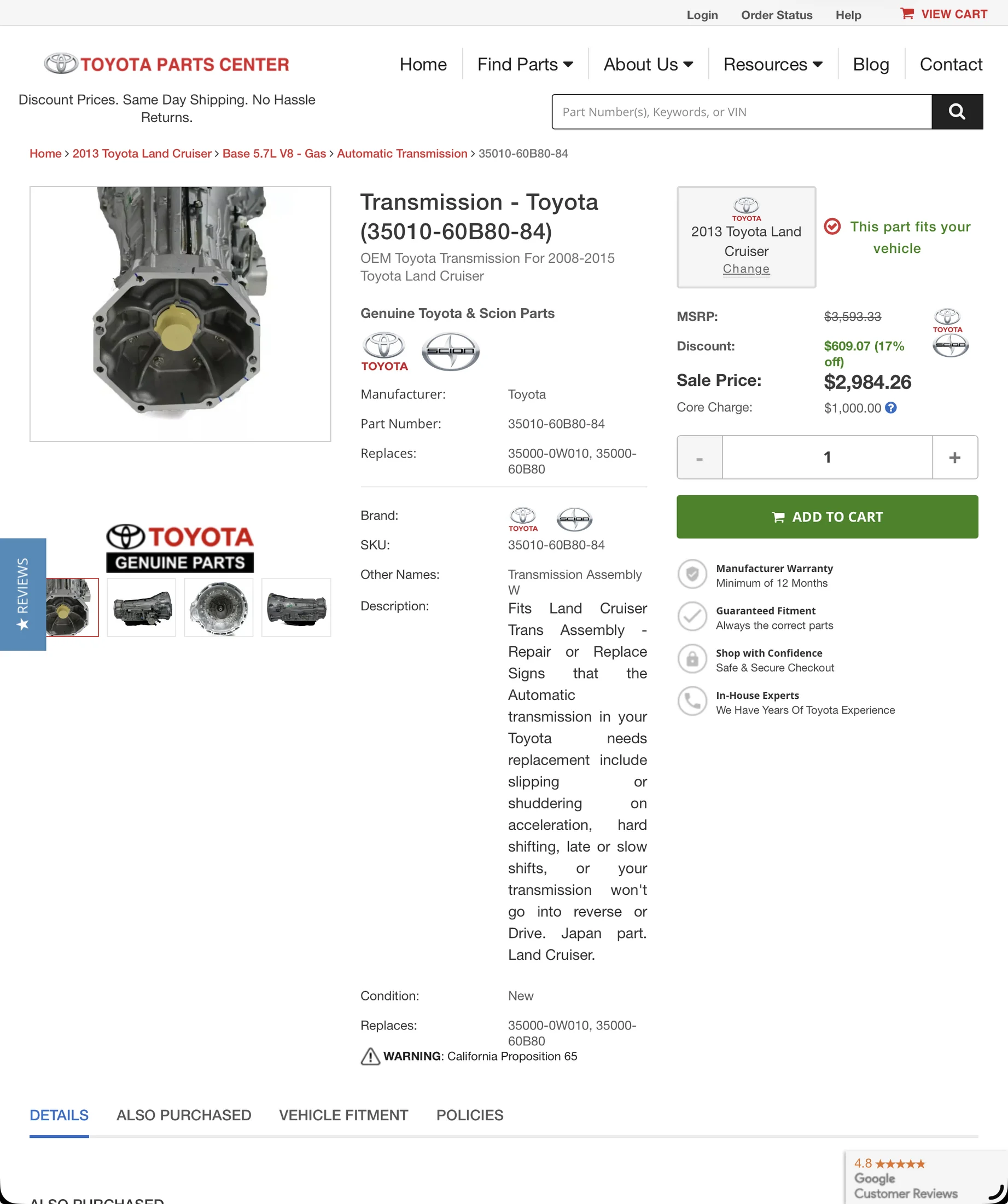

What’s the cost of a reman? I assume you’d also do a torque converter?
I lost 2nd gear engine braking and 6th gear engagement this week. The FSM says B2 brake or valve body.
@linuxgod , I believe I paid $3,500 after core return a couple years ago. Found this today:
I’m not CERTAIN, but I remember the last time I priced one it was a little less than $4k. Under 100k I don’t think a torque converter is necessary if you’re maybe on a bit of a budget, but at your mileage it may be worth it.
